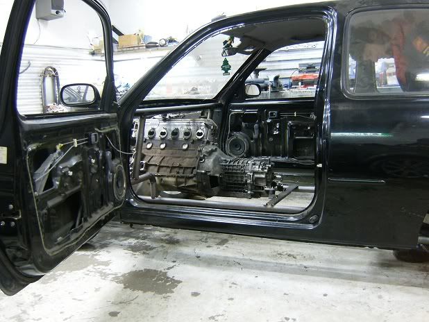

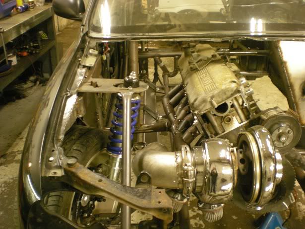

im building a nissan at the moment.
i dont have time right now to write som much of it, i will post som pictreues and you can ask me and i will try to answer.
sorry for my english, it isnt really good...
the engine i will be using this first year is a bmw 3.5L 12valve , probbobly around maximum 650-700hp 900-1000nm. topspeed is planned 300+ km/h ofcourse...
next year if i dont crasch tha car and kill myself i am thinking to uppgrade to a 3.8 24valve instead. but for now my ecoomy dont allow me.
tha car is planned to be ready to drive in july.september this year, but i will have to se how much money i can spend every month. im buliding it from my own money and no sponsors whatsoever today sadly.

hi, glad to se so many responds over one night :)
i have always wanted a bmw z3 with turbo, (but i dont have the money for that),
i have a few friends that drives bmw 535 turbo, (but they cant do fast laps on track bacouse of the high weight..)
i got this engine almost free for 3-4 years ago but havent got any use of it..
a firend of me is machanik for a man that have around 10 used f1 cars for renting to rich people doing trackdays in Hungary, i will be able to get used f1 tires on 13" rims... (that is the reason for choosing golf GTI brakes in the front)
so traction shouldnt be a problem, in fact i have also bought a vipec injection that will help me use a form simple tractioncontrol...
i am doing al of the work myself.

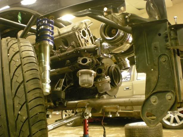

the reason for buidling the exhasutmainfold this way is becouse it will work fine, this engine is only able to handle maximum 6700 rpm and 1.5 bar boost, more revs or boost will make rockerarms (dont know if it is the right word) brake and/or make the rods bend.
i will be driving it on ethanol/gasoline mixture (e85) it is 104 octane and mixture ratio 9.9:1 so the pistons will probobly not be a probleme..
i have been tuning a few almost identic engine before with Link engine management, ant the same turbo (holset hx55) and the same kind of maindfold, they have produced arond 700 hp 1000nm.
if the power shouldnt be enough the 24v 3.8 engine will fit in the same gearbox and enginge mounts, there is a few of those engines ruunnning with turbo here where i live, and they all delivver over 1000hp at the backwheels. this engine ui am using now is only temporary, it is not a "reel" race engine, but will deliver much tourq for very low cost
i dont know the engine weight, but i HOPE the car complete will be around 900 kilo, it is pretty much , but all the wight is very close to the grond and the engine is completly behind the front wheels so the wight balance in the car shold anyway be much better than if i hade used a fwd v6 engine or something like that...
the reason for using 2 wg is that it was a sale at the lokal speedshop, so 2 40m valves was the same price as one 60mm, as simple as that, and it also loooks much cooler right :)
the main problem today to get the car running before summer (we have almost 0.5 meter of snow that probobly wont disapear for a few months)
is that i cant get out the money i need to buy all parts, like fueldelivery, clutch , real racingseats/belts and so on..
but i promise to do all i can to make it happen... one other "problem" is the time, i have a normal job 7-16 every day, and family to. me girlfriend is pregnatnt and we have our 3d children in march...
today i plan to go to my work and build a 4" stainless muffler so i can finisch the exhaust during the next week.

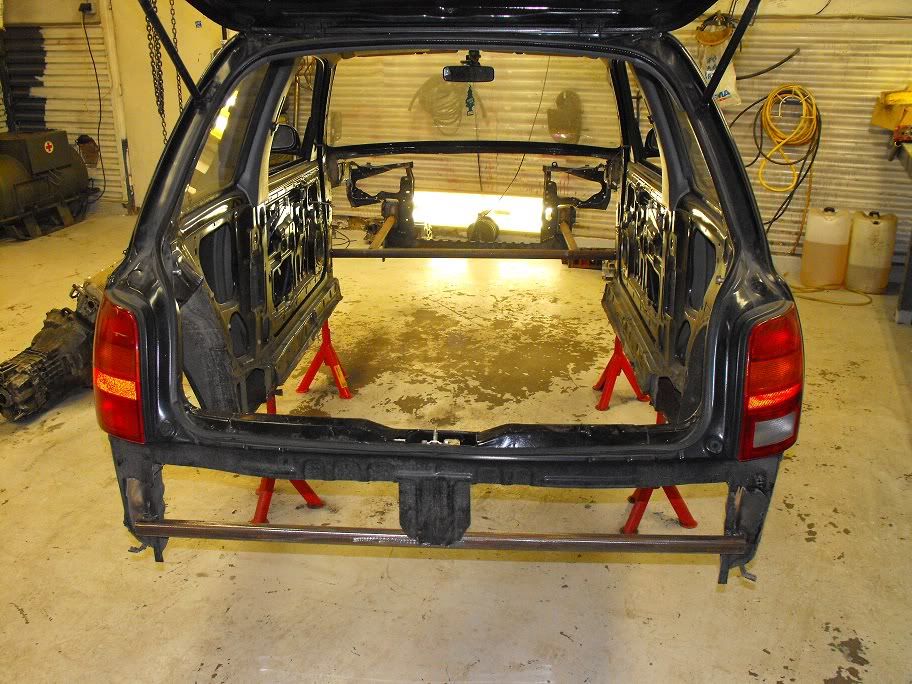

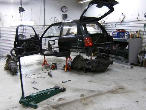

i can agree that it is not so much left of the micra bodey. but this was the best way of doing it, i will need a stabil chassie to handle the power , and safte is also important, the plan is to have a micra that looks completly stock from the outside but will be able to reach a topspeed over 300km/h.
i will do a new interior ín black, use the orginal plastic as much as possible..

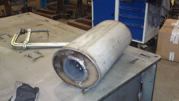

i will show you a small sideproject from today /friday night
starting with a stainles 100x5mm pipe, to thick to drill so many holes in, had to make it to a aprox 96x2mm pipe.
drill alot of holes.
fill up with some stainless steel "turnings" (dont know if its the right word)
my friend that was suppose to help me , found something much more important to do, (drinking beer)
thats how i do it,i would have saved a few hours buying a ready one, but whats the fun in that, and i also saves something like 100$ for something else.

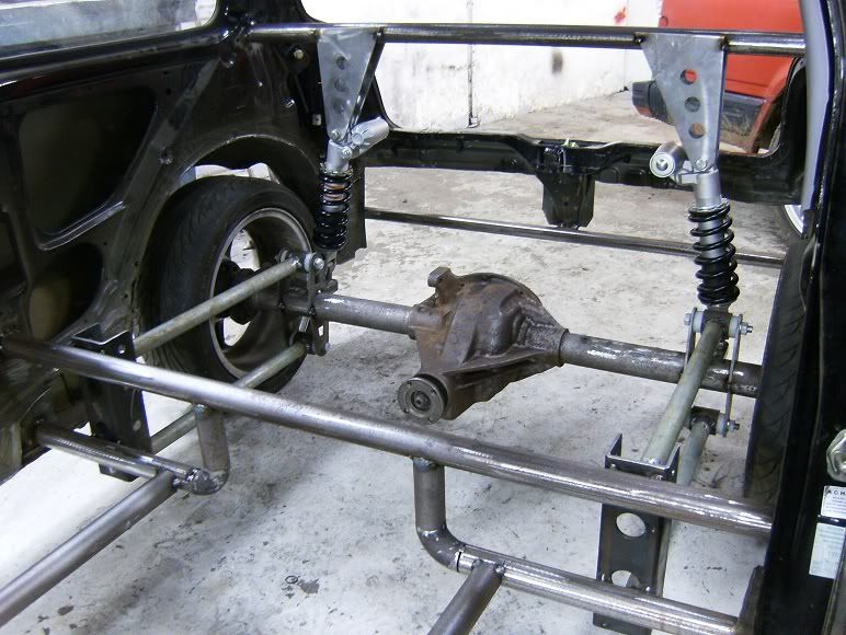

panhard is not fitted now, i will have to buld the frame for the watercooler in the back first.

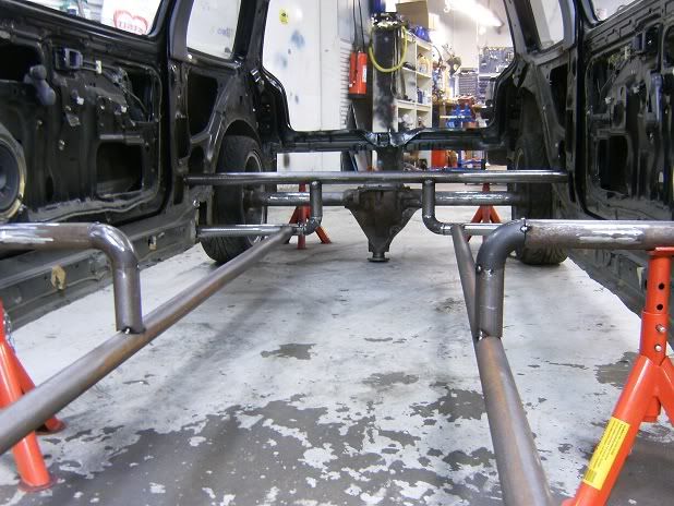

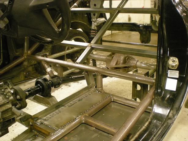

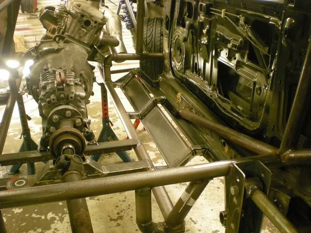

LowMicra WROTE:
"what will you do with the chassis? will it be a strengthened frame??<BR>was the bmw engine the first choice of engine?<BR>
the chassi is built using swedish racing rules.
the pipes etc used are regulated by swedish Racing Regulations.
not becouse i need it for driving it, but only to be sure they arem strong enough.
pipes for rollcage wischbones 4link etc.
42.2mmx3mm thicknes,seamless for chassies and rollcage.
28mm x3 for wishbones and 4 link.
boltsizes are all a little bigger than rules esys.
m16 for 4 link, m12 for wisdbones
(the rules says for dragracing cars m10 for wishbones and m14 for 4link, 25mmx3mm pipes)
pipe for seatsbelts is the only that are a little more 42x4mm seamless.
there is a few more pipes to weld in before it is rady, but it is almost ready in the pictures...
i use this engine becouse i had it allready, i got it from a friend a few years ago very cheap, but havent got any use for it earlyer.

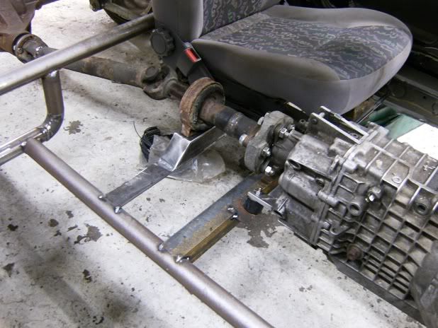

clutch has finally arived, used nascar QM 7.25" with chevy 10 spline, it is the same splines as BMW getrag gearbox,!! perfect

also the fualtank is we¨lded in aluminium, i will post pictrees of that too...

panhard fitted to the rearaxle.
crankshaft, rods and pistons fitted, unfortenly the camshaft was wornout so i am lookling for a better one,
frame in the back fitted to support the coolers, a little more sheetmettal/"mud flaps" will be fitted to protect coolers from wheels. and to strenghten the rear fram since panhard and future antirollbar will be bolted in that frame.
the fuelcell is testmounted, only need to weld brackets for mounting , fittings to fuelpumps and pipe from fuel cap

today i was to the scrapyard to get some spareparts to one of my dailydrivers.
and when i got there i found a crasched micra superS
ofcourse i took of the mudflaps and spoiler for the tunk cover. i have actually never seen one of these cars in sweden before so i gues it must be imported from germany or something. perfect for me... :)
i also got a few things back from my friend that works at the cromefactory...
i must get my impreza ready for the spring now this week, change brakes and wheels and get some touching up with the paintwork that has been ruined by the roadsalt during the winter :(
but in the weekend hopefully i can get something done with the micra again
