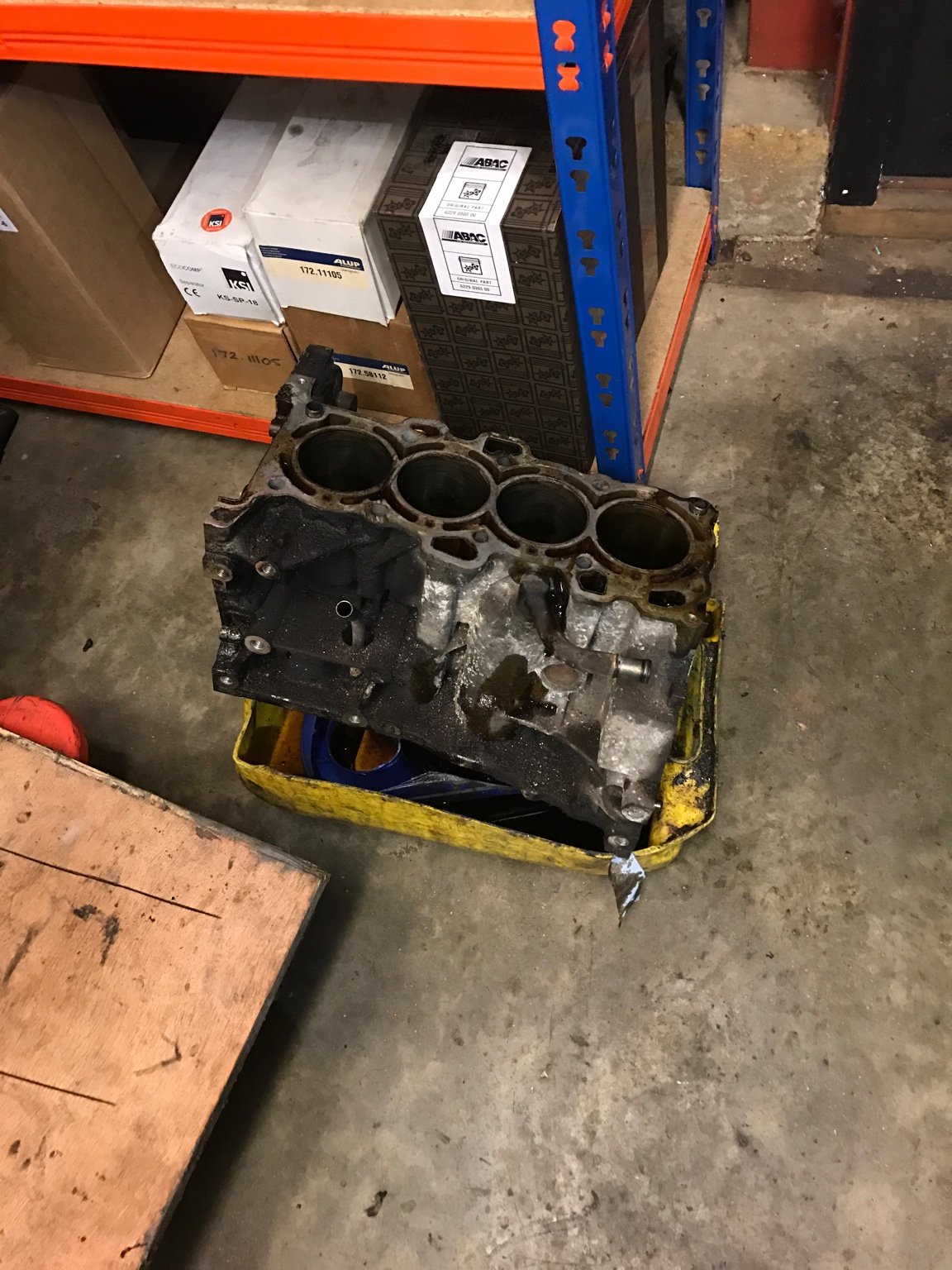

So picked up a auto block 1.3 today, along with these....

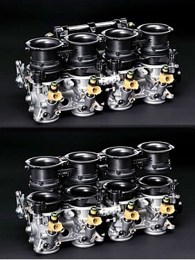

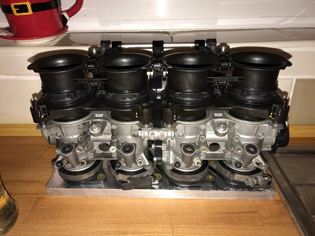

I've also picked these up, 2008 Yamaha yzf r6 throttle bodies.......
Which change the inlet runner lengths at certain rpm's (yet to figure out when/ how to do this)
Like this.....

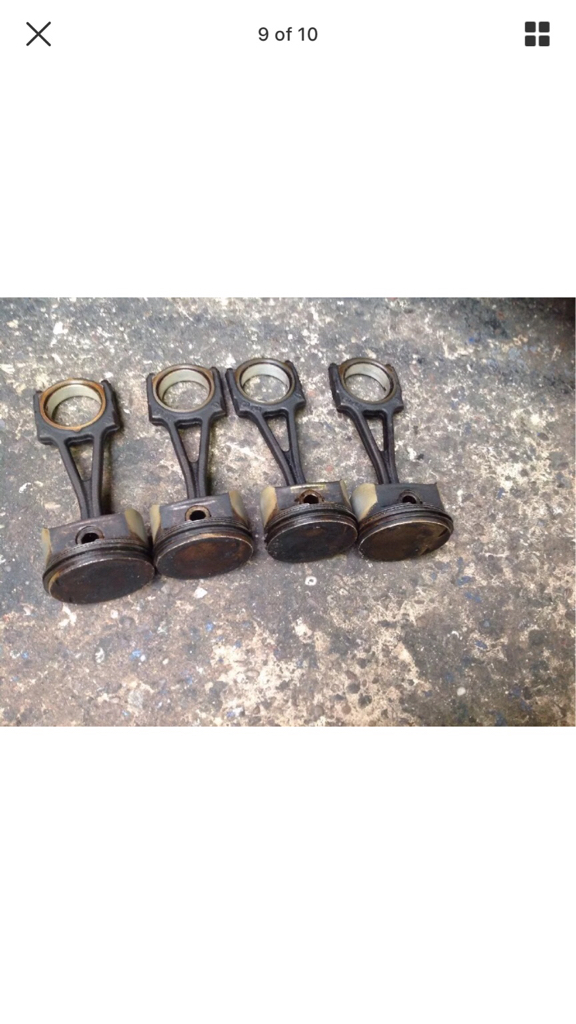

From what I know so far from searches on this site , to use the corsa pistons you need to bore the cylinders to 72.5 mm, and take 3mm of the top of the block

i used cga3 blocks personally mate, they are 1mm bigger bore, the liners will be pretty thin on a cg block at 72.5mm
I've managed to get the auto version, which is closed deck.....which should be stronger?

Australia never got the CGA, if you were building a n/a into the CG13DE block would you be better off raising compression using CG10DE pistons?
Is the increase in displacement worth the thinner bores? (just wondering, I've no opinion on it yet, except I'd choose reliability over performance if it came to it).

The reason for these itb's, is that they are variable length, long at low revs, then short at high revs
Should make for a better torque across all rpm.....from what I can make of it anyway.
Pretty hard to achieve that with a plenum and big TB
(Unless I modified one of those 'bunch of bananas' type manifold, but they are mostly plastic, and bulky)

There's a chap on here l_jonez, who's running a cg13 with corsa piston in his mini, says it's been reliably thrashed about for few years now.

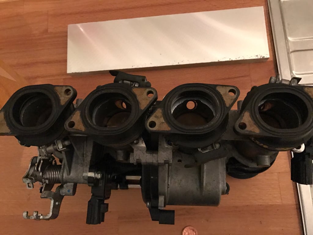

Just received the manifold rubbers, they taper down to an oval like the cut down cg mani....if the spacing was right, I could jist weld this aluminium bar to it, job done

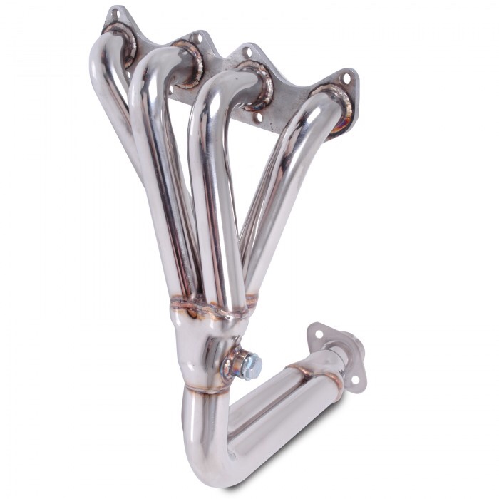

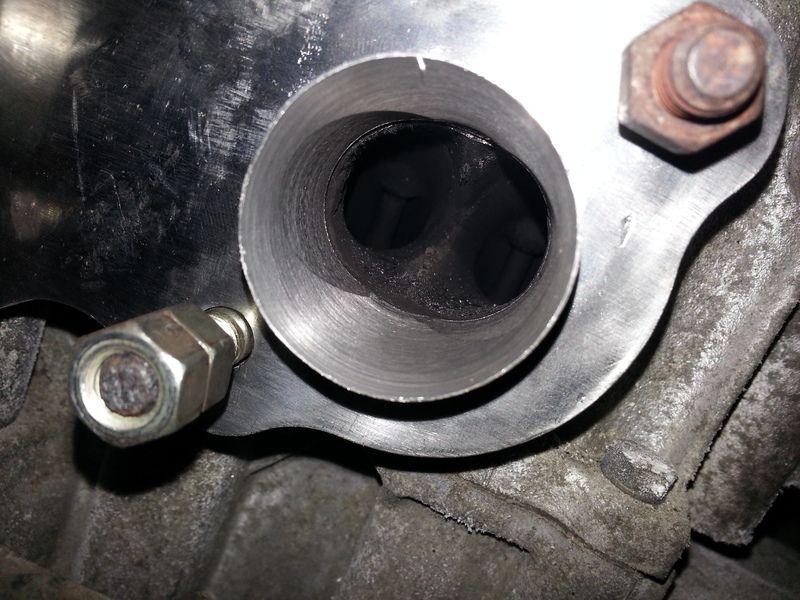

Has anyone actually fitted the peugeot/Saxo exhaust
Is theee much tweeking to be done, or is it a simple case of weld on a new flange
Sent from my iPhone using Tapatalk
you,re best to ask him tbh mate, and check it was an 8v one, iirc he changed the flange too
i would have cut the 4 runners about 1" from the flange i think, and fettled/reset them

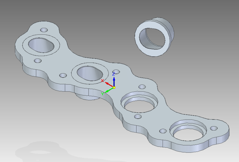

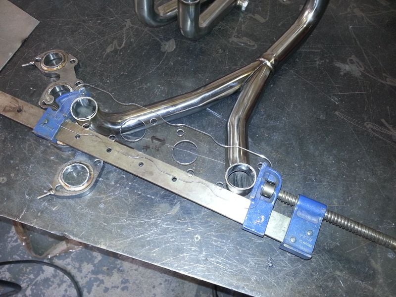

I did a Peugeot 206 one for my Mini engine conversion.
It wasn't easy!
I CAD modeled a flange and transition bungs to change the oval port to round.
Cut the old flange off.
Cut a slot at both Y junctions and bent the branches until they fitted over the bungs.
A lot of tacking, checking and then welding. My new flange was like a banana when I had finished so I had to straighten it on the press.
A VW Polo one is also a contender. I used the 206 one as I scored it on eBay for a decent price.
My TIG welding has fairly improved by doing this. Still could do with improvement.

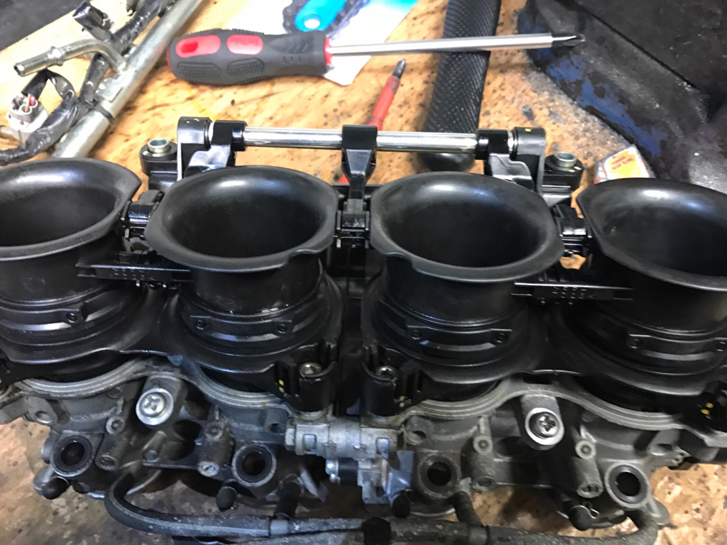

Matt's K1100 throttle bodies which youve probably seen before.
Slowly, stuck in a mates garage, and i live miles away and only work on it from time to time, should get back on it in the warmer months

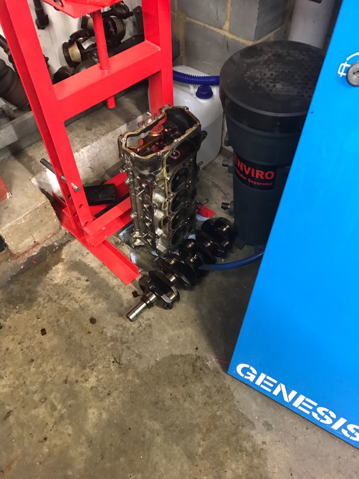

Engine all stripped

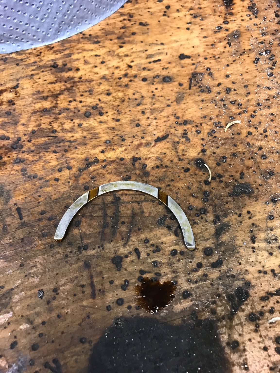

was carful to take note where everything went.......apart from this little bugger!! Where's it go
Was in between the crank and pistons when in found it
Only found one!
Better get searching
