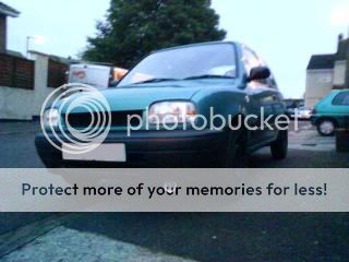

sorry to bring up this thread, but could i possibly see some pics of how people have routed their cold air feeds? (showing route through engine bay too please?)
so far mine's like this.. only place the piping would fit :/
oh and i dont fancy cutting up my bumper.. ideally, i'd have it behind/in the front grill or bumper grill
cheers :)
gathered lol Shame I havent Got A K11 Otherwise I Would Give You The Answer Now! Well I Have My K10 CAI Through My bumper And Double Meshed It To Stop Crap Going In To The Standard AirPan,
