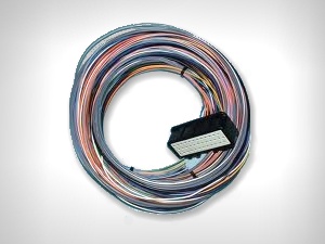

A fair bit yes, as you would need to splice into all required power, hardware and sensors on the car. i.e. +12v direct supply, ignition supply and grounds, fuel injectors, fuel pump, ignition coil outputs, tacho output, crank sensor, MAF sensor and coolant temperature sensor.
