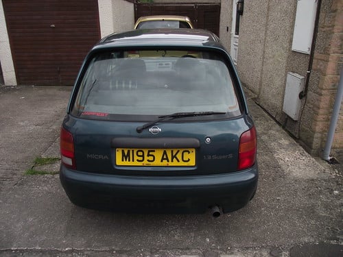

Charlie
Ok so most of you know the history between me and Charlie :) but no matter how hard I try (and in all honesty I'm not trying all that hard) to get rid of her and move on to bigger things, she just won't go
So here she is in here current state :)
Not going to go in to detail of any plans purely because if something happens I'll post it here :)

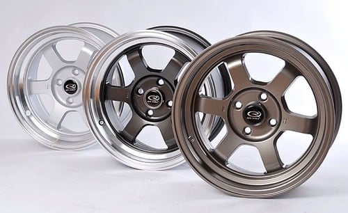

Well to carry on another thread I started I think I've found a set of wheels, I know I said no to Rota's but I keep having dirty thoughts about a set of bronze Grid V's
It's such a shame that everyone rolls on Rota's

Well I've been doing some maths and on a 7" wide wheel the rears need an offset of +ve 20 and the fronts +ve 30 to keep them flush with the body work, which puts the Rota's out of contention

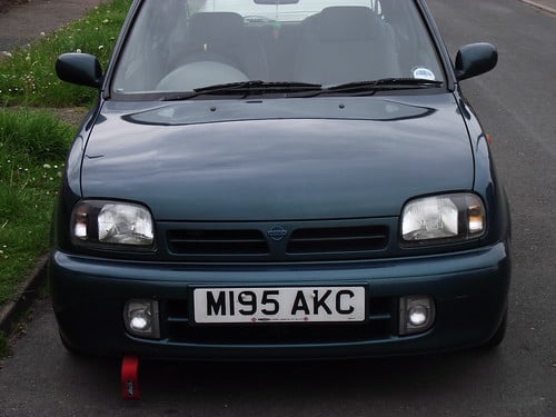

Decided to temp fate with a couple of stickers..... I know I said to Will and Guy that I wasn't going to but we all make mistakes lol

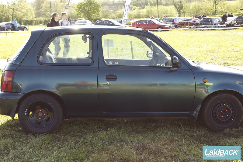

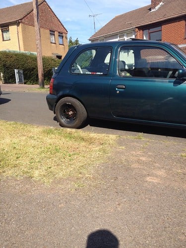

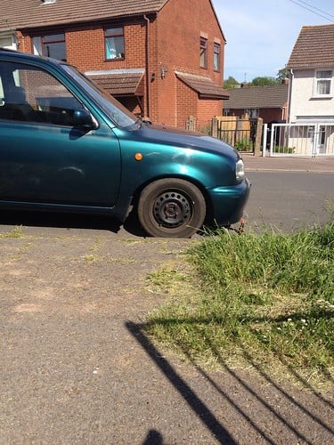

Did some work on Saturday only just got some pictures
Front sitting quite nicely now
Rear needs to come down a little but that'll be a job for next weekend

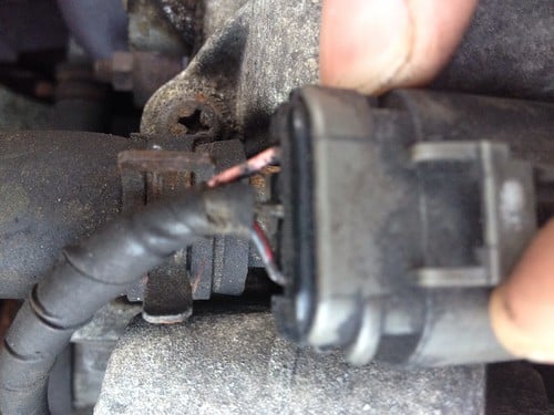

1 long wire from the gauge to the middle black wire (i should have soldered it to the engine loom on the other side of the plug, rather than the short loom connected to the lambda tbh)
Cheers Frank
These are the signal wires on mine (I've got another two but they're irrelevant for the moment)
I know what each wire does red=live, black=earth and blue=signal
But I haven't got a clue which wire does what for the actual lambda
Pink (with silver dot), white, red and black striped
Also if anyone knows where the wires go to, to the ecu it'd be much appreciated
So the not so white looking one, think I'll go with my idea of lengthening the wire rather than hunting for the right one in the cabin

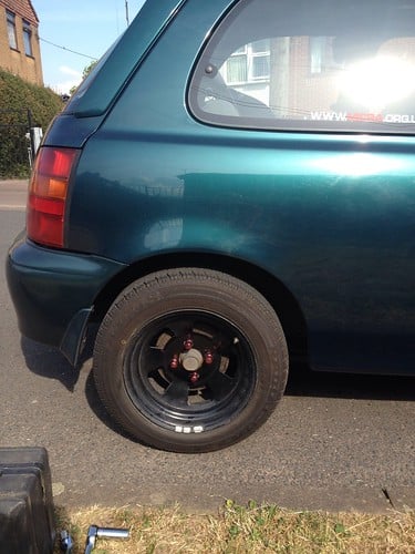

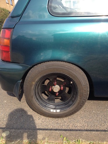

So after swapping to corsa b rear struts they keep topping out so to solve the problem I broke out the electric height adjuster :)
Before:
After:
Nah only joking that's without any springs :) only took a third of a coil off each spring so not really noticeable, may end up taking a little more off before the end of the week
