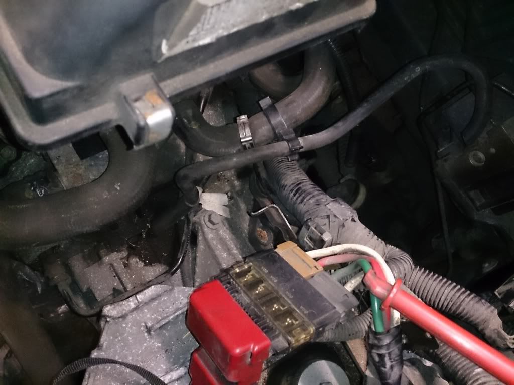

can anyone tell me where this pipe from the gear box goes?
