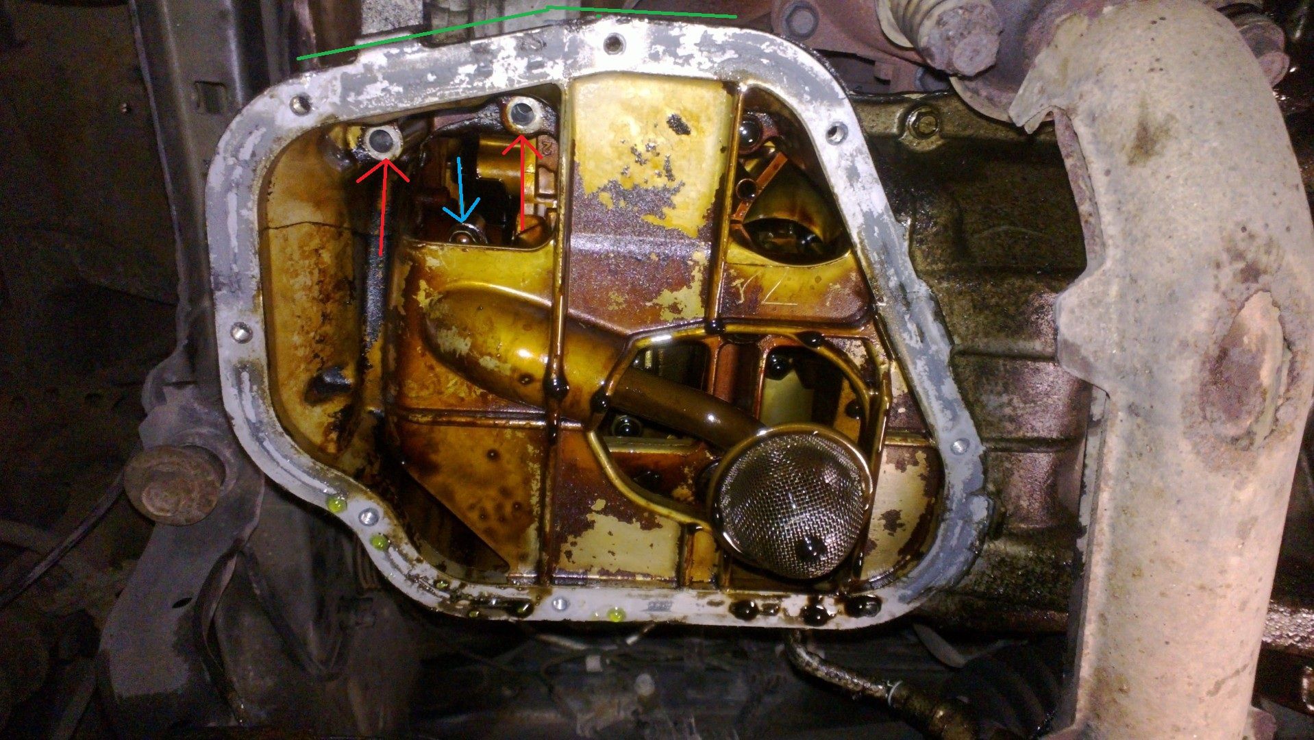

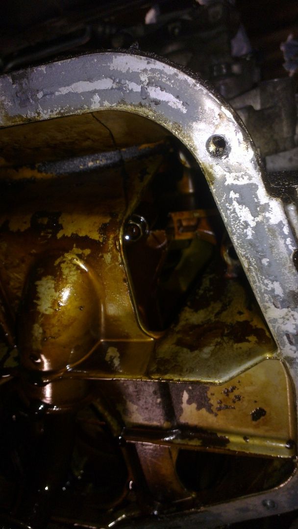

here is a photo looking directly up into the engine with the sump panel removed.
the two red are bolts which we have removed as we believe these hold the timing chain cover on.
the green line is where the timing chain cover is
the blue bolt is the bolt we cant get to but and unsure if we need to remove this or not?
rest of the pics

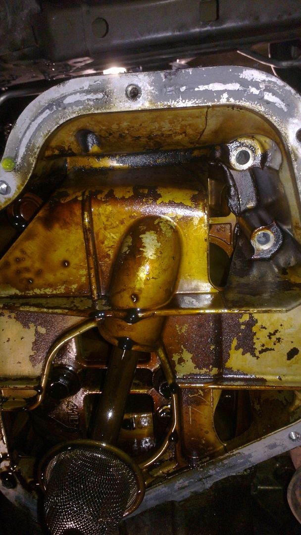

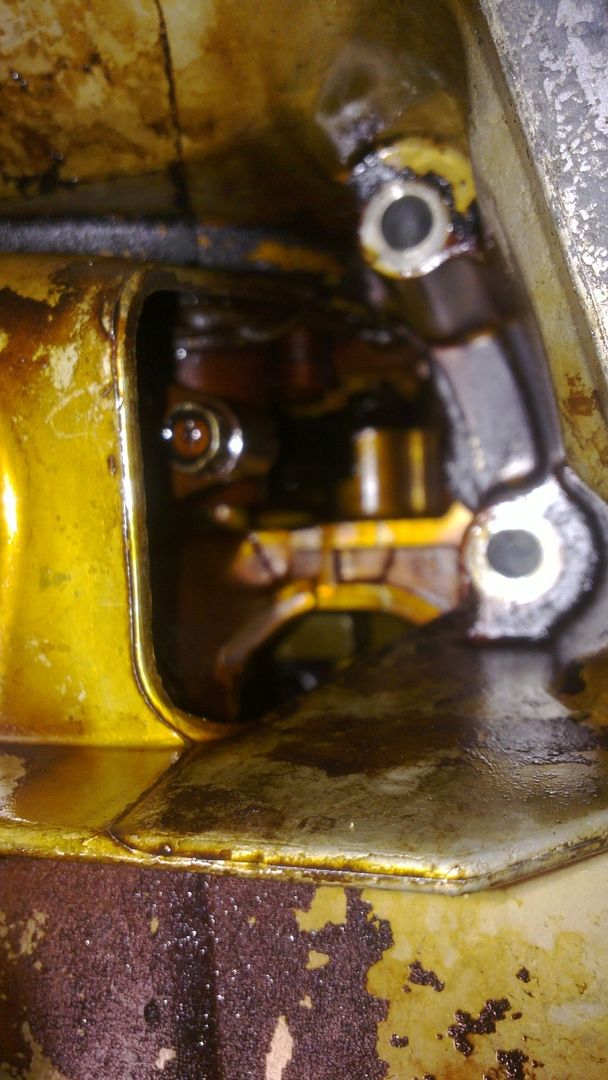

a photo of the bolt which is blocked by metal
bolt again

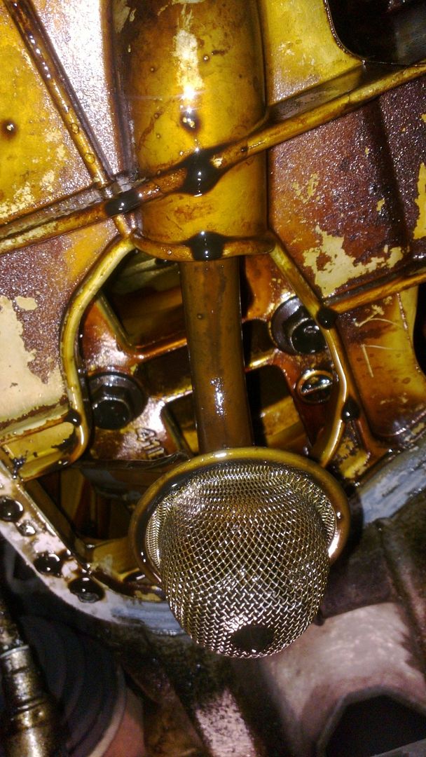

oil strainer we believe the haynes manual says to remove

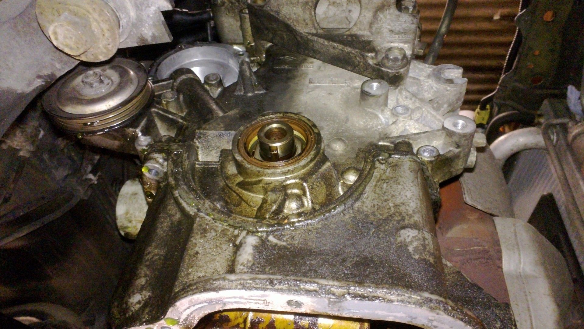

looking from the bottom of the engine at the timing chain cover

the sump is removed mate the metal still there is the crank case mate im sure it needs to be removed which is why the gbox needs to be removed
just watched the vid mate and bombadier is right looks like gbox will have to come off so would probably e easier t this point to remove the engine and finish on a bench then put the lot back in as one

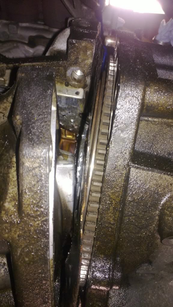

on the upper sump there is a lip that goes into the gear box, its about 10mm long. so you have to split not remove the gear from the engine enough to allow the lip to pass.
so we are there ready to put the new chain on and put the car back together
the lip

I have done this job on several occasions and what Frank is telling you is correct. The upper aluminium sump has to come off to releases the timing cover. Even if you did manage to get the cover off with sump on, you would damage the front of the Head Gasket and you would never get the cover back on.
You need to undo the Bellhousing bolts, push gearbox away from engine slightly, then undo all bolts from sump to remove. This is why as Belly 93 has said alot of people remove the engine to do this job. It can be done with engine in situ but be very carefull as when front engine mount is off and gearbox is un-bolted from engine only your jack will be supporting the engine and it will move around loads!
The red arrowed bolts in your pic are not timing case fixings, there just the front fixing bolts for the upper sump (one just happens to go into the timing case) The blue arrowed bolt is one of the fixings for the oil strainer (it has two) they are bolted into the bottom of the oil pump, which is part of the timing case (again access to these bolts is possible after removing upper sump)
Sorry unless you can seperate chain and feed it through as has been previously mentioned, there is no quick way of doing this. :(
Have you pushed the gearbox back?? It will not fully clear if the gearbox is bolted to the engine, even if it feels loose. Also sometimes they get stuck on the dipstick tube (the rubber seal goes dry and seizes in the sump.) The manifold bracket is also bolted to sump iirc so that will also need removing.
The oil stainer is bolted to the oil pump which is mounted in the front cover. It is done this way so it can be driven directly from a large keyway on the crank, instead of having a seperate chain to drive it.

i didnt question the need to seperate the two, the question was why?? and the anwser is there is a lip on the upper sump that goes into the bell housing

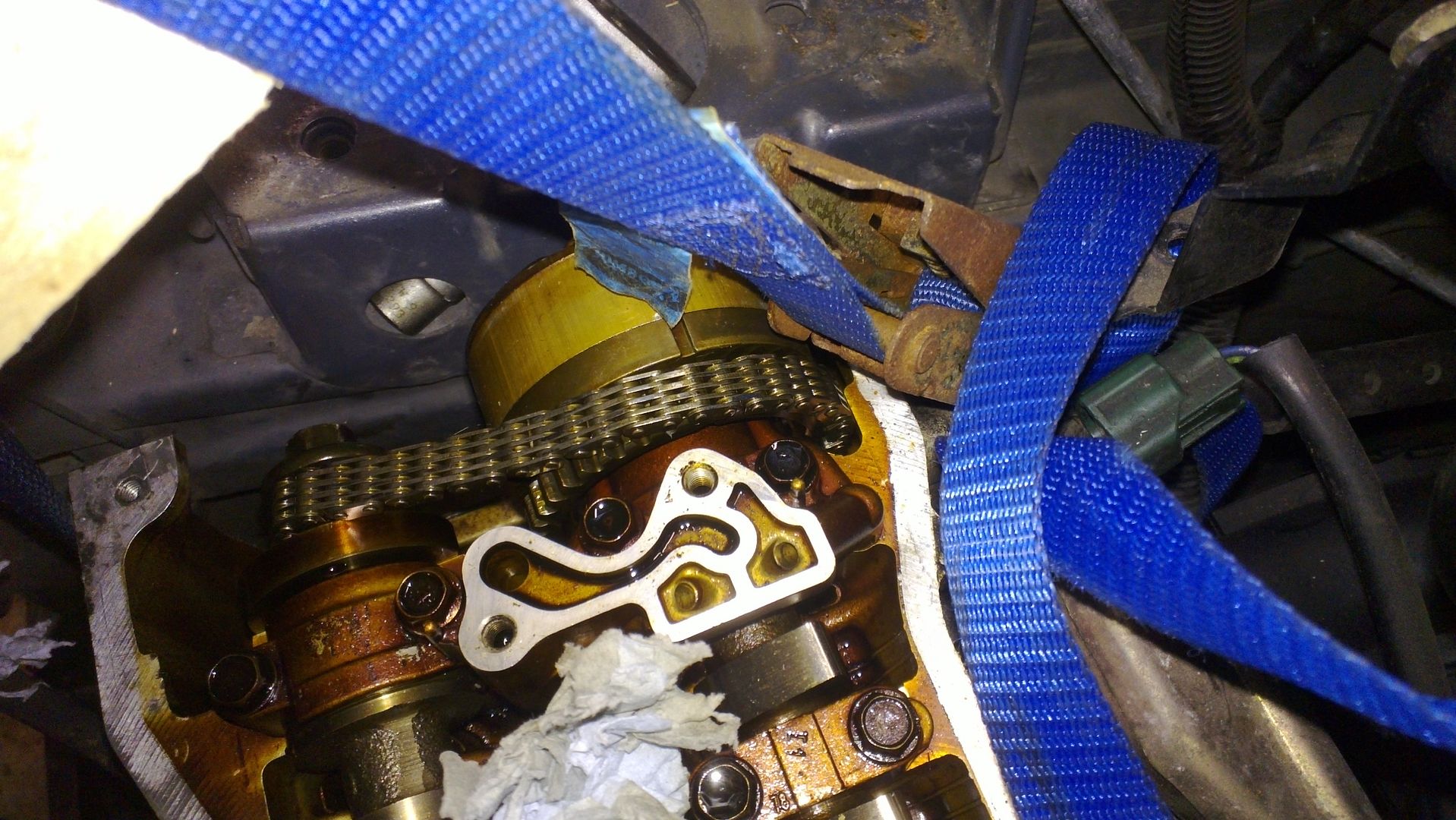

aye, pic,s of exactly where the lobes are pointing @ TDC cyl1 are a very valuable reference andy (but my advice back in jan was probably unheeded tho :D)
i align my CG,s with the lobes pointing at the side of the cap bolt (the red marks) and as long as the crank pulley is on the 2nd notch (tdc) its spot on.
but you have the vtec inlet complication too (which that guy will have sussed out i guess)
first, you,re supposed to lock the inlet cam mechanism into the fully retarded position iirc (with an airline down the oil gallery, then peg it secure)

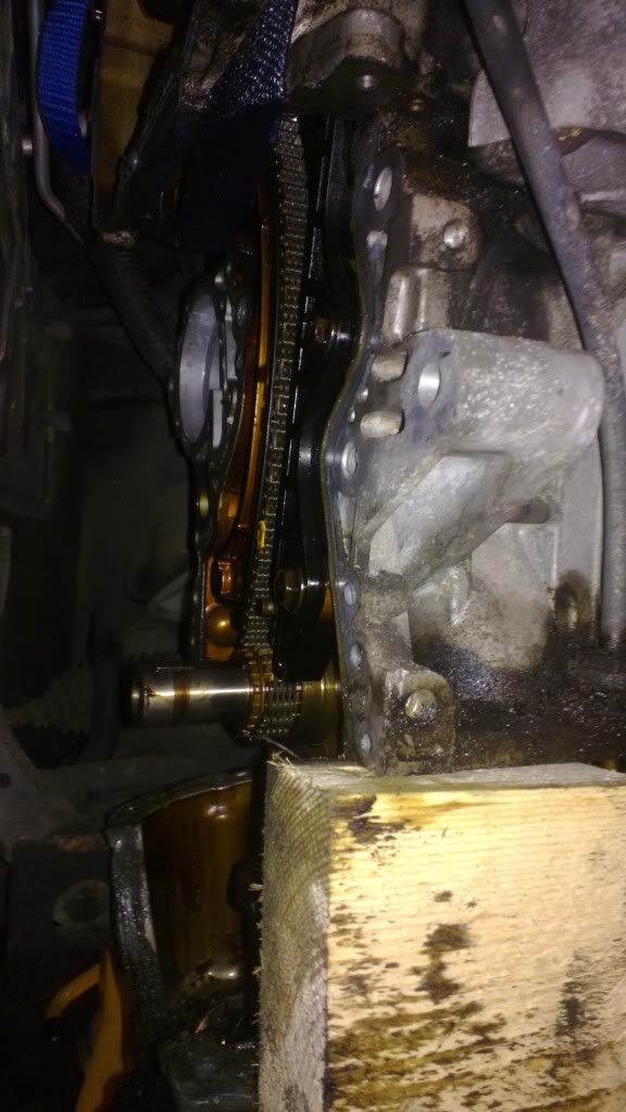

can anyone offer any help, im struggling to remove the camshaft sprocket
the crappy haynes manual talks about blowing air oil passage leading to the variable valve inlet sprocket but gives no info on how to actually do it or where it is?
ah the workshop manual, i did have this but lost it when i had to reformat my laptop.
ok so if general advice is not to remove it how do you get the main off of it and the new one on?
this engine is the worst deisng ever, where there another 5mm gap the chain would just slid off. but no... nissan decided to put the case in the way

i,m not sure andy, my understanding is that you have to lock the pulley so that the valve timing is set to the correct position, (get that wrong and the inlet cam will be out of phase, and might bend the valves when the vvl kicks in at speed !)
I agree with frank....... unless you took the chain off when vvt was engaged (impossible coz engine would be running) the timing will be wrong and may bend valves. Try more air pressurw... I usually use a w/shop airline 10bar
