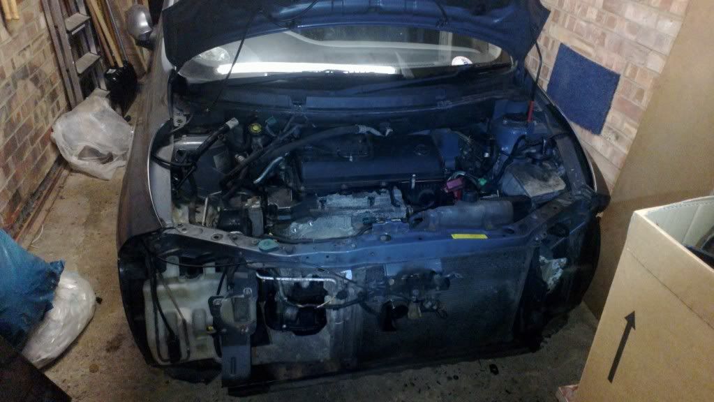

it took us just over an hour to remove the w**ky bumper, but once that was off the rest started flying off.
found lots of other things wrong -
broken earth cable to the alternator
possible source to the oil leak
needs a new aux belt which is mega cracked

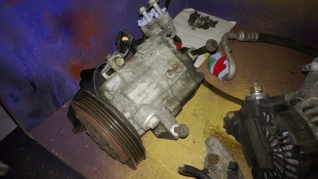

also the car needs a new air con pump, does anyone know which one is the correct replacement? been trying to fond one on ebay
its a 52 plate k12 1.4 micra
There should be a carlsonic? Green sticker on the side with part number. Or you can check on www.nissan4u.com

Unfortunately there's about a million different types (well when I was looking for k11 one) eventually I thought I found the right one but the pipes are too big (yet the part number apparently fits. Grr)

so i just go with 1, which is the whole unit??

I think the one that says compressor unit is the one you want.

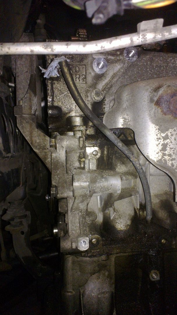

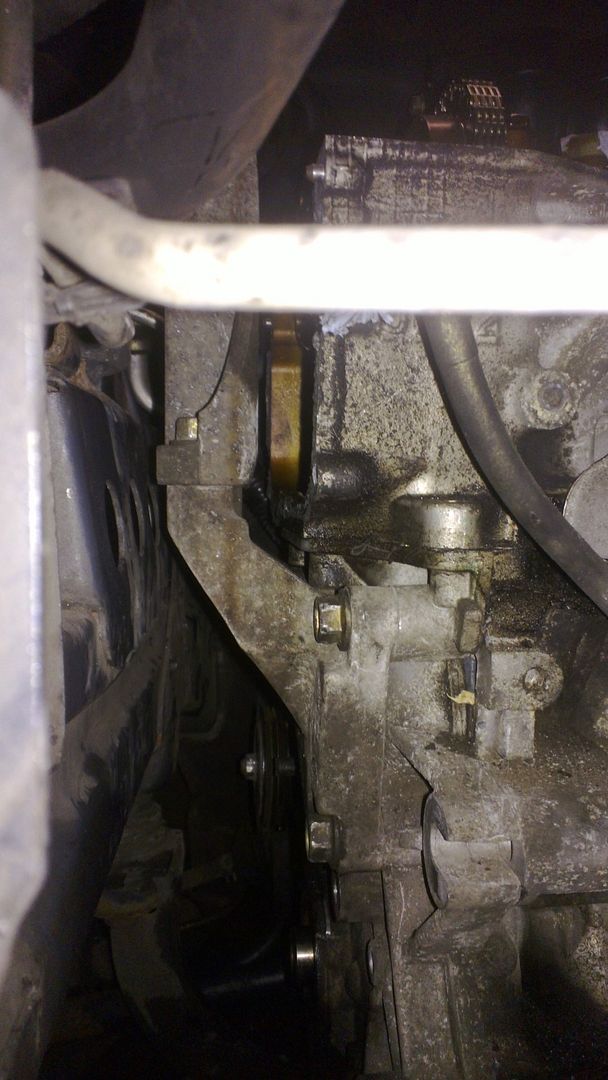

ok so some photos
here is a photo looking directly up into the engine with the sump panel removed.
the two red are bolts which we have removed as we believe these hold the timing chain cover on.
the green line is where the timing chain cover is
the blue bolt is the bolt we cant get to but and unsure if we need to remove this or not?
rest of the pics
a photo of the bolt which is blocked by metal
bolt again
oil strainer we believe the haynes manual says to remove
looking from the bottom of the engine at the timing chain cover

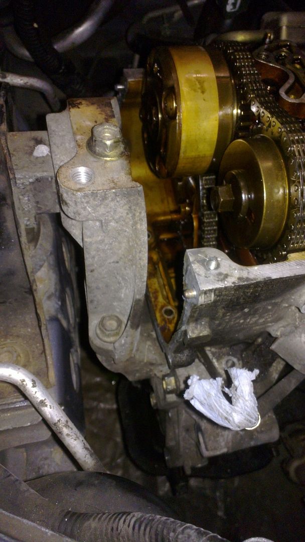

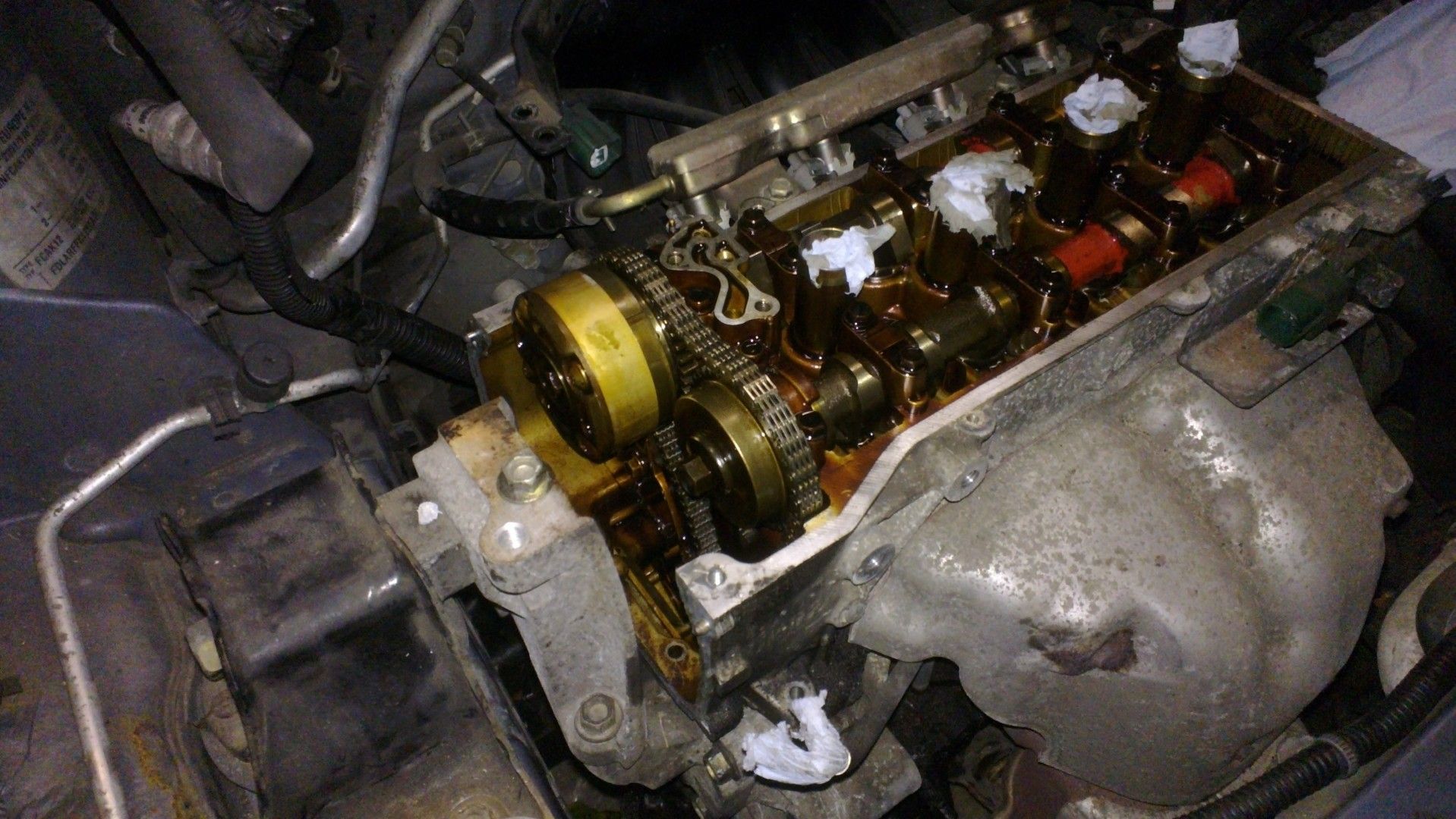

yes well and truly sandwiched eh, and if its like the CG, doweled x 2 also, there,s a guy on ebay that unpins the chain and feeds the new one through apparently
theres a guy on ebay from up north who fits timing chains for £250, so he clearly doesnt remove the engine to do it.
so its possible, if i could get the timing chain cover off all would be good

he,s the one i mean, the old biker "split the chain" trick
trouble is if you cant get the timing chain cover off you would be able to see the position of the bottom pully, which would make lining everything up very tricky
but if you cant see it you cant align it.
the marks on the pullys are so out its unreal, nothing lines up in the slightest
i align my CG,s with the lobes pointing at the side of the cap bolt (the red marks) and as long as the crank pulley is on the 2nd notch (tdc) its spot on.
but you have the vtec inlet complication too (which that guy will have sussed out i guess)
I have done this job on several occasions and what Frank is telling you is correct. The upper aluminium sump has to come off to releases the timing cover. Even if you did manage to get the cover off with sump on, you would damage the front of the Head Gasket and you would never get the cover back on.
You need to undo the Bellhousing bolts, push gearbox away from engine slightly, then undo all bolts from sump to remove. This is why as Belly 93 has said alot of people remove the engine to do this job. It can be done with engine in situ but be very carefull as when front engine mount is off and gearbox is un-bolted from engine only your jack will be supporting the engine and it will move around loads!
The red arrowed bolts in your pic are not timing case fixings, there just the front fixing bolts for the upper sump (one just happens to go into the timing case) The blue arrowed bolt is one of the fixings for the oil strainer (it has two) they are bolted into the bottom of the oil pump, which is part of the timing case (again access to these bolts is possible after removing upper sump)
Sorry unless you can seperate chain and feed it through as has been previously mentioned, there is no quick way of doing this. :(
Have you pushed the gearbox back?? It will not fully clear if the gearbox is bolted to the engine, even if it feels loose. Also sometimes they get stuck on the dipstick tube (the rubber seal goes dry and seizes in the sump.) The manifold bracket is also bolted to sump iirc so that will also need removing.
The oil stainer is bolted to the oil pump which is mounted in the front cover. It is done this way so it can be driven directly from a large keyway on the crank, instead of having a seperate chain to drive it.

this car is really fooing us off, we have given up getting the timing chain cover off. were going to try and split the chain and feed it round
