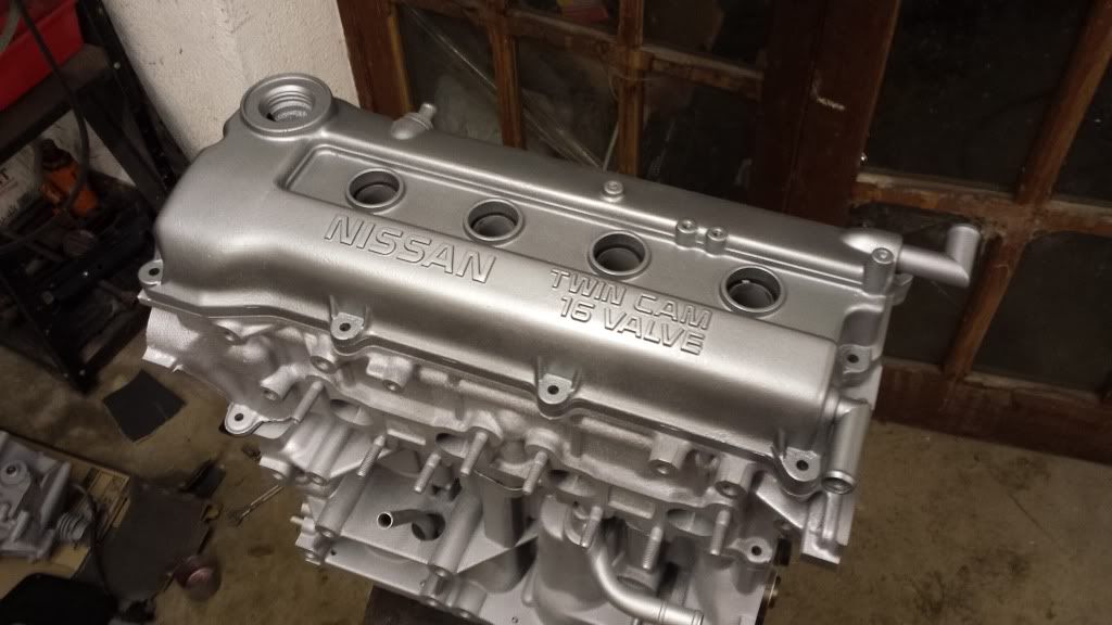

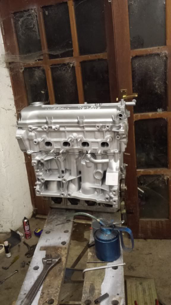

Almost finished the rebuild. Just gotta do a few more bits then it's ready to go back in the mini! Fingers crossed it goes well :)

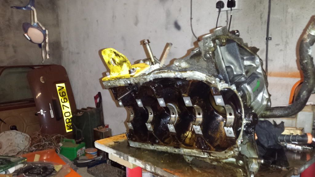

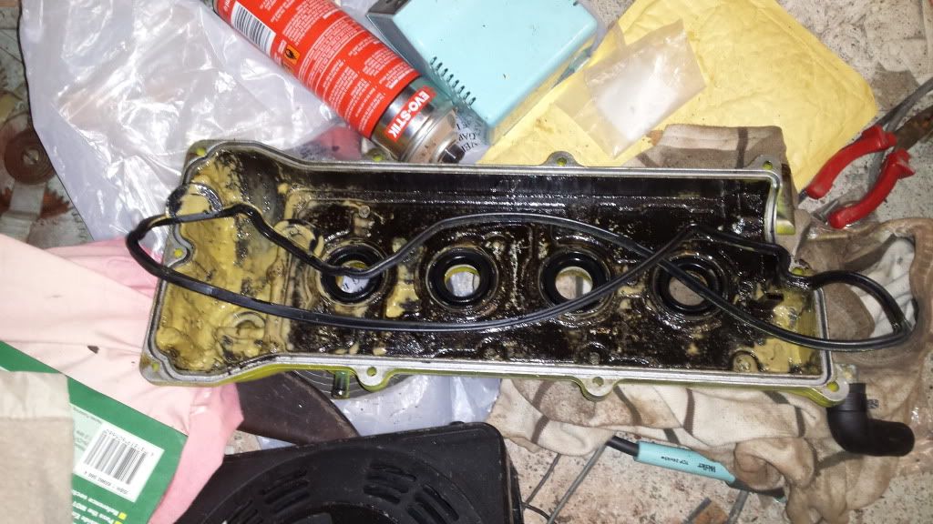

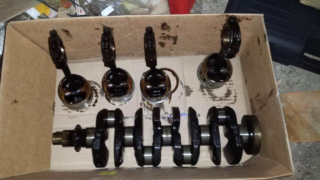

I found a shed load of black solids/gunk throughout the engine (dried oil?) Also the head gasket had seen better days. And the oil pump was scored pretty badly and just outside tolerance. The crank case breather was blocked completely with black stuff. And the timing chain tensioners were at the end of their travel!
