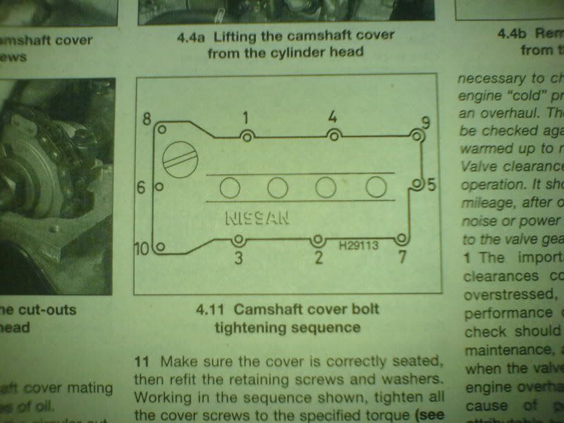

Right, can't get my phone to work - if you have the haynes manual then it will make more sense.
The standard bolt is 6mmx30mm, dunno about thread type, but the 6mm bolts from B&Q are the correct pitch. You need some 6mm washers and 3 6mmx20mm and 7 6mmx30mm bolts.
The three shorter ones go into holes 5, 8 and 10 - if you wanted to, you could cut some of the 40mm ones down to 30mm in length, but you *should* be alright with the 20mm ones if you do not use a washer.
Also, for hole number 7, you will need possibly an extra washer as the bolt bottoms out on the casting of the block.
he heads are 10mm and there IS room to get a slim socet onto it, although bolt 7 is slightly hampered by an oil pipe.

Ok, my phone has stopped being stupid, so here's the pic:

...make a nice job of it. Size 6X1.0 and 25mm long worked for me and I got them from a proper motor factors. All of the old screws were just over 25mm in length but Craig might be right about different lengths. Best check against the old ones.

Yeah, it was annoying that B&Q don't do 25-30mm ones - they'd be perfect as the ones that I have come out of the bottom a bit, no problems though.
