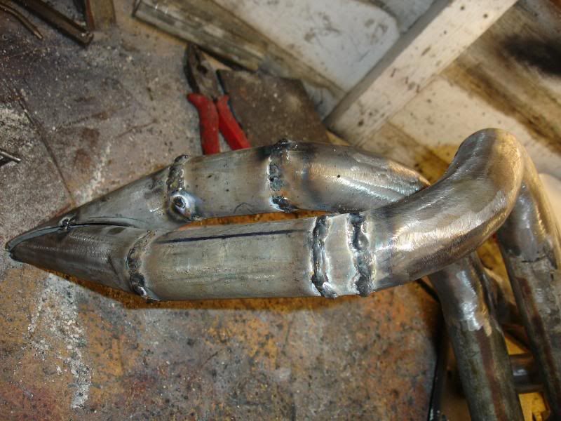

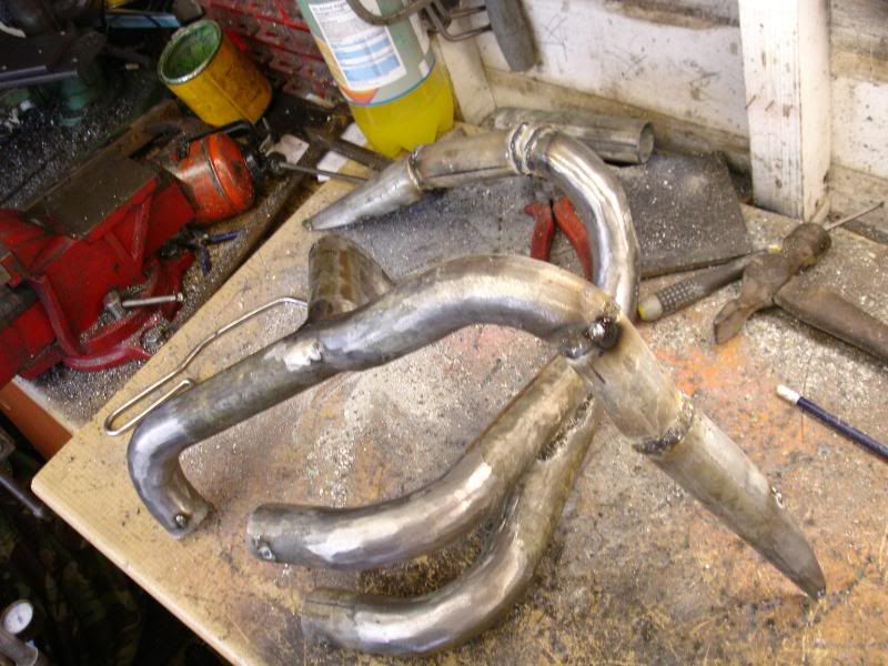

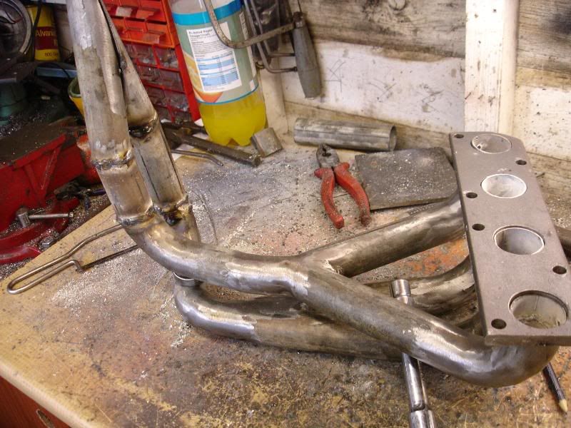

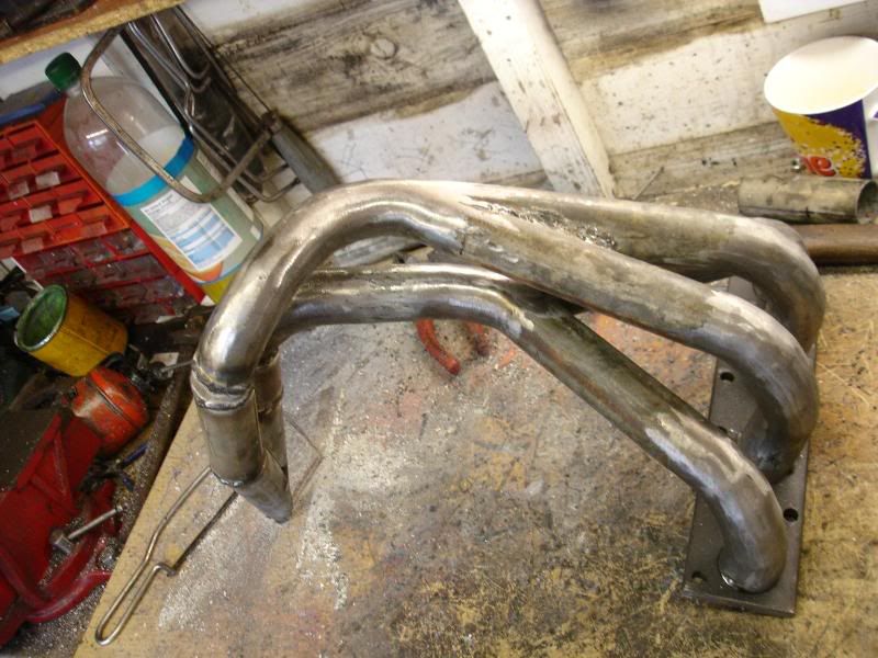

having finnished that in record time i decided to attempt to create a 4-2-1 exhaust manifold, a couple of pics in various stages:
![DSC01134.jpg](/proxy.php?image=http%3A%2F%2Fi183.photobucket.com%2Falbums%2Fx36%2Fsuperls%2Fmanifolds%2FDSC01134.jpg&hash=cf8e20cb1b021ff5e75f3ce0864c016b)
![DSC01133.jpg](/proxy.php?image=http%3A%2F%2Fi183.photobucket.com%2Falbums%2Fx36%2Fsuperls%2Fmanifolds%2FDSC01133.jpg&hash=83ca1385d883ee0eba0fa44865734520)
![DSC01135.jpg](/proxy.php?image=http%3A%2F%2Fi183.photobucket.com%2Falbums%2Fx36%2Fsuperls%2Fmanifolds%2FDSC01135.jpg&hash=58a02c52eb620781ee894144bd4a59ad)
![DSC01138.jpg](/proxy.php?image=http%3A%2F%2Fi183.photobucket.com%2Falbums%2Fx36%2Fsuperls%2Fmanifolds%2FDSC01138.jpg&hash=0e1e5e7cef2160a3fc25a224a514d54c)
I eventually got it finished.

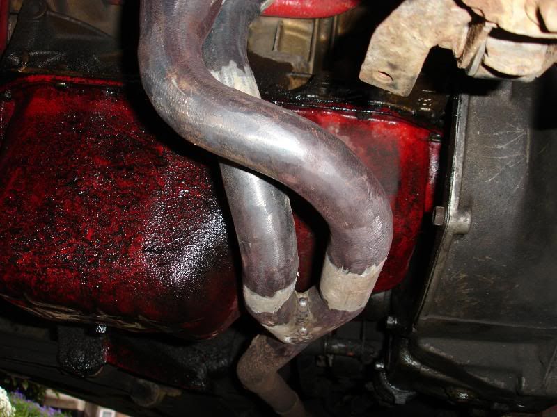

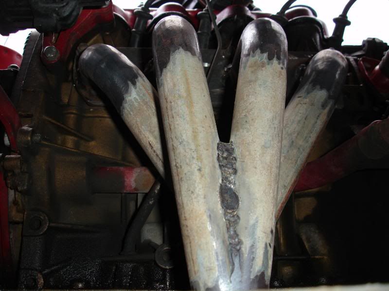

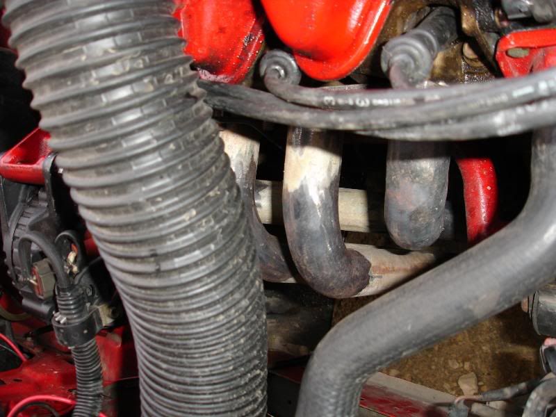

The weekend before last I decided that I was going to fit the exhaust manifold and mate it up with the existing system, I managed to get it finished shortly after lunch, started her up checking for leaks etc. revved it, and it sounded totally different.
here a couple of pics of it fitted
![DSC01148.jpg](/proxy.php?image=http%3A%2F%2Fi183.photobucket.com%2Falbums%2Fx36%2Fsuperls%2Fnew%2520manifold%2FDSC01148.jpg&hash=c46169f187a5c529716a21ac7698c48e)
![DSC01147.jpg](/proxy.php?image=http%3A%2F%2Fi183.photobucket.com%2Falbums%2Fx36%2Fsuperls%2Fnew%2520manifold%2FDSC01147.jpg&hash=6741ab1373bea9a7700c11f9808a8df2)
![DSC01144.jpg](/proxy.php?image=http%3A%2F%2Fi183.photobucket.com%2Falbums%2Fx36%2Fsuperls%2Fnew%2520manifold%2FDSC01144.jpg&hash=dd3c3d03a3bab96af5a0cd7d73e8df09)
