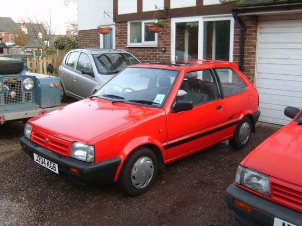

OK picked up my K10 Super on the 23rd March 2007 (2 weeks ago). It cost £20 and it was in horrible condition. I failed to take any decent images of it when I first picked it up, but I did think to take a photo half way through cleaning it up, basically the whole cars bodywork looked like this:
Anyways, the next day a brake pipe was fitted, some bulbs done, some welding and the arch was bogged up with fibreglass to fill up a 40cm wide rust whole to scrape it through it's MOT. It passed, so then I set about cleaning her up.

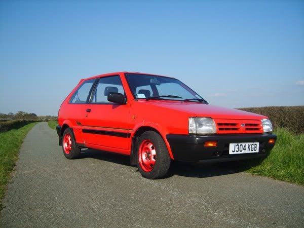

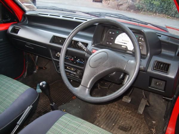

Today it looks like this:
Obviously nothing like done, but I think I've not done a bad job of cleaning up the bodywork so far. As you can see the carpets and seats are yet to have the 'Baz' treatment. Also need to blacken up the bumpers a bit more plus a few other bits and pieces.

Thanks guys. Not resprayed anything yet. The pictures do it more justice than they should. I think that colour red is great and it looks well in the sun. I've got the paint pretty much looking all the same colour just with T-cut, but still there is a slight colour mismatch where the previous owner has had a panel resprayed...I notice it and it annoys me. Also the photo is from the better side. As I mention I need to replace the front wing on the opposite side and the rear section of rubbing strip needs putting on (it was missing when i bought it) aswell as fixing the lock so it doesn't hang out. I also want to scrub down all the wheels respray them black and replace all the wheel trims because the wheel trims are different on the other side, and non of the trims are in great nick.
I wish I had some decent pics of it when it was manky, but to be honest when I got it home I didn't even go in the house before I started getting the worst of it off because it looked awful and I was worried that someone would ring the council to ask me to remove it :laugh:

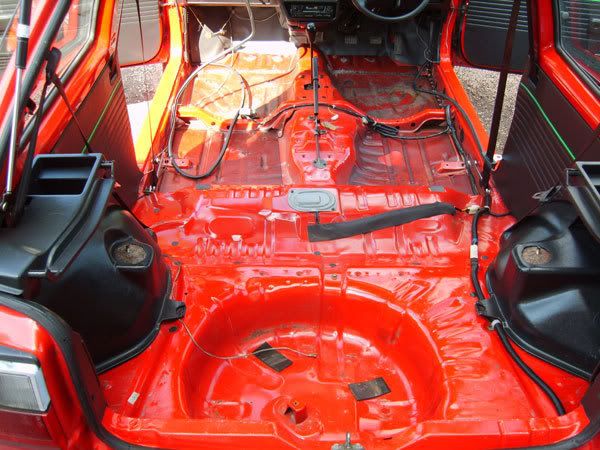

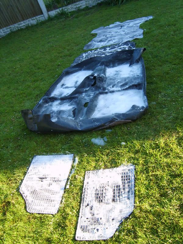

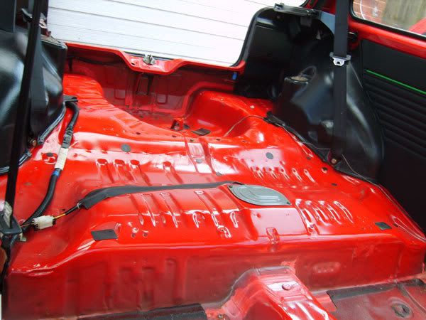

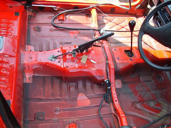

Today I had plans to start work on cleaning the interior, but due to getting horrendously drunk last night, work didn't start on anything until about 3pm this afternoon. Even so, I changed the interior from this:
To this:

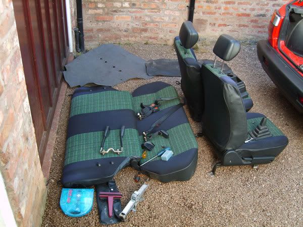

I bunged all the interior on my neighbours drive:
Bunged the carpets in my garden:
And then spent an hour or so scrubbing the hell out of it with a nail brush and some hot water with lots of Fairy liquid in it. Didn't scrub the boot carpet too much because it's one from a scrap yard that is the wrong colour and I will be replacing it with a dark grey one as soon as I find one:

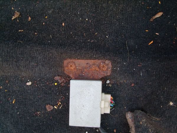

Whole thing went very smoothly really. Only problem areas were the amount of water that was under the carpet...so trying to work out where it's come in...think it must of come in from underneath as the carpet has a plastic backing and the carpet above the plastic backing was bone dry. Also the idle speed control system's bracket holding it to the floor pan was rusted fast, the screws wouldn't even come off using an impact 'driver so in the end I had to drill them out:
Anyways, carpets are on the washing line now until they dry. I'll start work cleaning the seats tomorrow and start to wash the floor pan, if I get a few hours spare. Might make a new bracket for the idle speed control unit aswell...doesn't need one really, but it'll look nicer than a rusty one.

if you havent found the leak i wouldnt put anything back in yet
check the sunroof drain tubes by pouring water down them, if leaks in then thats problem if not
pour water into scuttle panel where the front wiper arms are on both sides, if water comes in its a dash out job to fix the hole
and would you look at that you have the wiring for the digital clock in there already!
Cheers Fordy, I think the water is coming in from underneath. The carpet on top was dry as a bone, but the sound deadening under the carpet was soaking wet. I realised today that I had jet washed the underside last week...so it could easily have gotten in thru the hole for the gear stick or one of the other factory holes. I will do what you suggested aswell though just to make doubly sure. Might try that tonight actually. Thanks.
i had the same problem but all it was, was a grommit not in properly, but having a carpet thats damp underneith will start the floor rusting in no time
I checked the sunroof and scuttle panel, no water came in, also used a hose on the door and window seals, still no water, I've searched the car as thoroughly as I know how and the only way I can find any water getting in is from underneath and only through factory holes, so I will plug them up with tape until I get some blind grommets. I found a tiny hole under each rear arch today (but not ones that lead inside the car) which, once probed, became 4 rather more sizeable holes. I bashed about some sheet steel to the right shape and welded that all up today and sealed the welds with some high quality sealant that I found in my neighbours garage...which I have failed to get off my fingers despite attacking my hands with a scrubbing brush and petrol, parrafin, white spirits, industrial thinners, and swarfega. My hands have still got black sealant on them, but I probably now have blood poisoning from all the crap I've used lol. What's so daft is that I have boxes of surgical style gloves that I can use...I was just too lazy to go into the garage to get them. Stupid.
Interior in tomorrow as it's finally dried.
Try washing above the rear light clusters too, if they have been changed it will run down there and into the car when you break it will all come forward eventually into the passenger and drivers foot well!!!!!

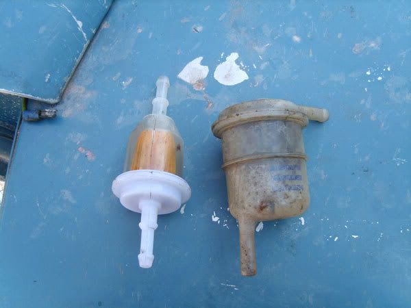

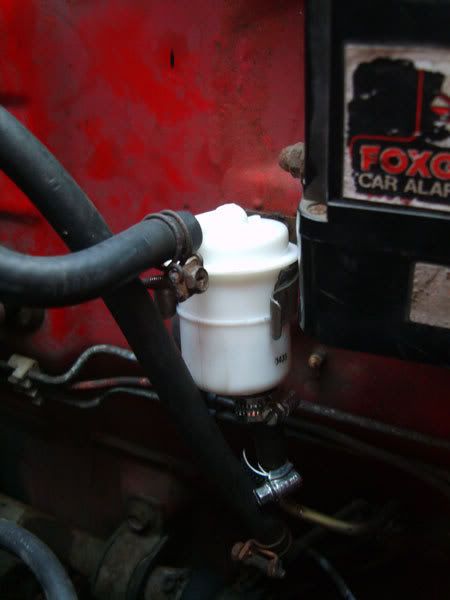

Cheers Sammo. Finally got the engine running smoothly today by replacing the universal fuel filter with a proper fuel filter. The rubber piping that connects the metal fuel line to the bottom of the plastic fuel filter was very weak and snapped when I pulled the filter off. I found a similar bore of pipe on one of the V6 Ford engines my neighbour has in his loft. I hacksawed it to the right length and it fitted fine. It's a very slightly bigger bore but with new jubilee clips it fits fine. Engines running great now, very pleased.

Fuel filter...would you beleive it?
I thiought even the universal onnes were decent enough...just goes to show what I dont know (but do now!!)
Nice job!!!
Yeah I was quite suprised that it did the job...I was intending to clean out the carb, as I thought it was probably summat to do with that, but I knew it wasn't the correct fuel filter on the car and knew that I wouldn't put my full effort into the carb if in the back of mind there was a niggling feeling that it could just be a cheap fuel filter issue instead lol. Got the part today, fitted it, and hey presto it runs great. The universal one had a slightly smaller bore, which probably was restricting the fuel a little. The symptoms were really only noticeable when driving hard, now the symptoms are gone :)
haha. Just thought I'd better point out that the one I've put on today is NOT a Nissan branded part, but it IS designed specifically for the K10 and looks identical to the proper Nissan part (except it doesn't say nissan on it and the plastic is less see-thru)...the universal one was an entirely different shape. I'll take photo's of the proper Nissan one, the Universal one, and the replacement non-nissan one I have on, and I'll post them here tomorrow so you can see the difference. The old filters are in my neighbours garage at the moment (he's got a posh clean double garage, whereas mine is full of crap so I do most my work in his garage lol)
OK Sammo, here is a pic of the Nissan fuel filter (on the right) and the universal one (on the left...obviously!):
And here is the nissan imitation that I have put on:
Was gonna take it off to take a photo but was running short on time and couldn't be bothered in the end lol, it's exactly the same size and shape as the proper nissan part except for some reason it has a very slightly bigger bore.

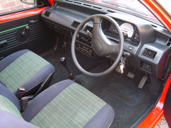

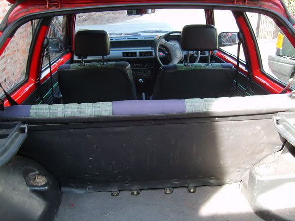

Anyways, in the interests of keeping up my blog; today I put all the interior back in. I cleaned the backs and sides of the seats with cockpit shine, did a good job actually, I haven't yet cleaned the fabric on the seats due to lack of proper cleaner, bought some today though so I'll do that tomorrow. Here's the interior now:
Looking much much better than it did do.

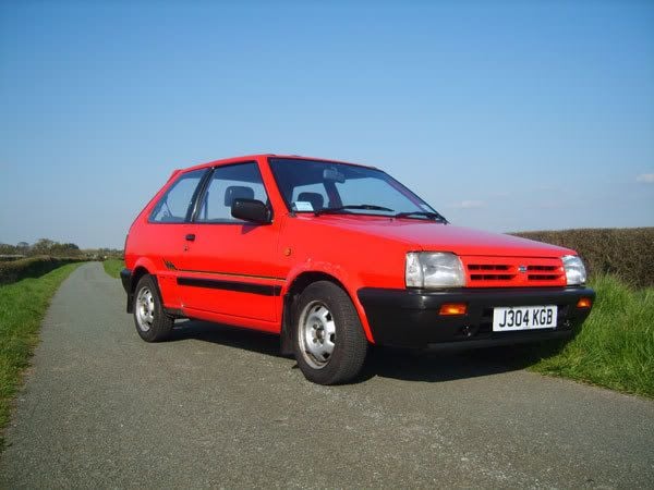

I spent most of the day in the pub fixing the pub's computer but when I wasn't in the pub or fitting my interior I was blacking up my bumpers, and all the black trim. I also gave the tyres a quick squirt with tyre foam...there was no need for the tyre foam, I just like using the stuff lol Here's the results, I'm very pleased with the blackness of the bumpers and trim, it was a turtle wax product I used:
As you can see I am still to replace the from drivers side wing, which is just completely knackered. I will get round to getting a wing by the end of the week hopefully. I also still need to find and fit the rear part of the rubbing strips.

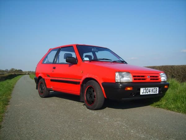

Red Wheels:
Black Wheels:
Ems Idea:
The Black Wheels I've done look very matt in the photoshop I've done, I would make them shinier in real life. The red ones match the bodywork, but I still think they would be over the top. The black and red ones look good...but...I only have steel wheels and am not planning on buying alloys for this car. If they were alloys I would be more tempted to spend some time making them look great, but as steel wheels I think plain black may be best. I'm still not sure, but that's the direction I'm going in! I just think that the red ones, although good in theory, just are a bit over the top, I think that the black wheels, are kinda no-nonsense and less "look at me, look at mee!"...the black with red detail, either on the rim (Em's idea) or in the 'valley' of the wheels (Paul's idea) are making my brain hurt due to too much information...I can only handle small amounts of information like Red OR black..not red AND black lol!! During the posting of this post I've pretty much decided that I will paint them Black. Once that's done I will have a go with the red details and see what they look like.

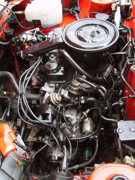

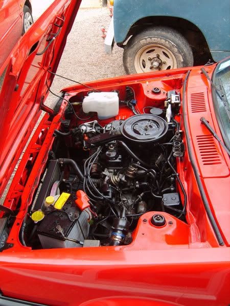

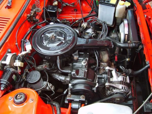

This morning I cleaned the engine bay. I didn't take any parts off to clean, I just cleaned them in situ, which was a pain, and doesn't get the parts properly clean, but to be honest it's good enough for me at the moment. There is still lots to be cleaned in the engine bay but I have a cracking headache due to my hangover and can't be arsed doing any more until my head ache is gone. I might have a go at doing one of the wheels later today if I feel better.
Anways, pics of the newly cleaned engine bay, as you can see there is plenty more work that can potentially be done on it, but it's OK as it is for now I think:
nah, I used Jizer spray, an old paint brush and a cloth. I did start steam cleaning it, but the steam cleaner I was using was designed fo stripping wallpaper, not cleaning cars, so it wasn't versatile enough to move in and around the engine, so I gave up on that idea. Once I'd cleaned it up with Jizer I gave it a spray over with WD-40 to shine it all up a bit. Took about 4 hours I guess. It's the one and only benefit of being between jobs..having some time to tinker with the car in the daylight!
Wow that looks excellent! One of the cleanest K10 engine bays i've seen. Great job

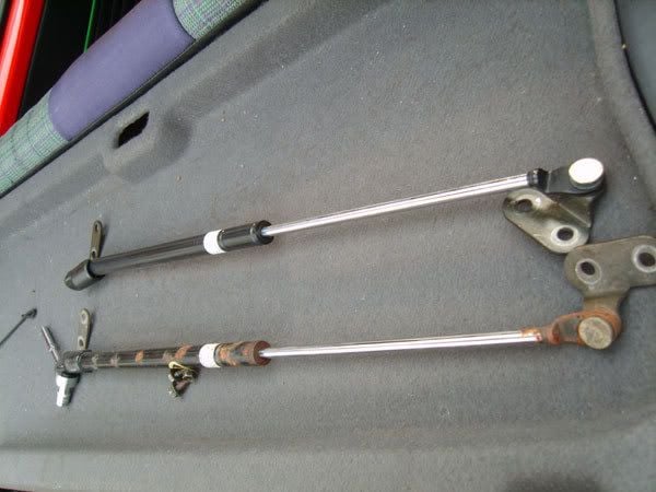

Comparison of my old lifters and the new ones I got:

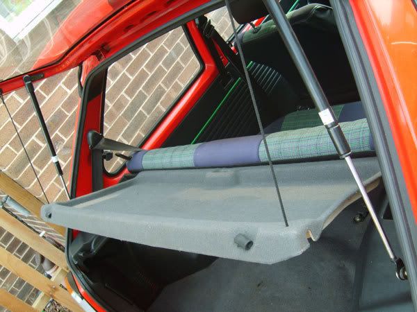

I am pleased with them...the parcel shelf is the wrong colour but it's the same colour as my boot carpet (also the wrong colour for the car) so it doesn't look too out of place and will do until I find one the right colour. I'll keep the other lifters in as spare as they work perfectly well, still have all there compression and that, they just look horrible. I'll try and remove the nissan sticker, sand them down, respray and replace the Nissan sticker if possible.
