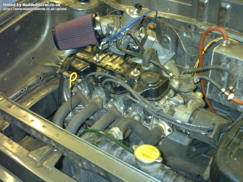

Hi Bob as a virgin grasser I am very interested in your project.
I am building my first grass car also a K10.
Would you tell me what kind of inlet manifold you are going to use.
Mine has a standard micra inlet with an extension pipe and a big S U on the end.
I bought the engine complete with this set up and have no idea how it will perform...
Any info would be greatly appreciated.

hi mick which club are you with as for inlet i made it from using half an mk 2 cavalier 1.3
Hi Bob I have just joined Invicta Kent.
I guess you mean the inlet half ?
I have never seen the sort of inlet manifolds used on grass cars.
I was always told the shorter the inlet track the better,
but I will go with the flow, there are far more cleaver people out there
than me.

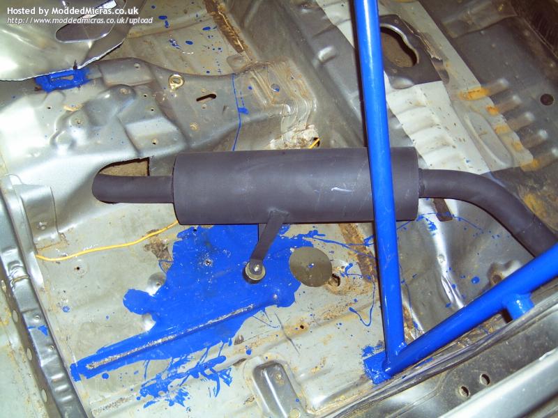

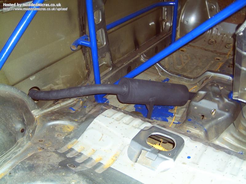

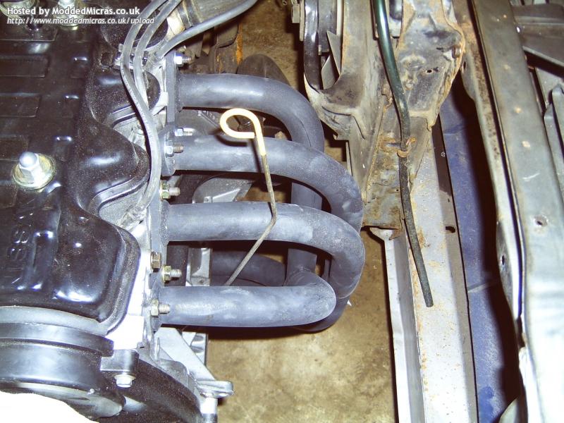

anyway the car has gone away again up to leeds to have a one off full race exhaust system fitted by tony laws.
I will post some more pics when its back on saturday hopefully

haha thats quite nuts. Any reason for it going through there rather than out of the back?
paul,paddy and rik all hit the nail on the head by there own gasses. does'nt get dashed about at the back and ripped off from underneath when i go over the inside track marking tyre's

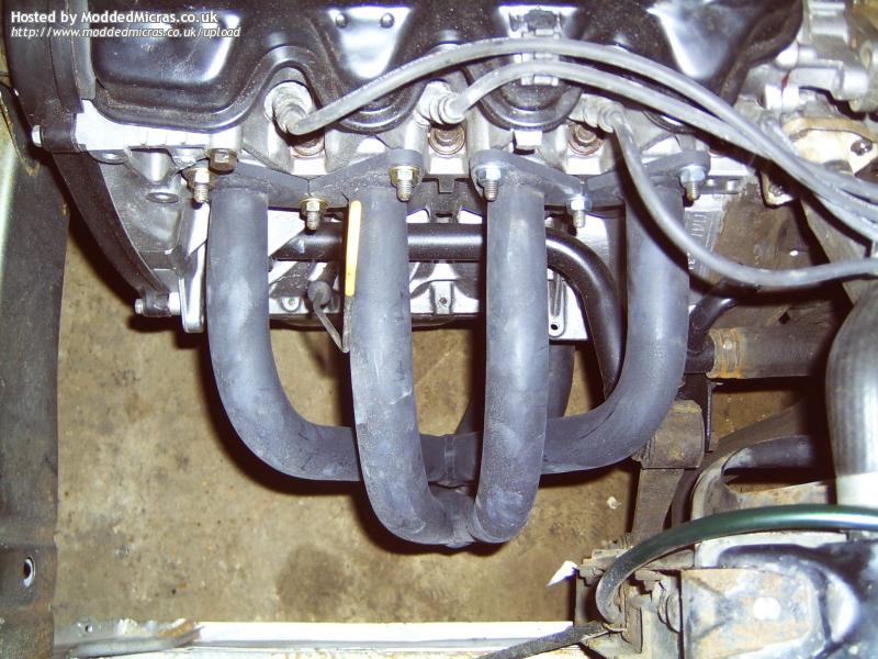

paul not cheap but you only get what you pay for nowdays if you wont a system that right for your car you have to pay
one of my mates had his nova on the rollers with a full peco 4/2 1 system and that same day he swopped it over for one of tony's system and gained a extra 6bhp.
all these after market 4 branch systems ie peco,janspeed,ashley,are all to large abore for the engine's there for so he sez

tbh i think £440 is a bargain esp for the manifold. i guess that wouldn't be road legal, being that part of the system is in the car

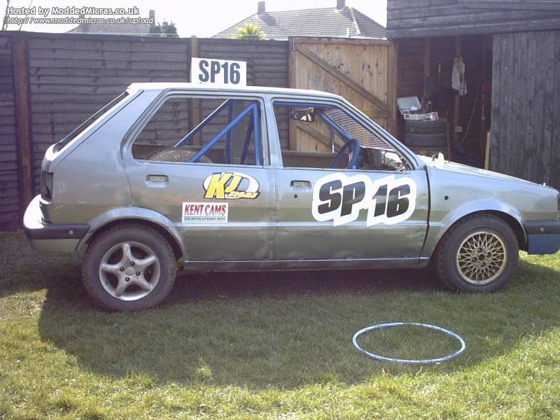

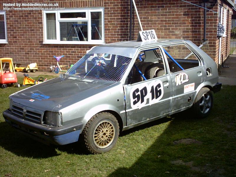

Autograss class 2 now ready for racing
she is all done now ready to take out and try this sunday.had her all set up on the rollers last week 86bhp@ wheels and the engine's not loosened up yet so could see another 2/3bhp when run in so the man with the rollers sead.
Nice work! I see you have changed your manifold design again :) Soon youll have tried everything and will know exactly what will or wont work the best haha :)
you dont no until u try ed but with this one ive done the power come in better and last longer.
it starts pulling from low down about 3200 then its at 80bhp at 5000rpm,86 peak 5600,and still up there until 6500 them only drops off to 80 over 6600,which was alot better than before were it peaked at 5600rpm at 85 but by the time it hit 6000 it went down to around 70 and dropping,so this give me a good 1600rpm at top end power,

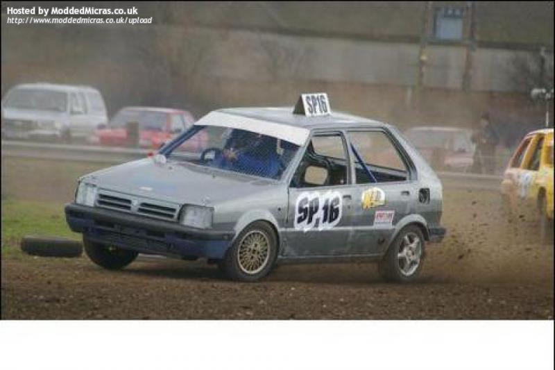

1st outing out with the car and it was crap,to soft on the front end and had a missfire around 4000 rpm,been playing about with it for most of this week so hopefully sorted out now
bit of development mate, these things were sent to test us!
Nice pic, and hope the development goes well :grinning:
Nice project! Looks crackin'! lol
Well done on the race! That 2nd place was a deserved result! (even though you deserved 1st) The MSC sticker should give you atleast 5hp more though!
