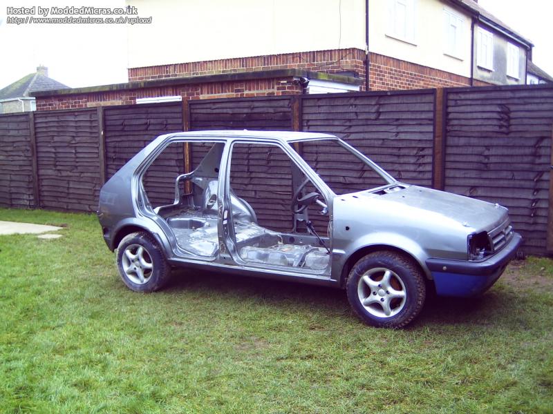

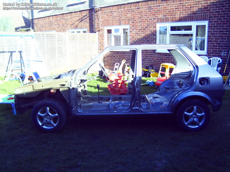

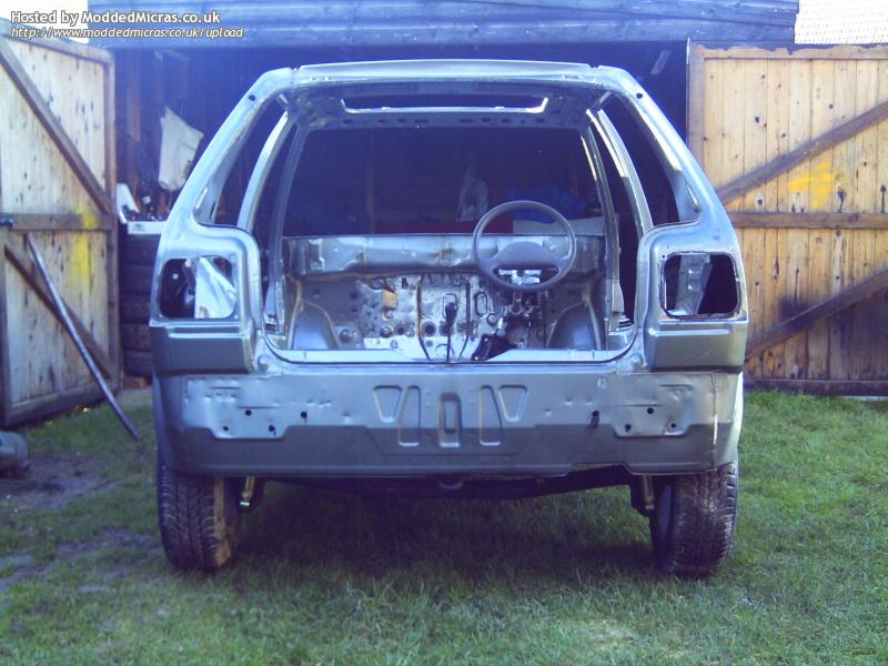

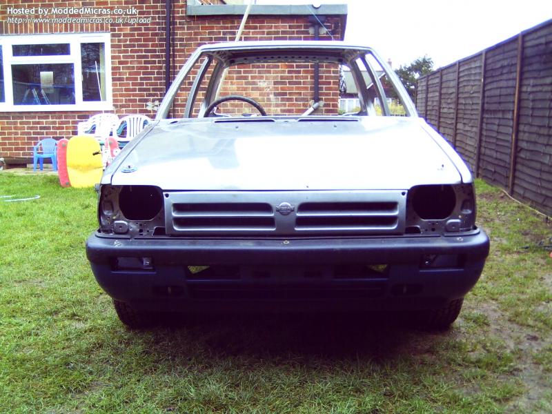

Ive have just started to build my new racecar for 06 season i will post picture's of progress step by step if anyone's interested in following the stages.
season starts around march
suspension is kyb gas front shocks with avo springs and on rear is gaz coilovers..

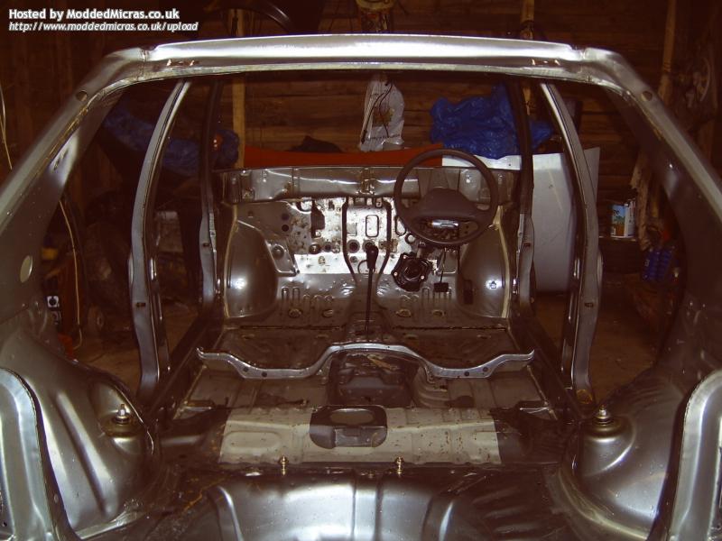

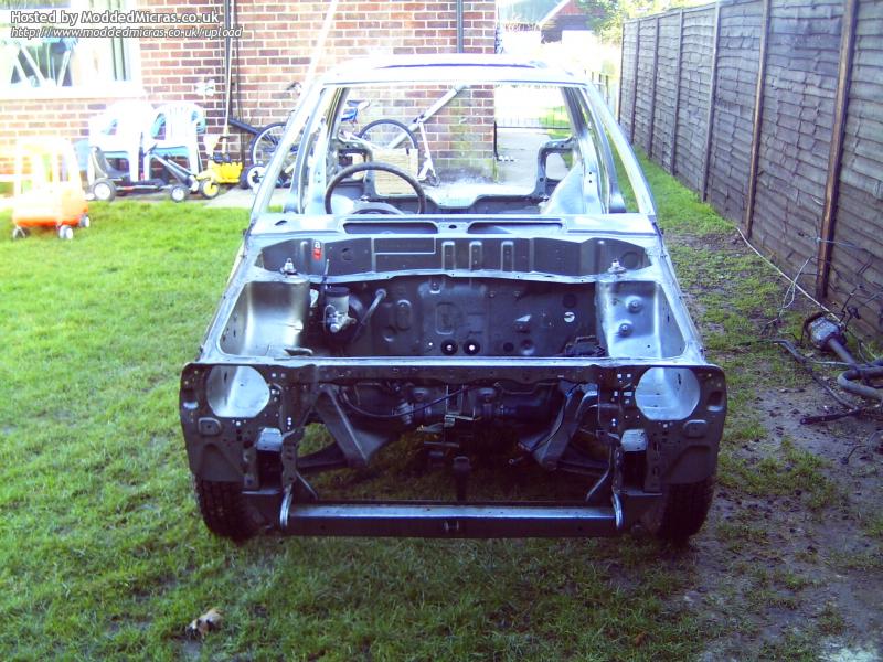

as you can see everything is stripted out,petrol tank all wireing even down to the brake pipes there gone and also under the body its been shot blasted to get rid of all the under seal.
Its so lite at this stage i rolled it onto its side by my self.

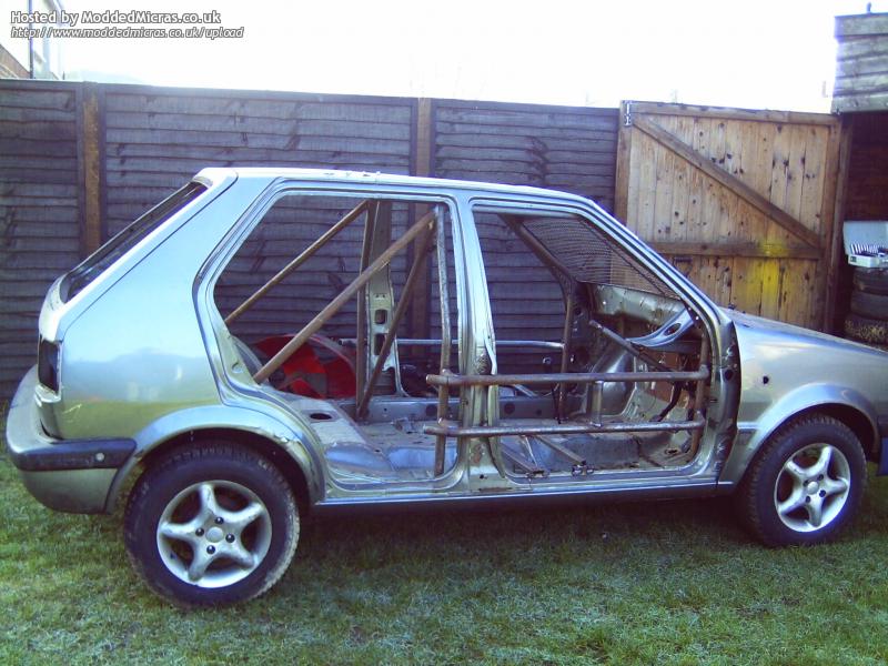

now its off to have its rollcage and seat fitted be about fortnight

building an Autograss class 2 micra step by step

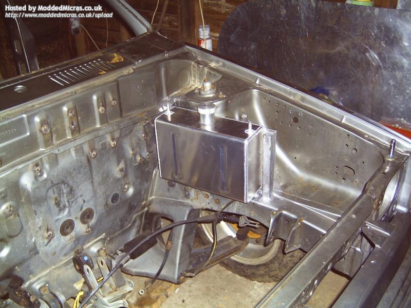

sealed up all holes in bulkhead to create a firewall and fitted the petrol tank tonight.

now have you ever tried to take a hole door off in one peace they are really heavy about a stone each we only use the skin.the boot lid ways about the same that also gets skinned,all seat belts and fixings there not lite even hand brake and its housing and cables,
you all no how heavy the front seats are the hole dash with heater matrix you can just about manage that on your own

what kind of cage do you use are they easy to make?
paddymarsden said:
Very nice dude, seat dont look that comfy but i assume you will be padding it out, amazing welding
them type of seats paddy are very comfy its a kirkey nascar one which has a vinyl and form padding cover ,but i didn't wont to get paint on and also ive been welding above it..
