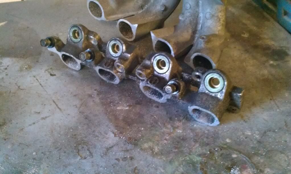

i wa looking at this toyota one today, and the flange and boltholes are miles out, and the injectors are fitted into the head not the mani fwn
The one in my local scrappy is the earlier type and I think cut and shut is the only real option imo. Done loads of cut n shuts before though. Looks fun too me :D
