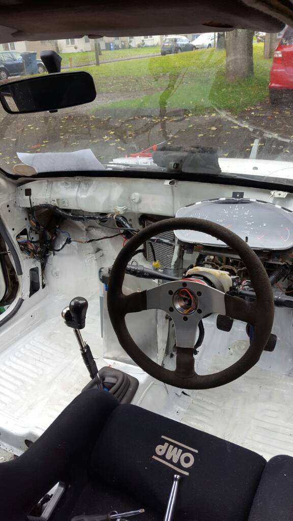

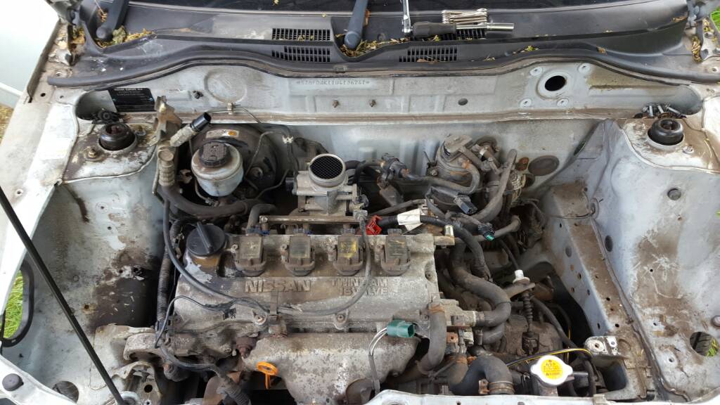

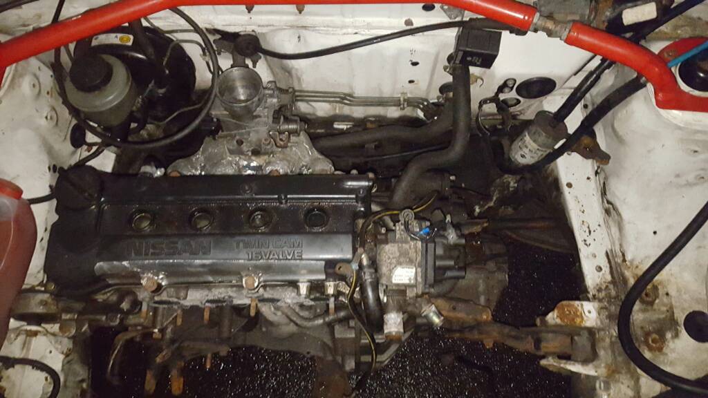

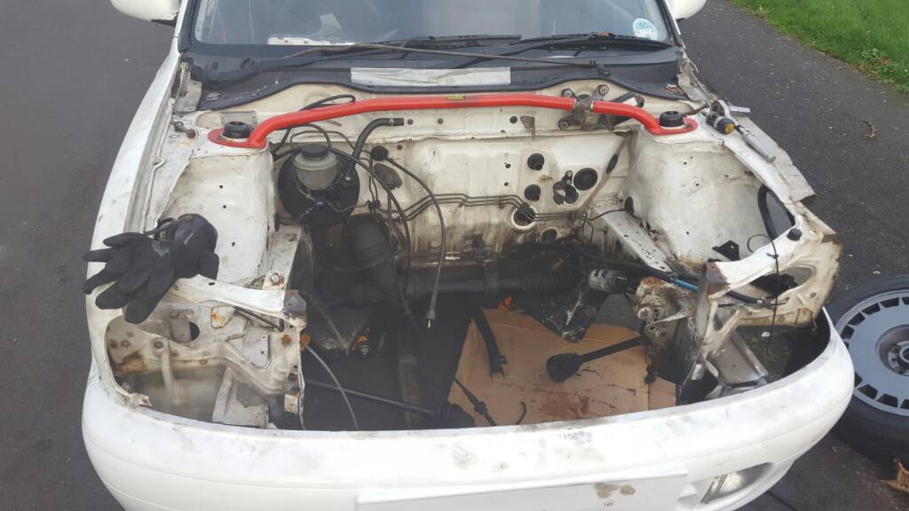

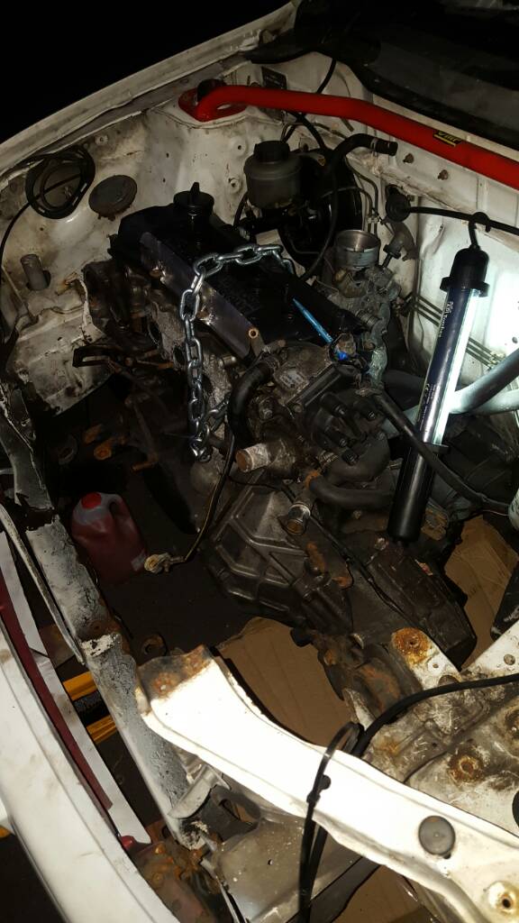

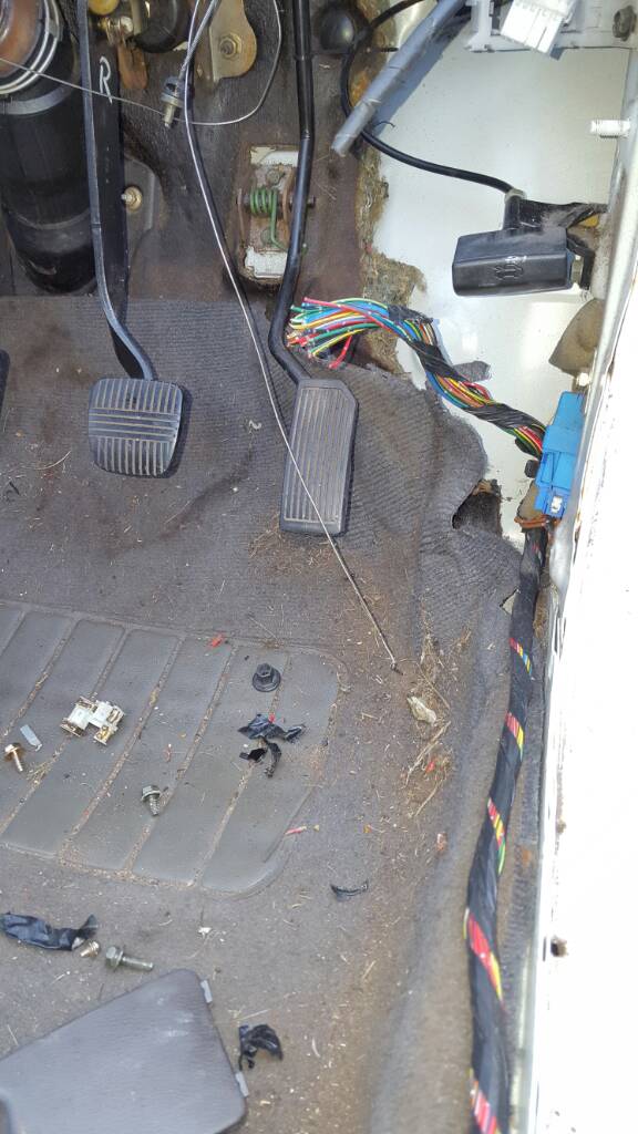

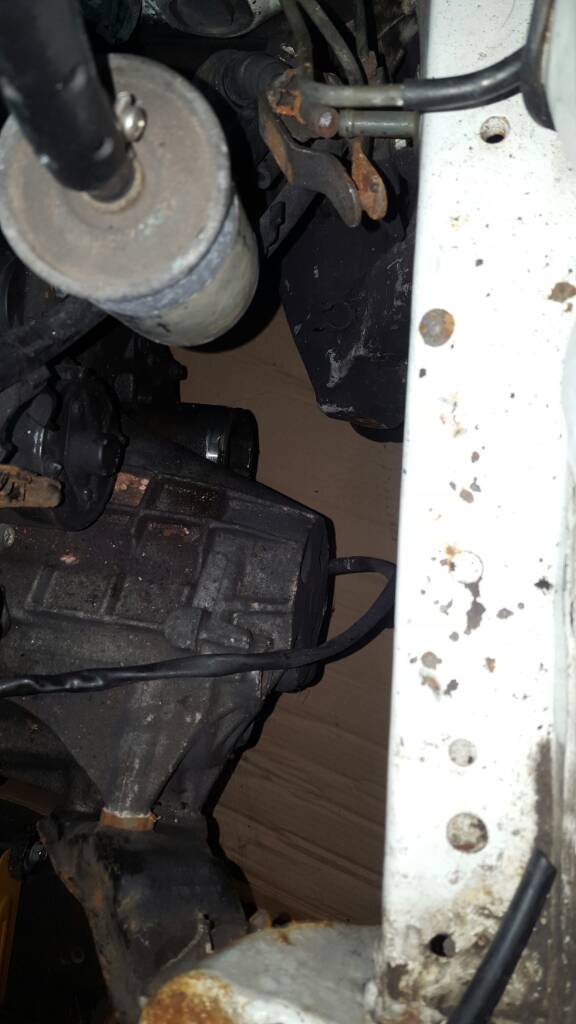

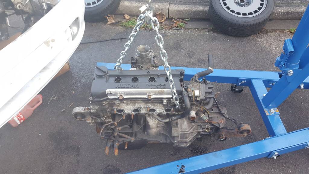

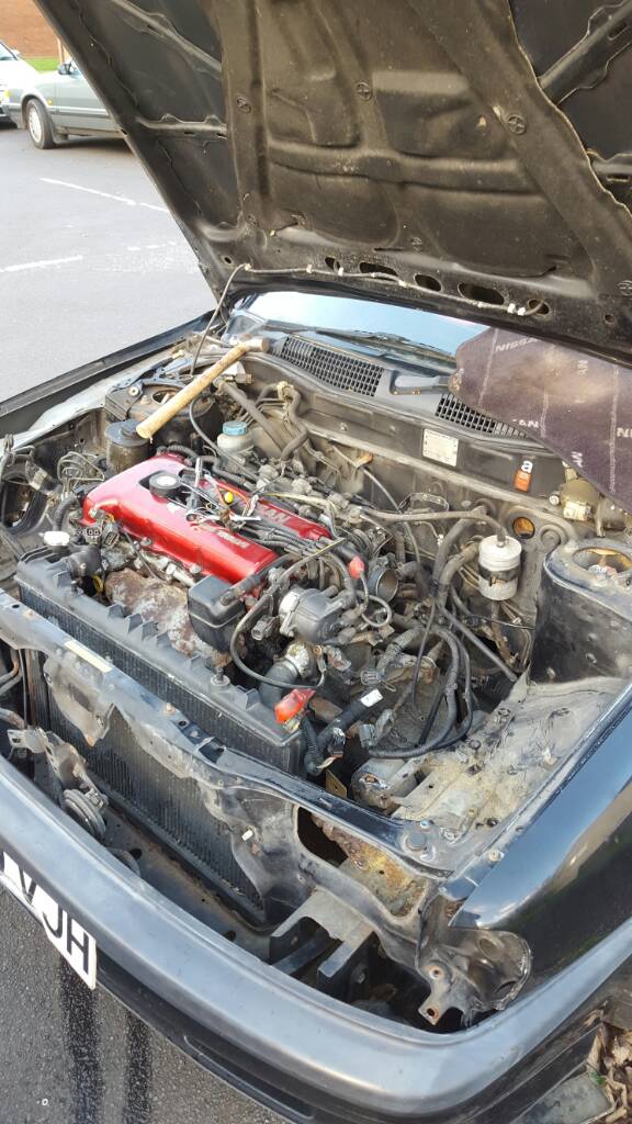

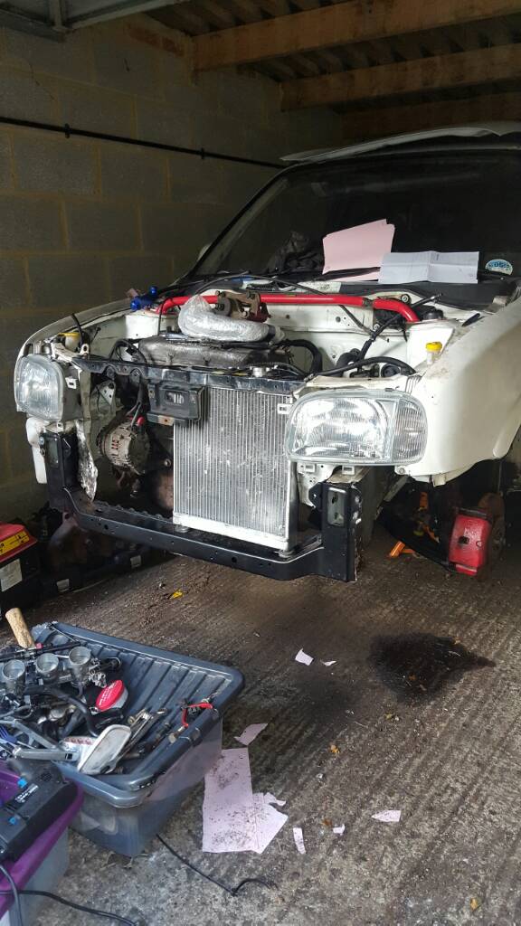

I bought myself an engine crane and started ripping out the heart of the micra.

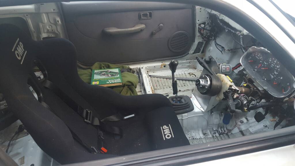

Theres currently no ecu. No loom. No dash and no interior. Just a blank canvas waiting to be removed of its innocence.
No headlighrs. No grille and nothing holding in the engine but two mounts.
The primera is my mobile garage on wheels right now... but its being demolished too... no dash or clocks (after fighting with the little sods for an hour) theyre oot
Just need to remove one bolt on the passenger side and a rivet from the heater duct and the whole dash will be removed.
Then i can get on with dismantling the front of the primera and removing the cg13 from the micra.....

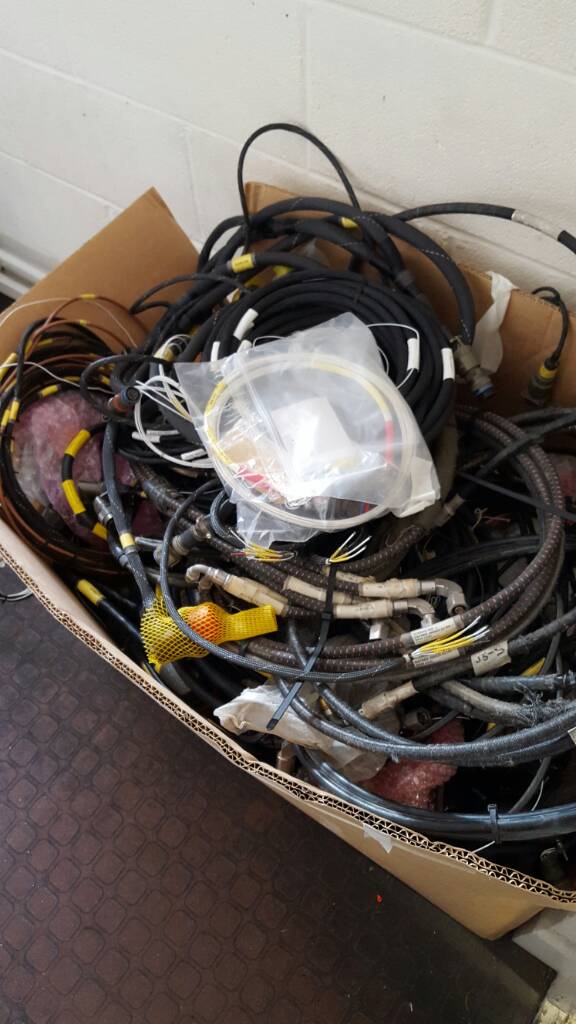

Last picture is a mistake..... box of raychem aircraft looms for the chinook......

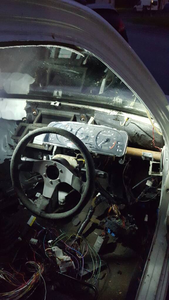

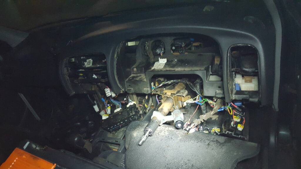

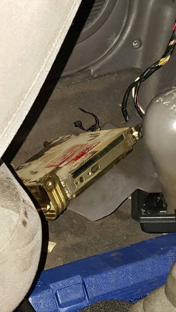

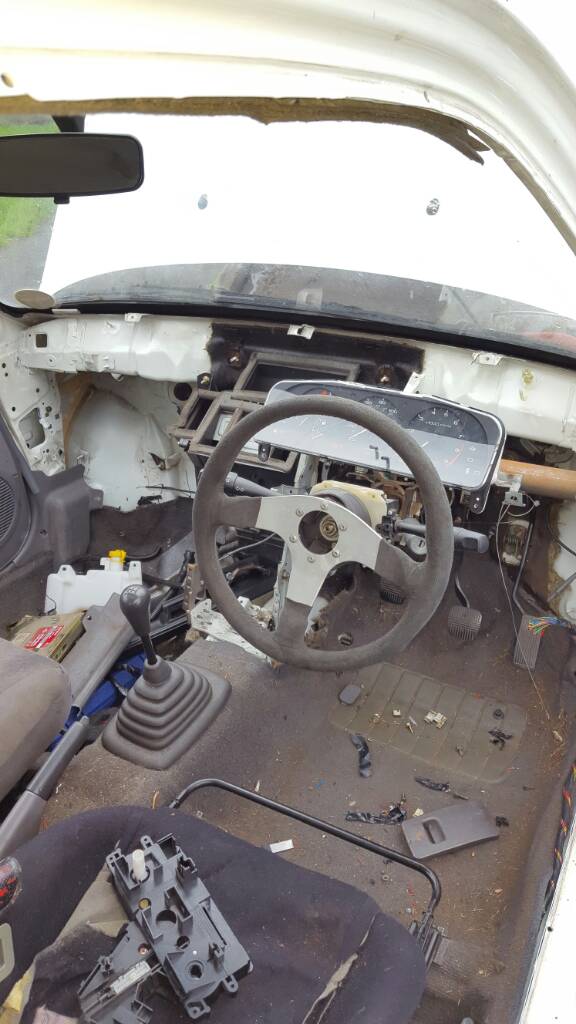

Not much done today ... its cold n wet..

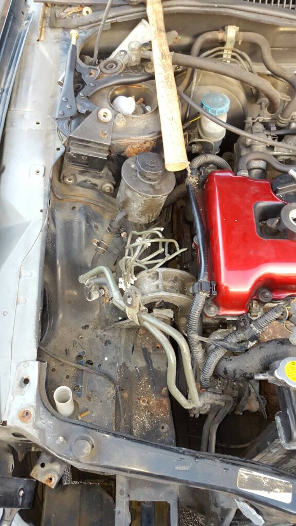

But. Got the dash out of the primera and liberated the clocks and ecu....
Next to tackle the frigging engine bay mess... eek.

Indeed... its not 100%. But certainly not a cripple anymore...

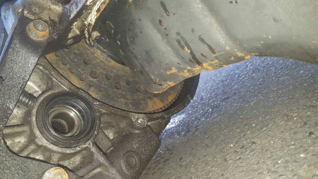

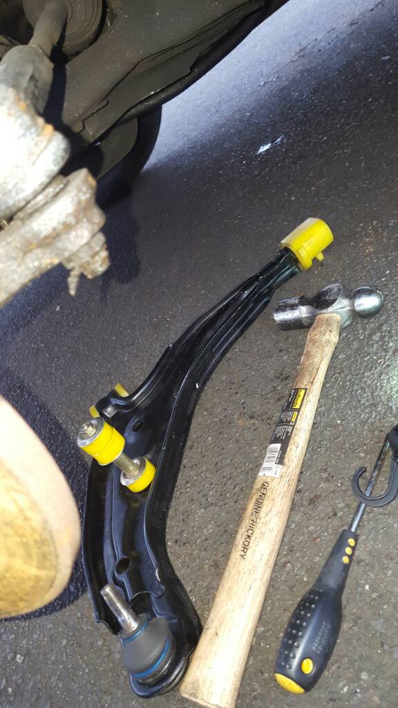

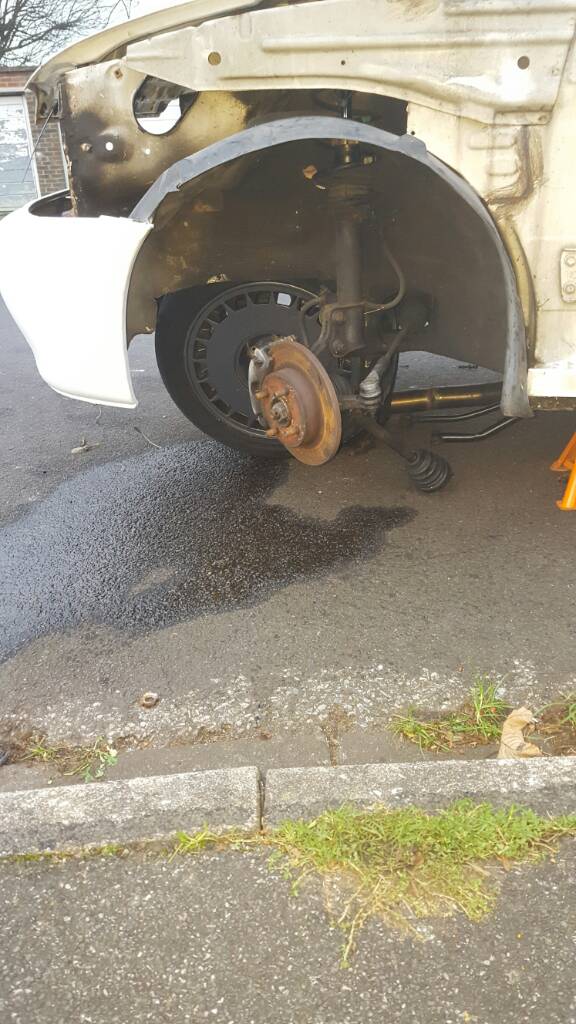

Poly bushes. New arms. New ball joints. Shafts fell out of the cvs...lol.. ready to remove tomorrow...

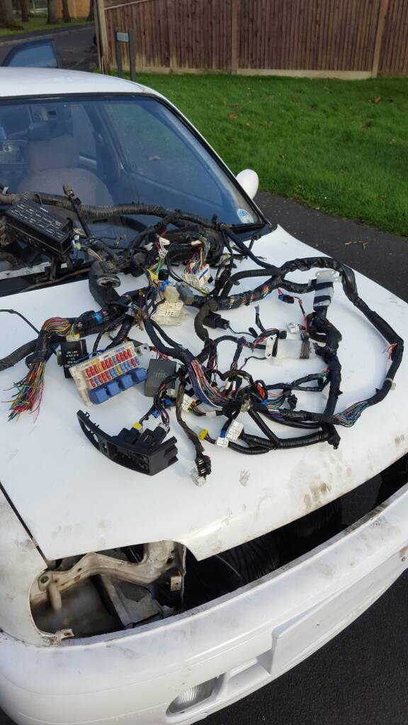

90% of loom pulled from primera. Bloody thing... had an aftermarket alarm bodged into every orifice.. traced them back and cut them off at the source.
Every plug im not going to use such as leccy windas and mirrors. Central locking and stereo crap.
Was a big job.
Also took out the airbox and battery tray to get to the rest of the loom....
Then pissed it down and im almost ready to take off the wings to pull the loom through the bulkhead...

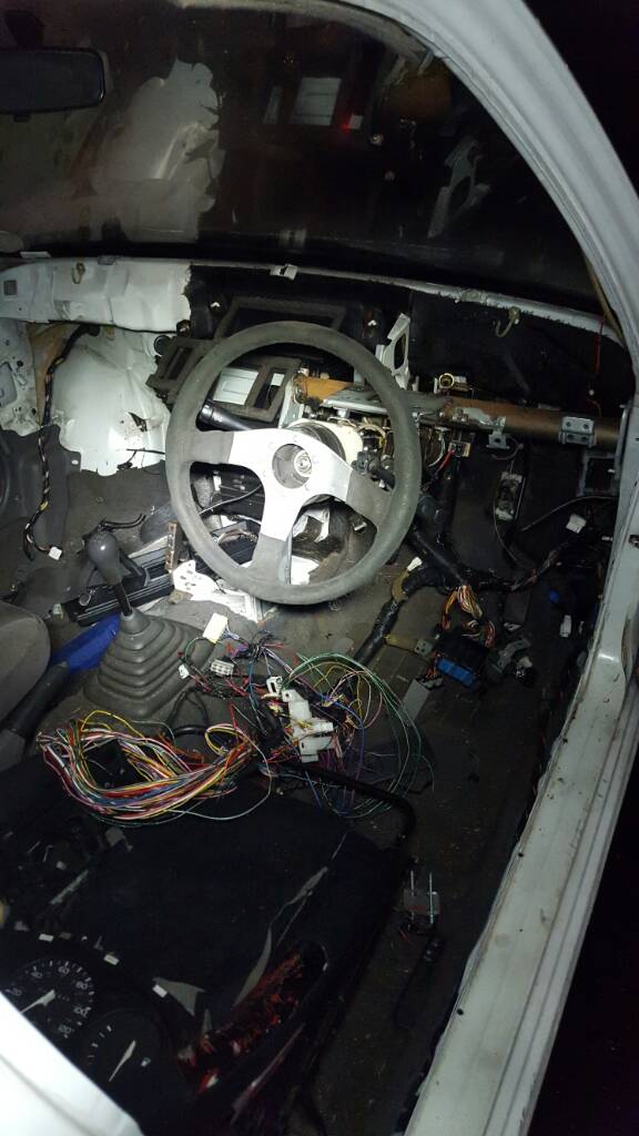

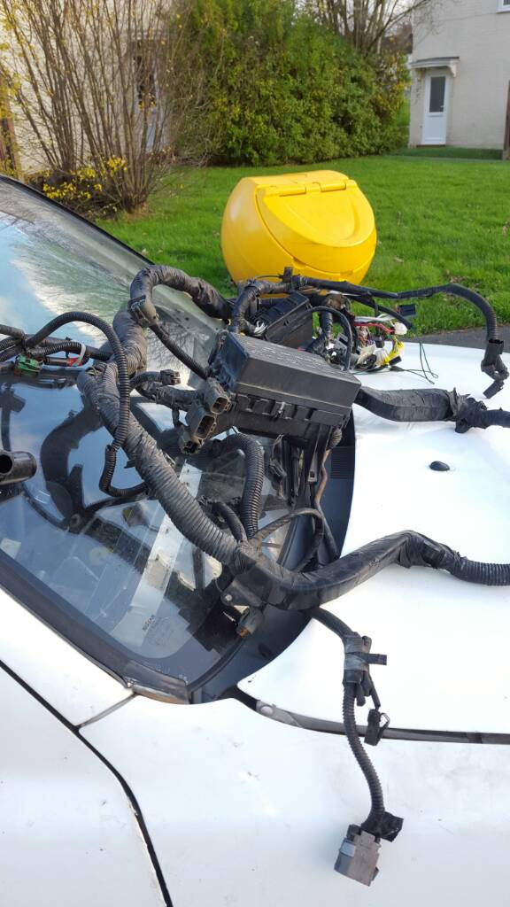

Loom is out of the primera.
Man its about 400 times more complicated than the micra one.
This is going to be a mission just to sort out where everything goes.
Theres abs wires. Central locking. Aircon. Power steering. Leccy mirrors and windows. Fog lights. Electric adjust headlights. All the warning light systems etc......... its all gotta be stripped down to the bare minimum...
Sent from my SM-G920F using Tapatalk
Ive found crank angle sensor. Rear lights and fuel pump so far aargh.. .
Its a case of laying out the loom as it was in the car and going through wiring colours in the haynes. Cutting off the connectors you dont need like abs. Central locking. Speakers. Electric windows. Alarm. Etc and tracing them back through the loom..removing everything they connect to.... relays and fuses etc.
Easier if you can leave the switches and gauges plugged in. Everything else is just investagating.

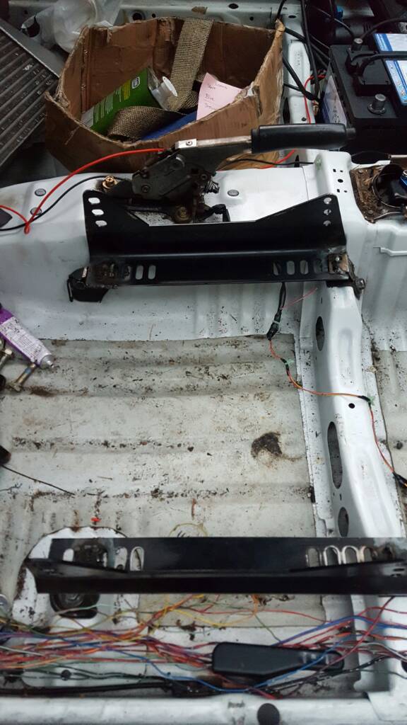

So for the rear of the car i will only need rear lights that include side, brake, indicator/hazzard, number plate, reverse and fog light wiring and the fuel pump.
Everything else beyond the dashboard is scrap.
The front will require,
Brake light switch. Headlights and relay for high/low. Indicators and sides. Wash wipe. Engine harness. Ecu power. Ignition and charging curcuit. Gauges. Switches for fogs and hazzards. Stalks. And finally fuses relays and consult
All else is surplus

I cant believe how untidy the stock loom is..
Never heard of wiring husbandry obviously..

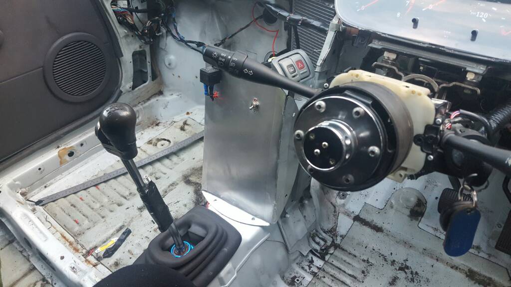

Need to take the angle grinder to the steering column. To remove the lock barrel and the three welded tabs that hold the stalks on.
U don't mate just get a doweled pin on them 2 holes and hit it with a hammer
Oh yes it is.

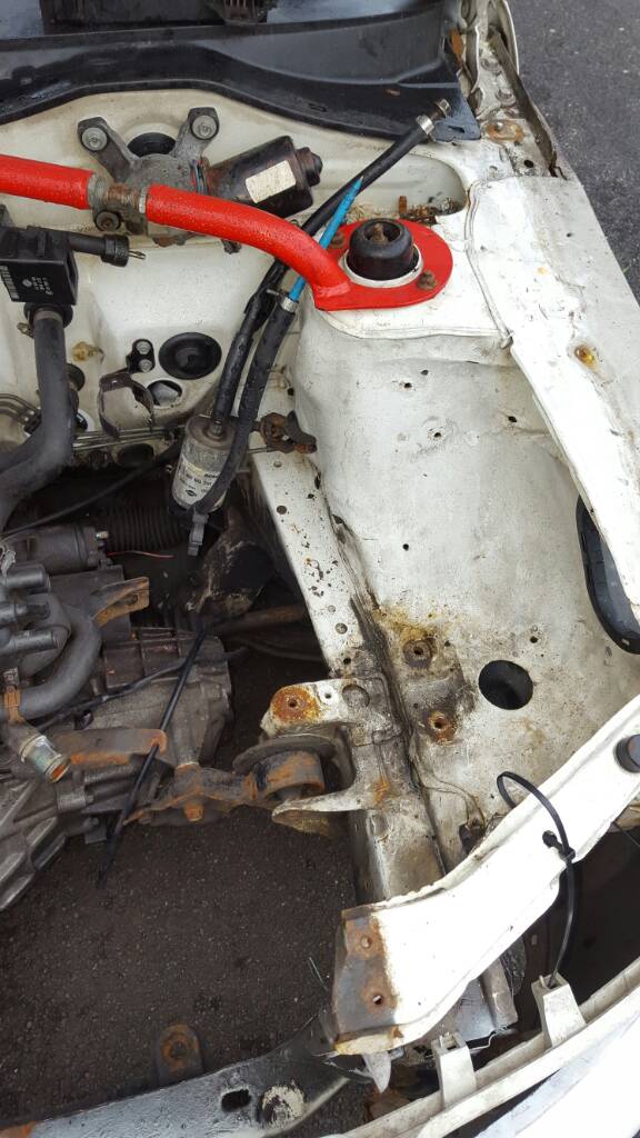

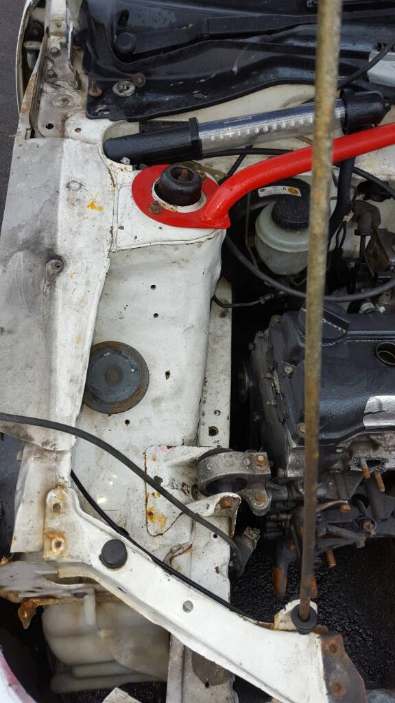

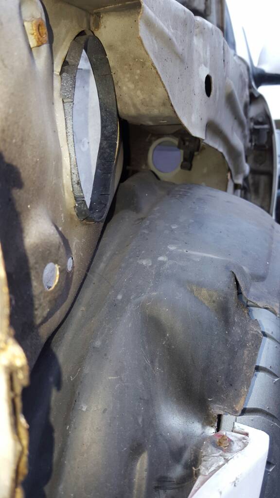

Got some tools and a sheet of 1.2mm steel... gonna reinforce the wobbly bits in the bay. They might not look 100%. But theyre not going to deteriorate any further.
Got a set square. Steel rule. Xmas tree drill. Drill bits. Multimeter. Sharpie. Flap wheel for the angle grinder. Centre punch.... and lots of time after xmas.
