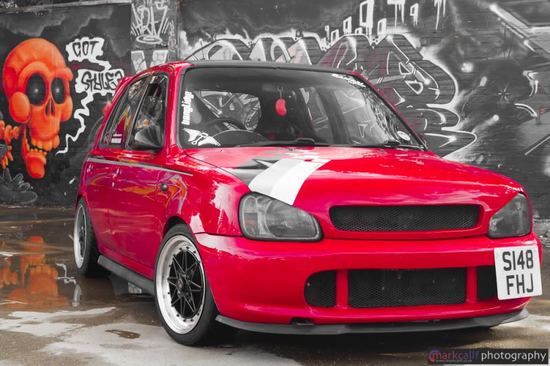

A friend of mine is thinking about getting some wheels for his K11. He knows i've got aftermarket wheels on mine but needs some reassurance about this particular fitment.
Mine are Front 15x7j ET40
Rear 15x7j ET30 (10mm spacer)

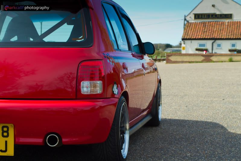

Trying to find a photo of the back wheels (like the front pic) is difficult,but you get the idea.
I havent had the arches rolled,but slightly stretched tyres have helped. Not sure if an extra 10mm on the backs would be too much?
Mainly aimed at Mark as we all know he is the club's wheel whore :p
Nice one bud, I would say an extra 10mm should work but might get the odd rub now and again :D

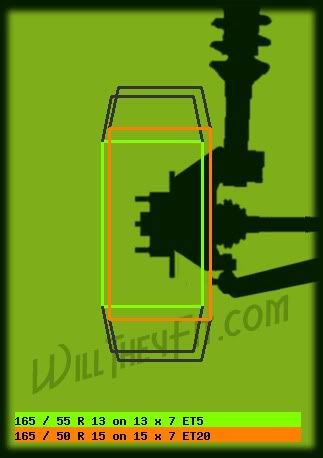

So your wheels are et 40, and the new wheels on yer pals car will be et 20? Looks like there would be clearence to me - a bit of a heavyier roll on the back or dont use the spacer, and a little camber on the front should see it clearing. What size tyres are on yours? could the lower offset wheels have 165/50's to tuck the tread a little more?
Loads of clearence even if the wheels gain a little poke! If the wheel needs to loose a bit of radius there's even 165/45s but I don't think they look quite as good as the slightly taller profile.
Afterall plenty have run 7's with 5mm and McZ has got away with -7, all be it on 13"s (not that that makes any difference to the offset) so I recon it can be done.
