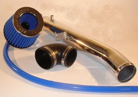

while the cars's off the road having the exhaust made/welded, i thought i'd order one of these micra fitment intakes. hopefully this will come in time for the rolling road session in december. :)
very nice! like that alot! why u changing setup?
because i only have a standard airbox and filter on atm. my other cone filter just sat ontop of the throttle body with a cold air feed. not the best set up.
and after reading about micra_charge's 'tuned' length of filter intake, this sits in about the same position as his/retepetsir's.
how much did that intake cost out of intrest?
£56 delivered brand new :);)
