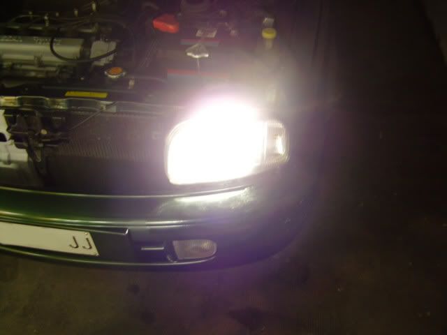

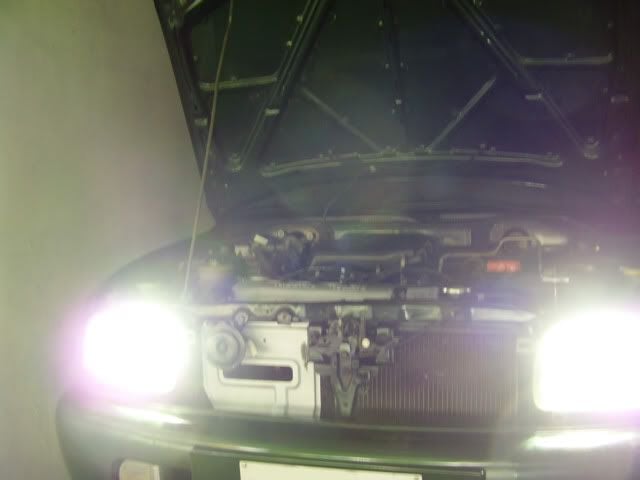

just fitted in the afternoon, really easy to do ;)

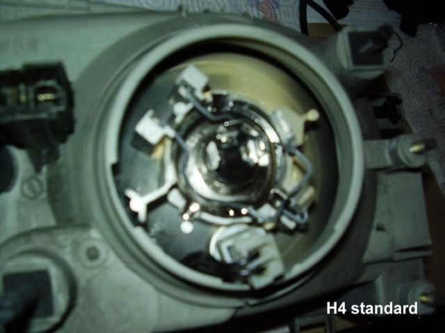

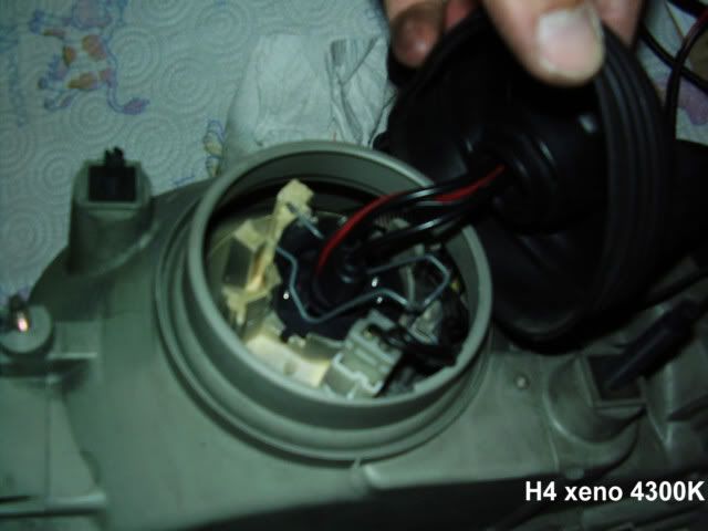

take out old bulb and take in new HID bulb, it fits exactly the same of old one, you must put all cables and connectors that has HID bulbs in the middle of metallic clip so you can close clip and bulb is fitted, now take the protection rubber and put the same cables/connectors of HID bulb in the centre hole of rubber, you made this with care and patience, hole is little for connectors but at the end all goes with no problems (I fit philips white w5w bulbs and new blinker bulbs also)

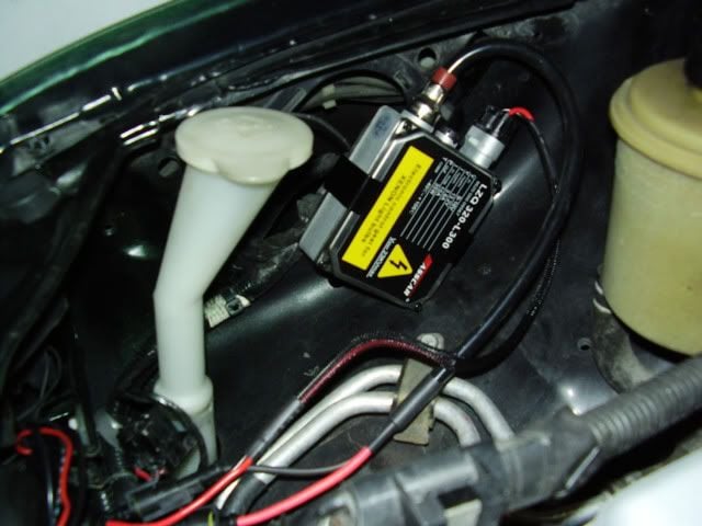

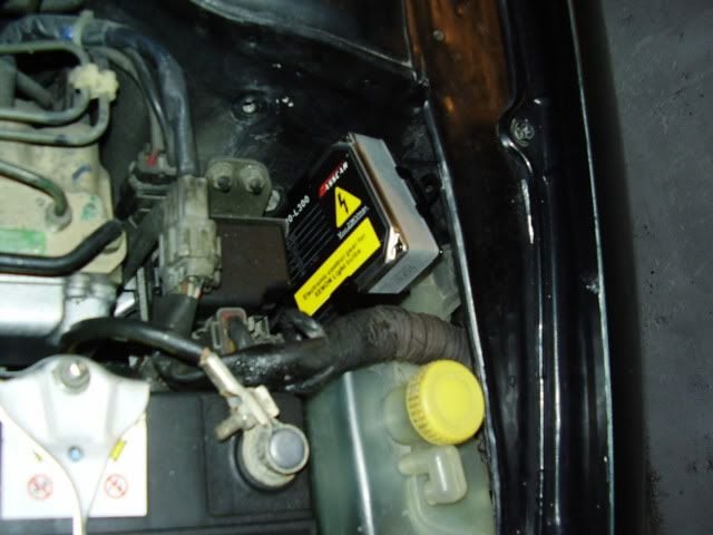

now choose a place to fit HID-unit, I found in my Micra on UK driver side a hole in which I put a 10mm bolt like original micra bolts and on UK passenger side I put unit where before there were original air induction tubes/hoses
before fitting units in your engine connect the 3 wires unit-bulb and then fit units

They look very bright!
hehe...there's been many a time while driving on A roads that you think someone is still on full beam, so you flash them....only to be blinded by the xenon's they flash back lol
there is bright...and then there is xenon
