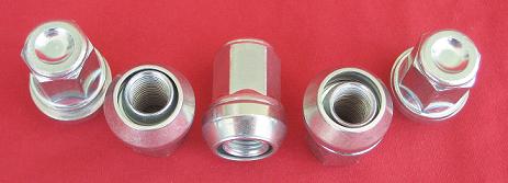

Wobbly bolts sounds not so good for holding a wheel on!
you wont get away with wobbly nuts as the differance it too big, to be able to use wobbly bolts/nuts the studs need to at least go through the wheels but they wont even if you opened the holes out,
option 1 use the hubs off the car the wheels are off (not really an option i know)
option 2, buy or get made a set of hub adapters, probably the best way but will cost alot, and as there will be a lump of metal between the wheel and hub it will totally mess the offset up.
option 3 sell them on.

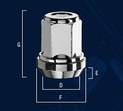

Wobble bolts can only be used to take up about 1.5mm per stud, so you would not gain enough to use the 4x4 1/2" (114.5mm) Wheels.
They could be used to make 4x4" wheels fit 4x100, or even 4x98 fit.
They MUST be used with good center location, because the wobble nuts/bolts do not offer any centering. This is because the tapered washer is free to "float". So you would need to get steel spigot rings turned to fit wheels with a larger center bore, or get wheels machined out to fit the centers.
