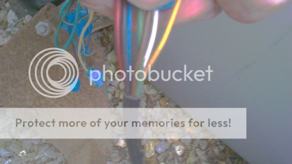

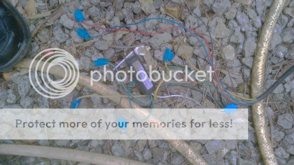

Hello 3706. I have a tow hitch for sale on the for sale forum, I know you have one, but the picture on there shows the wiring buddy.
Have a look and see if it helps, if not I can take some detailed pictures of it for you - let me know mate.

Hello again. Go to the top of the page, click on forums, scroll down to for sale - bang - you got it.
I'll take a few pictures tomorrow for you, and post them up buddy.
Top bloke Davyboy. I found the ad in the end ... thanks for pointing me the right direction. Can't quite see the wires well enough to make them out reliably .... can see the splice to the car loom but if you could do me a pic with the wires a bit neater so they can be seen that would be great.
Appreciate you taking the time and effort. Always get a bit jittery when it comes to car wiring :)
Here you go buddy.
Davyboy thanks very much for the pics...apologies have been away so slow replying to messages.
Thanks for taking the time to find this for me. Later week I'm going to have a crack at the wiring.
And thanks to Graeme P for help as well....will report back with how it goes to you and then hopefully it helps others in the future.
