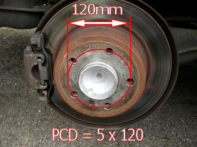

ok, well PCD is the bolt pattern as you probably know
PCD

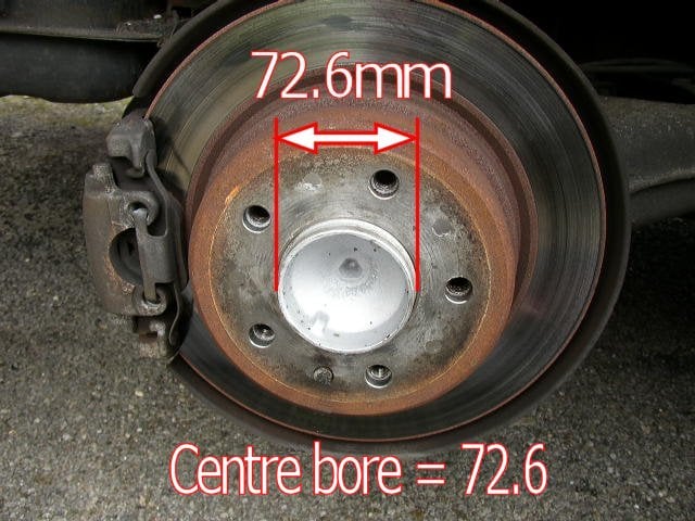

Centre bore is where the hub goes. Micra has I think 59.1mm which would me the wheels bore you after to small.
Centre bore
