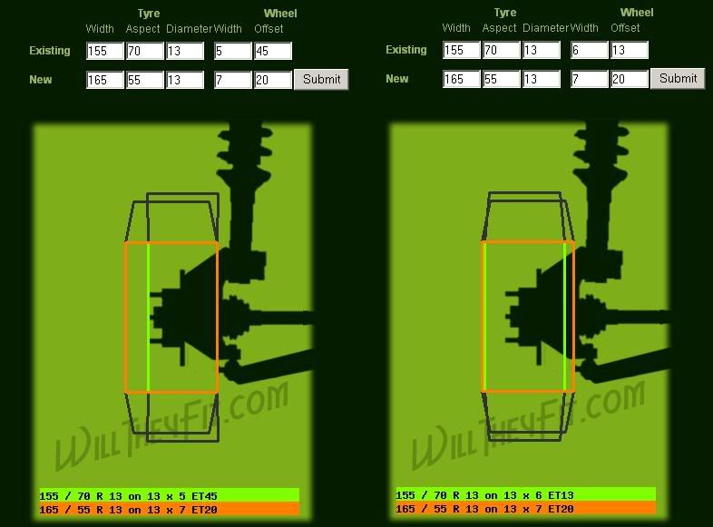

I recon that with a bit of fettling to the arch you will get 7x13s under the front, if they have an offset of about -20.
Here's why:
The left hand side shows a standard 5x13 wheel with 155/70 tyre, and a 7x13 wheel with a 155/65. The right hand side shows the same 7x13 wheel and tyre combo, with my current 6x13 155/70 fitment, as you can see the tyre outer edge ends up in about the same place only with a slightly smaller rolling radius, here's what my fitment looks like in real life,
Obviously the simulation cant be relied apon but I rekon its a goer. Got to be worth a trial especially if you know a dubber.

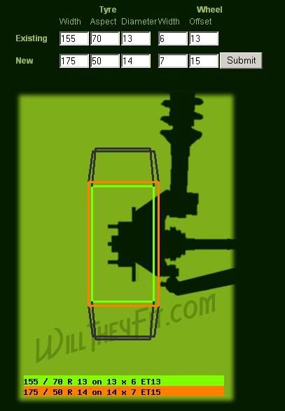

Its online, www.willtheyfit.com its a modification of an earlier dutch excell spread sheet that has existed for a few years, but is know to be not so accurate with the stretch. This one is supposed to be much better. I believe the stut is VW golf or polo, but might just be a generic sort of strut shape.
yer spotted the watermark in the screenshots just after i hit reply, looks really good, i know what im aiming for now, im getting banded steelies, 13 j7 et 20mm

Looks like the -15 7x14s might fit under stock bodywork with some "encouragement" to the arch lips, and some expensive 175/50's.
