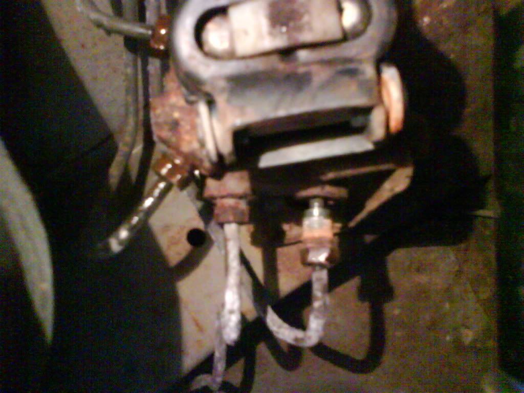

the seals frank mention'd? go ahead here are the pics. clean reservoir fluid turn dark after? anyone had this
wet unions are the "in" from servo

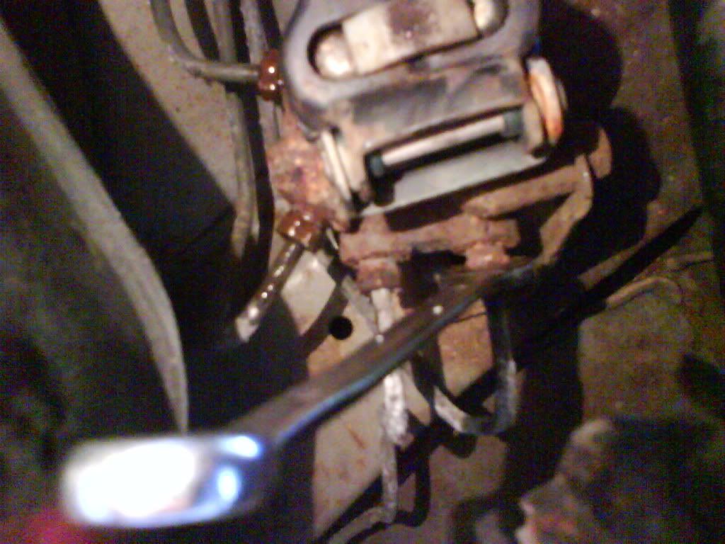

rear left union. all i did was pump the valves in out with plyer and bled some more,,,,,,,,,,
rear left dry.pump'd the break some more more more much more and it started bleeding. brake fluid in reservoir was
clear but after the thing unblok'd it turn'd mury dark in their?? black rubber seal color?

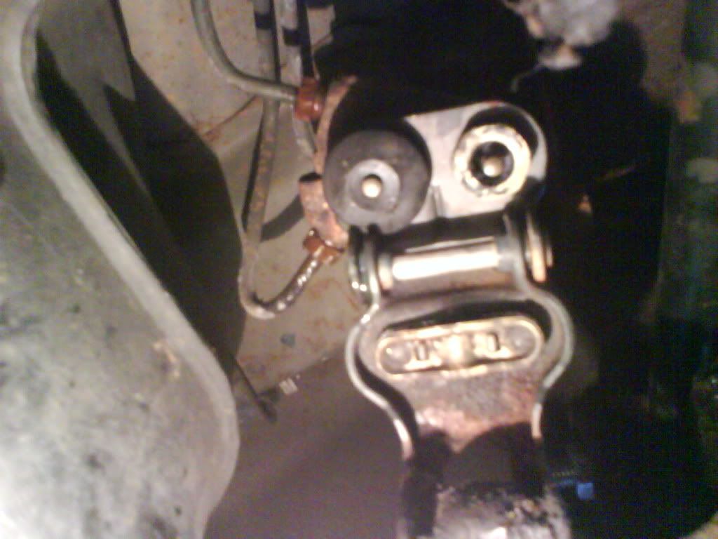

one rubber boot off one valve

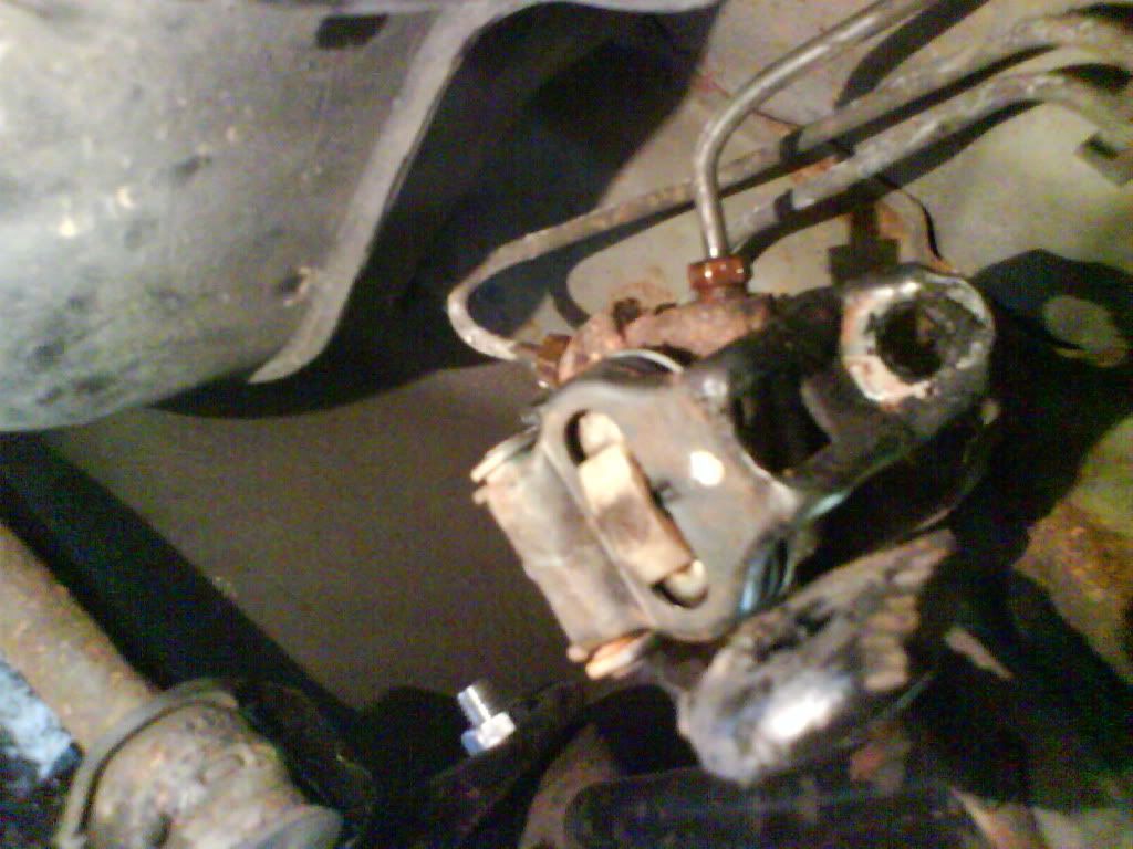

spring compres'd
looks like this now,,is it right?

it should only be clean fluid in the system. so it flows out no probs now? so it should be pumping the fluid 1-way out the exposed nipple. i'd keep topping up & bleed via the rear calipers till the reservoir clears.
so was the bias device internal valves sticky? they can be taking out by unscrewing the cap with a socket n clean the valve.
no need to ziptie the spring like that if ur keeping the shaft. u just need to make sure the car weight is fully resting on the spring (rear axle resting on axle stands), and tighten that nut on the spring shaft till the bias valve arm dips a mm so no load is pressing on the internal valve plunger
i was pulling them valves down with plyer ,,they were returning back up
got fluid out the rear left nipple, one man job so couldnt say what was going back up nipple
no thread on shaft to screw down further
ah ur susp was lowered alot yea? ok u ziptie it slightly between the bias swing arm and the lower spring mount where its bolted to the trailing arm till the swing arm dips slightly at rest
alright the valve swing arm is 1-2 mm off the valves ? at rest (not push'd up fully)
sorry forgot to mention lowerd
yea long as that arms not pushing on the internal valves. at rest meaning the jacks removed and chassis resting on springs with rear axle on stands for access
ok right now its too far down, fronts are locking up first though as they are now maybe to quick or disc's are dirty------------------visible pad contact on rear discs
