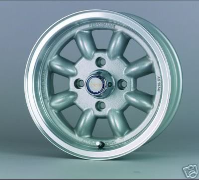

sorry for my terrible knowlege of rims and tyres but i was wondering.
Will minilite rims and tyres fit on a k10?
(mini rims)
also what are weller rims like? and would they fit

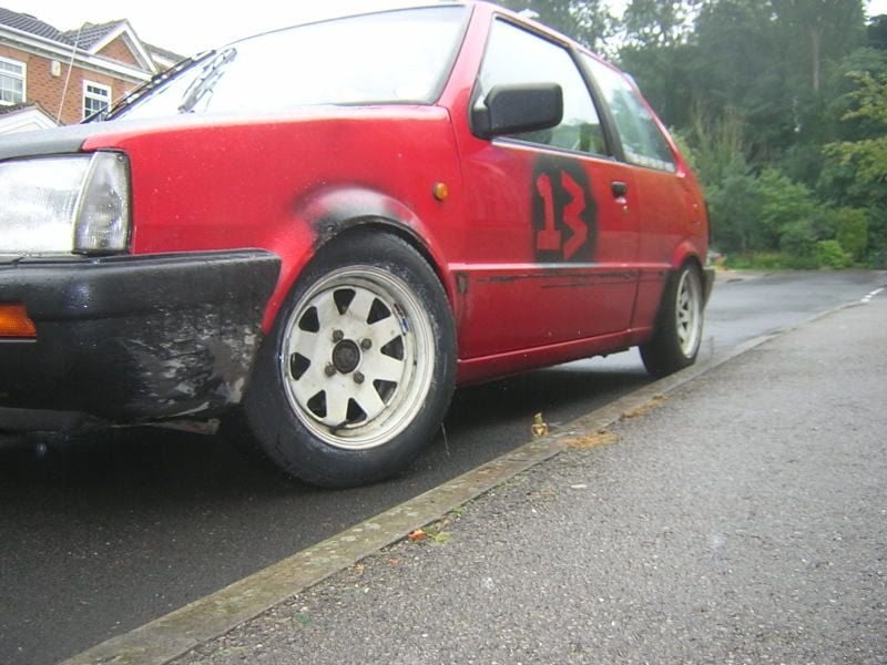

mini wheels doooo fit on micra's

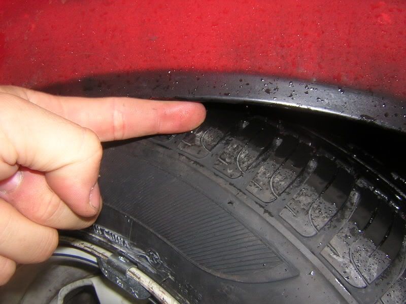

the pcd on them is 4x4" (which is mini pcd) which is near bang on. But with the nuts off you can see the studs sit to 1 side of the hole (ill get a pic tomorrow), but I just did the nuts up really tight and its all fine. I dont know if this will work on alloys but they do on steels.
they turned out to be a nice offset aswell
