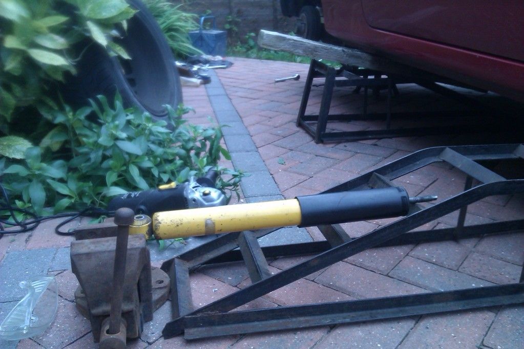

the corsa bottom bolt is 10mm joe, k11 is 12mm
Right so whats the best idea for using corsa shocks then? If i just use a smaller bolt they'll be loose at the bottom wont they?
drill the sleeve or whack the 10mm bolt upRight so whats the best idea for using corsa shocks then? If i just use a smaller bolt they'll be loose at the bottom wont they?
drill the sleeve or whack the 10mm bolt up![]()
nah, use a 10mm bolt and nut, and whack it up tight (80nm ish)just push it through? would it still bolt onto the thread after?
WEST SIDE IS DE BESTEast side iz de best!!
You,re just clamping the bush as normal, but making sure that the 10mm bolt does,nt move about in the 12mm holeand that wont immobilise the shock too much?
I have an injector flow tester/cleaner here at work![]()
So when grinding them in (cause the bushes are wider) ive gotta make it still a pretty tight fit then so theyre tight to clamp onto...
might try drilling them out, got no pillar drill though and by hand is risky dont wanna ruin them

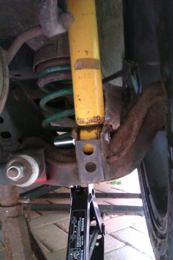

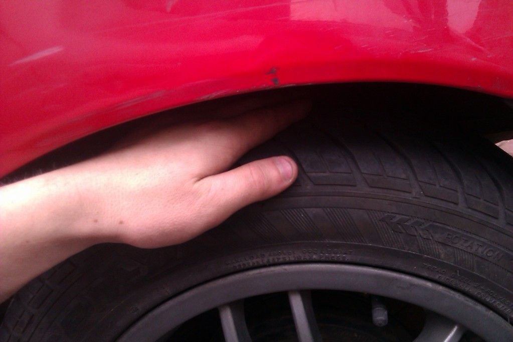

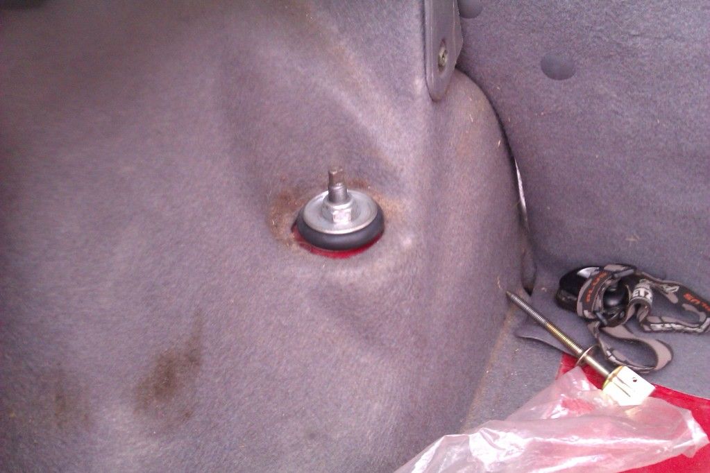

Discovered that my springs actually support the car higher than the maximum shock extension so i now have preloaded springs and a lower rear ride height than beforehad to put all my tools in the boot with me to bolt the top nut haha
aye, thats a lot of preload if its lowered the car ! we did it on a mk2 escort once, and it handled great on the oval (was megga jittery in the unsurfaced pitlane tho lol)This isn't good! It leaves the suspension with no ability to drop down into a hole in the road. At speed your tyres will be leaving the road at the top of every crest too. It also leaves no ability for the rear of the car to roll normally. You need to cut or swap your springs so you have some 'droop 'measured from your ride height.
