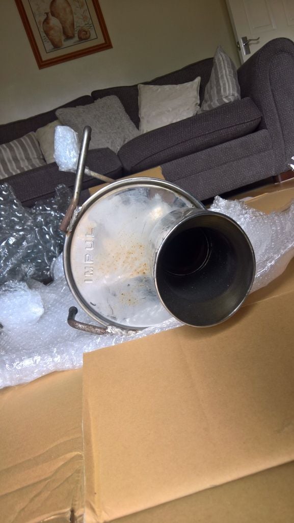

Complete exhaust system from down pipe to back box and new windscreen :) could have got another car for the price but I like this one,,,,, it's mine

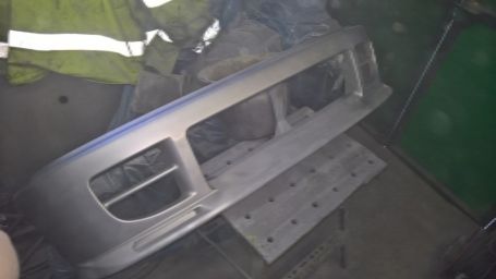

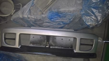

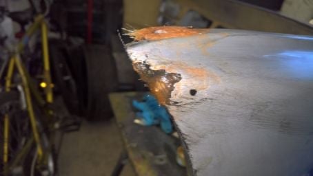

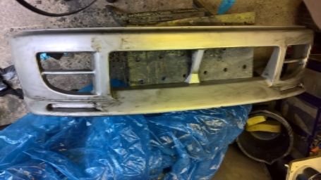

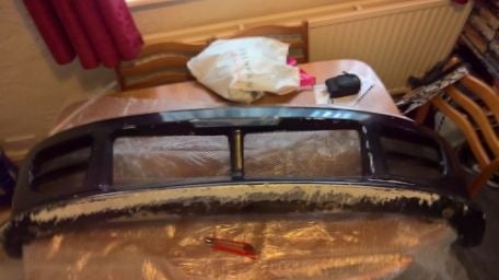

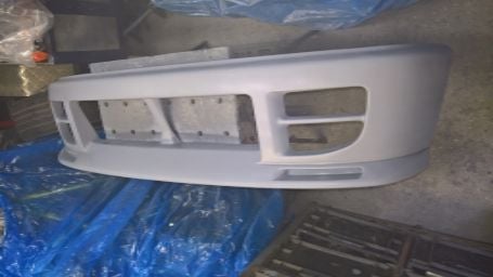

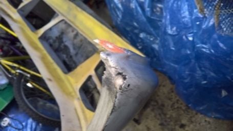

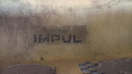

Monday I received my genuine Impul front bumper :D which then saw the metal mesh and paint being stripped off revealing the original silver paint
Tuesday saw repairs being made to the fiberglass and reinforcement added to the drivers side mounting hole.
Wednesday was paint prep, 80 grit all over and shaped body filler. Followed by 180, 320 and 500 grit, then primed.
Thursday, 800 wet & dry followed by 1200 grit wet & dry. Then colour passes started, starburst silver (colour matching)
Friday, masked silver off and painted matt black then lacquered
Saturday, fitted. Wasn't quite a quite as simple as take old off and put new on. had to make a new bonnet latch support that doesn't go all the way to the lower crossmember and due to the curved nature of the 2nd facelift headlights 5mm had to be removed from where it was hitting.
Just got to get some cai mouldings for the top outer slots so that the weather doesn't directly hit the lower crossmember
