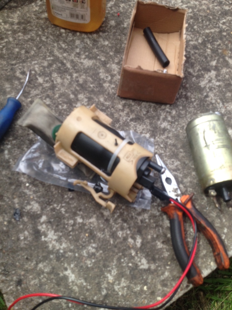

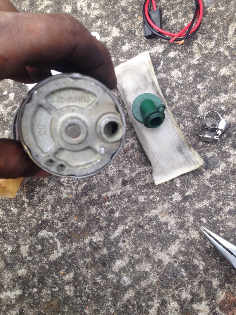

Please tell me you are going to put some heatshrink around those wires!!!fitted a pulsar gtir 255 fuel pump it was slim but got packings on and tie wrapped it, new wires fitted all in tight in tank
Yeh it was heat shrink that's a old pic it's all in tank and tape was off just rechecking thanksPlease tell me you are going to put some heatshrink around those wires!!!
one spark and boom!!! they are in the fuel tank after all!
Also I wouldn't be tempted to use insulation tape as the petrol will just dissolve the glue. ie I think you'll have de-solder your joins to put some heatshrink on.![]()
