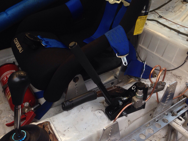

Phew, hydraulic handbrake is installed in the rally car too!

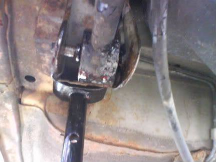

Dropped the axle but could not remove because the ABS lead was very difficult and was too tired.

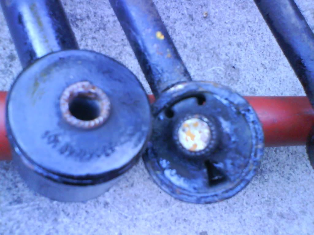

ABS sensors won't budge from the plate is always the same. cut and rejoin is normal i think.
1-don't damage panhard rod stub
2-1 dont damage body/she'll mount points.only cut grinder bolts of control arms
3-1-2?? lubricate seized bolts once arm is removed.try save arms by bashing remaining bolts out...12mm socket under bush and bash from top
