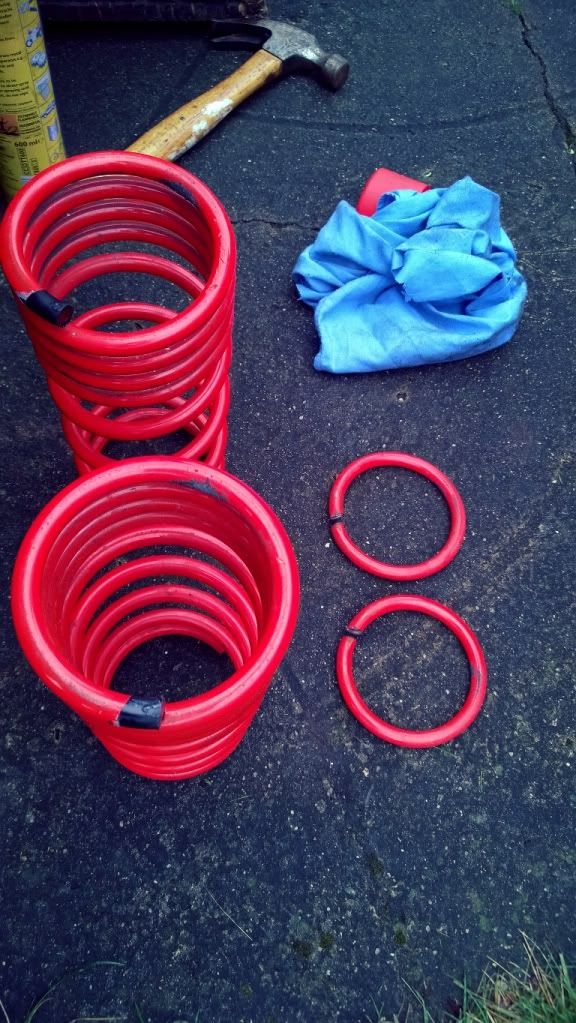

Right....I think I've found the reason for my uneven rear arch gaps...I swapped the springs and shocks to opposite sides and it still happened, low on the right, high on the left...so the only thing it can be is the link arms...so I checked and the right side I can lift up and down easy but the left side gets harder as it moves up...you know the feeling of pushing against a rubber bushing...anyways, I thought I could just undo them and free them up but the bolts are all rock solid....so I've sprayed every bit of every link with grease and left it for a bit...hopefully that'll sort it....
Angle grinder :p x
