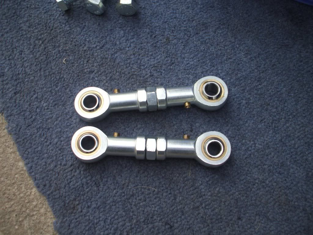

- Found the rear ARB drop links were totally knackered, the stone damage had damaged the seals and they were full of mud and would hardly move at all, on one side it caused the plastic housing to melt due to the heat/friction!!!!
- Removed both offending rear drop links

- Fit rear drop links
