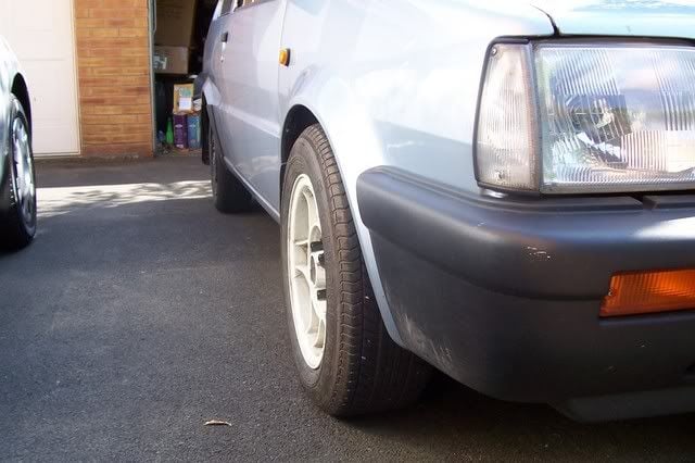

heres a pic of 30 offset 13" wheels, -35mm spring and 185/60/13 tyres.
no scrubbing on the front, the rear isnt lowered yet.
they are only 13's tho :)

Looks quality that, the gaps are perfect! Ive got 185/65/14 on standard suspension and they scrape with 3 of us in it down small curbs.
