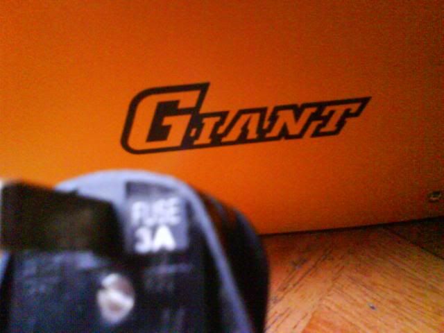

came with a 3AMP Fuse in the plug
house plug point now had it on a extension cable before
welders say it has the overheat cut out built in,but ive only stroked the rod twice and it blows fuse
trying again now,one moment,,,,,,,,,,,,,,,,
R-reg, even a small welder needs to plugged into a high quality, properly wired 13A socket with NO extension lead. They draw a heck of alot of amps and anything less than a perfect socket will tend to blow the fuse or breaker at the drop of a hat. Also, until you get a lot better, ditch the 1.6mm rods for the time being. Even 2.5 are tricky. I tend to practice with 3.2mm rods running at 80-100 amps using 6013 rods :).

changed fuse too 5AMP from the 3AMP it arrived with.thats probably not wise so will 3AMP it when i get some fuses
plugged it into the house plug socket direct(extension cable before) now something good seems to be happening,,,,,,,,,,,,,,,,,,report back in 5 mins

it says in the listing that it should be mains fused with 13amp (same as mine) and not 3amp (no wonder it can't handle it)
read what the manual says in specs what fuse it should have.

3 AMP even has a sticker on

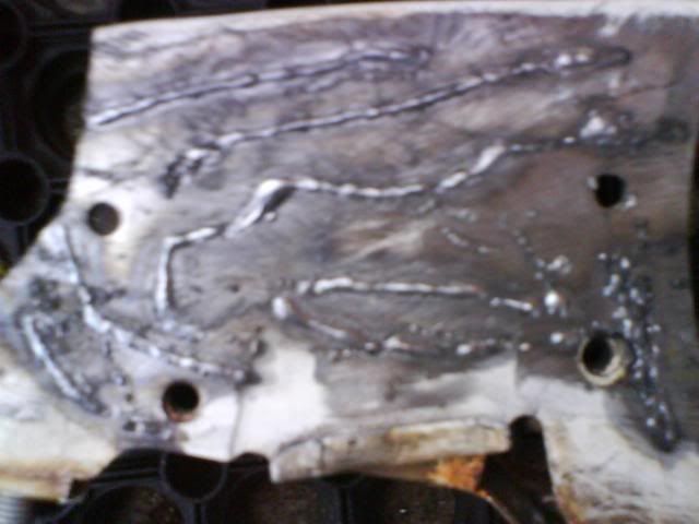

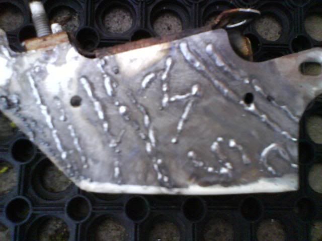

2.5mm mild steel rod
1.6mm mild steel rod

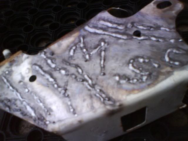

need practice i could have sworn this bumper support was damaged but it aint ,nothing a bit off grinding wont fix
now something i wanted to tell me mate all the time back in the day "oi get this slag off me":laugh:
thanks all , this may help other no-vices too
so far as i can see its a stunning little machine and will do for what i have in mind,but yeh the other welders are like finer suits:grinning:

only thing hard on this machine is the mask that came with it, and as you can see i just broke my welding virginity:grinning:
it can only get better with practice
yours looks neat frank

i think the fuse and sticker with the 3amp on the plug is given with the unit as a sort of lesson for beginners like me
haha i have the same fuse issue all i did is put fuse wire in the plug trapped it in with the fuse i cant remember what amp the wire is but i know its a lot more than 13A it cured it anyway. the welder i got came with a 13A fuse but just kept blowing it. i also found i blew as soon as the rod stuck to the work piece.

good ,i'll go with that

might actually see how the rod lays in and improve the stroke technique
i was trying to stab it in as it was moving along but realized it likes being stroked along gently with not any force at all,just as the friends like
Another tip for stick welding is SLOW DOWN A BIT. People tend to try and use them like felt pens :). You need to let the bead build up naturally. Also, keep the end of the rod barely out of the puddle. Also, if your welder starts making a loud noise like a 6ft wasp in a giant biscuit tin, your arc's too long :).
