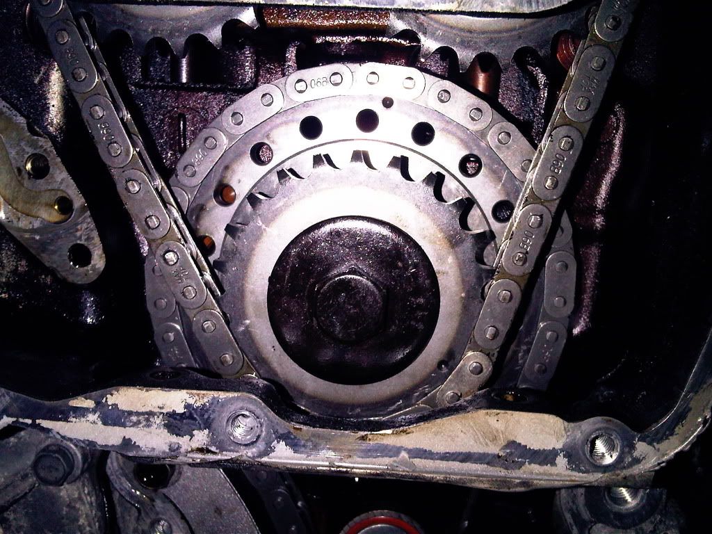

? I understand that part Frank. The crank is at TDC and I have the 1 coloured link on the dot on the large spocket (the double one) but how do I know what link to put the Crank spocket on if I have no coloured ones? Does it make a difference?
you dont need to worry about the coloured links joe, you just set that double sprocket at 4 o,clock and set the 2 top dots with 5 links in between them (or 7 links if you include the links above the dots) :grinning:

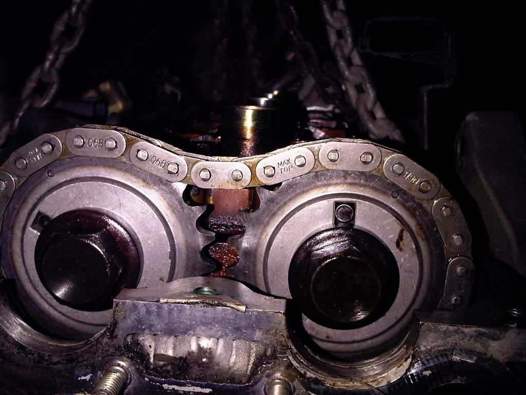

Think I got there thanks Frank, I'll take a pic and let me know what you think, good to have a second opinion before I put the tensioner in.

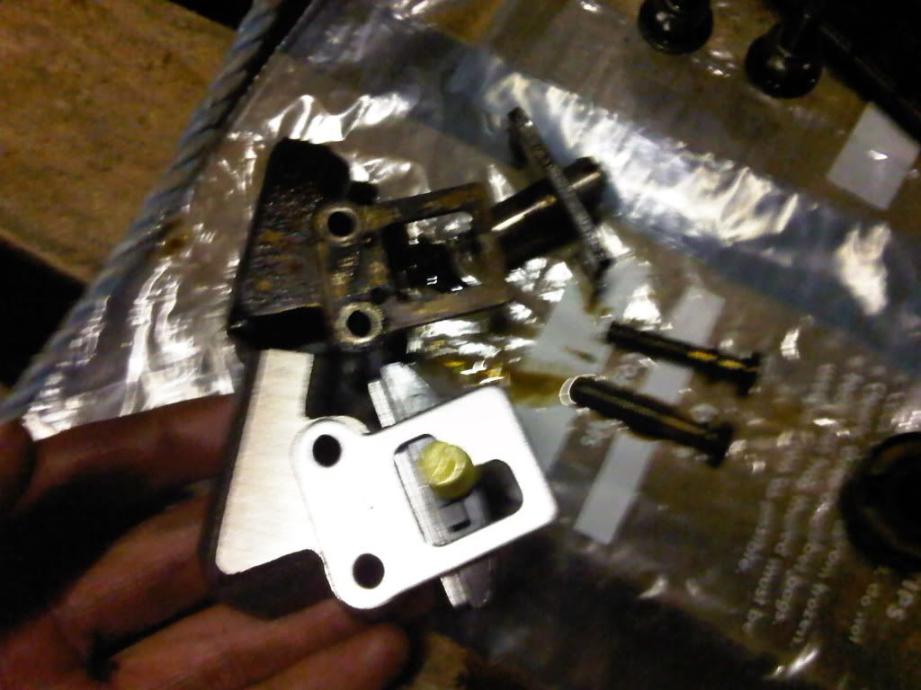

I'll post the pic in the morning, I'll also post a pic of the cause of the chain rattle. Wouldnt like to of run the engine much longer as it was anywho!
np joe, and if you,re using partworn chains or if you,ve had a 1 or 2mm headskim you can compensate for the cams being retarded by positioning that double/idler sprocket in a different position to the 4 o,clock in that diag.
in this pic you can see that the 2 top teeth line up on the 2 top arrows where the idler is set at 10 o,clock, where-as on the lower 2 arrows (4 o,clock position) they,re about 1/2 a tooth out

Ah i see, chains are new so the idler sprockets at the 4 o'clock position, everything seems to match up to your diagrams.
i posted some pics of the lobe positions in swordfish,s camchange thread from about 2 weeks ago if you want to doublecheck joe :grinning:

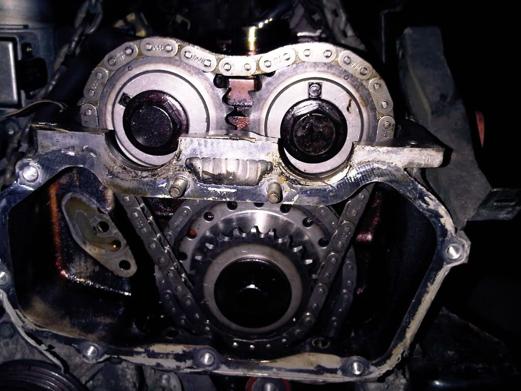

Had a double check. Everything look good to you?
And the cause of the problem
No wonder it was making such a beast of a noise eh! Im just hoping the rest of that tensioner is sitting in the bottom of the sump.
Isnt the chain a bit loose between the sprockets? i mean when you put in the chaintensioner the tensioner isnt gonna pull the chain auomatically to the left resulting in a bad timing for the inlet?
btw frank, the timing on your picture isnt right. thats the picture of my wrong timing. on the picture the inlet cam is one tooth off.
