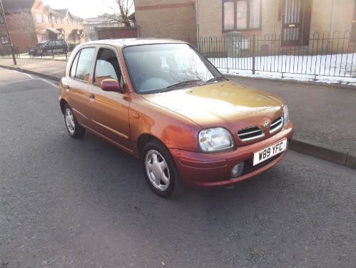

I have a jan 2001 March, 1.0, and its come with 13 inch steel wheels as standard.
Its not the very last K11 with the horizontal rear wiper but the one before with the larger headlights.
The discs up front are vented . I got the wheels off a UK Micra Si (1998) but they wont clear the caliper - the spokes are catching on the edge of the caliper and I will need at least a 10 mm spacer to clear it! I dont want to use spacers, besides the wheel studs wont be long enough either.
I wondering if my brakes are different being an import. The offsets are 45 the wheels are 14 inch micra ones like this
