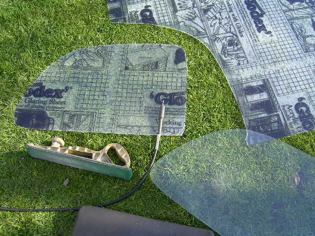

frank2 WROTE:
"xsoarerx<BR><BR>as in weight ?, iirc, about 1/3 the weight, its in my blog i think.<BR>i,ll post a link if the poxy server on msc gets sorted !<BR><BR>frank
thats a pretty good weight saving, and im sure that the acyrlic costs next to nothing, was it a special type you used or jsut some standard stuff?
