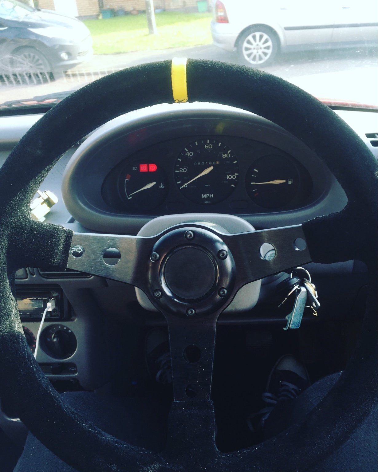

Personally I'm more about how the car feels to drive rather than chasing speed and grip etc so next up was changing things up for driver feel.
Got myself a racing steering wheel (budget but quality from McGill Motorsport I believe)
Also got a new gear knob which there's a photo of later.

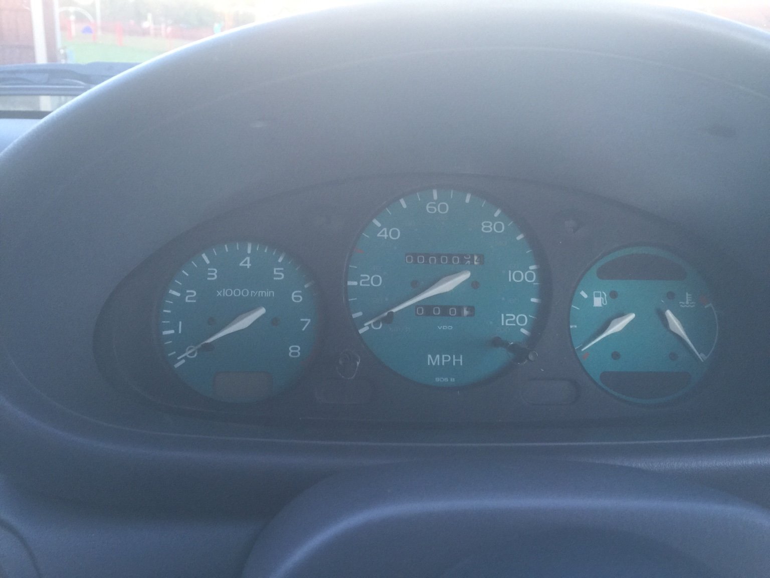

And fitted some tacho clocks:
