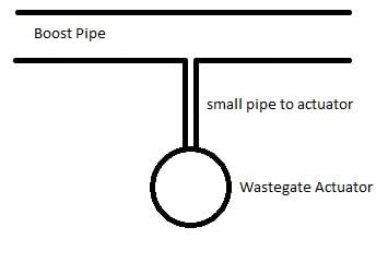

Hi All, i need a little help with a turbo/ need some new eyes on my idea to make sure im not being stupid and or going to blow my engine.
the turbo i need help with is a renault derived 1.5 DCI engine, but probably the same for mose derv turbo's
if i have the theory correct, the boost pipe obviously boosts, when it reaches boost X the waste gate begins to open, if boost drops below X the wastegate closes again. would people say this is correct?
p.s. im struggling to upload a picture any help, photobucket is blocked at work
well this is the pipework layout

yes thats how a normal pressure w/g works scott, but like neil says, many diesel actuators pull instead of push :)

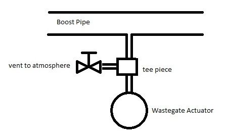

Vent a little boost locally to the waste gate to atmosphere giving the actuator a lower than actual reading thus more boost???
Or am I mad?

Right then well I've had a brain wave, see below
frank didn't we find that diesel turbo WG actuators operate in exact opposite (more vacuum = more opening) as oppose to a gasoline turbo (more +ve pressure = more opening)?
so even with the above layout, any +ve pressure will just close/push the WG shut and cause dangerous overboost. or if the actuator hose is not plumbed to prevent +ve pressure, so ur relying on actuator preload to hold it shut, the turbo still won't be able to operate at max efficiency

well the top picture is how its plumbed so i can only assume its boost controlled, as there will never really be a vacuum in the boost pipes as there is no throttle flap
yes the brake servo reservoir eh paul (a constant value) :)
hook a tyre pump or low pressure line to the actuator to see if it has enough travel to move progressively against increasing pressure (moves 1mm per ??psi)

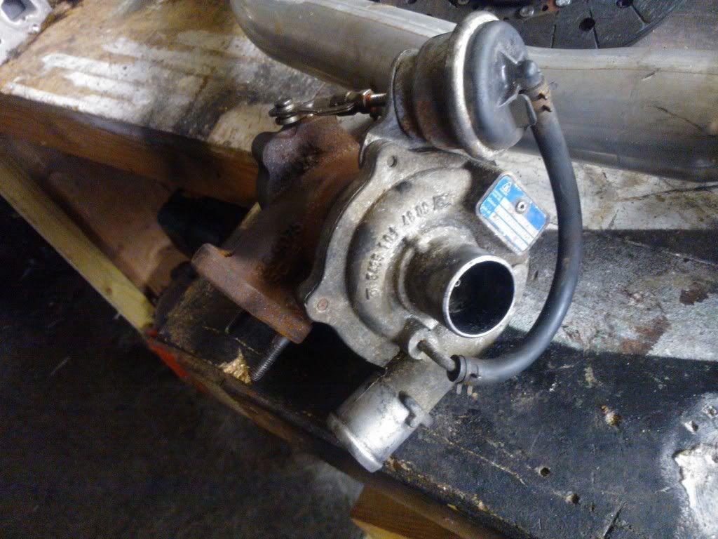

the turbo i have aquired from work a pipe that goes from the w/g actuator to the turbine housing so no vacuum pump needed i will get a pic if you like?
yea thats a +ve actuator hooked to the "compressor housing". I got confused when you say Turbine which usually refers to the hot side
ah crap. guys i realised i confused myself between a vacuum diesel actuator and +ve pressure actuator.
have corrected posts 15 & 22 :oops:
