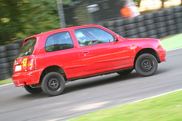

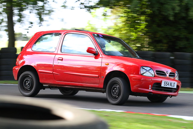

Just thought I should post some photos of the track day I did last September in the Micra:
Quite a lot of body roll...

Just a little bit of arch gap
IMG_4253 by FlamingBisonPhotography, on Flickr

All in all it was a good laugh, the Micra could handle about 6 hard laps at a time before something would start steaming/smoking and I needed to pit in (I was worn out after 6 laps as well, it's hard work trying to get any speed out of it...). At the end of the day the car was feeling pretty worn out and has developed a rattle/grating noise from the driver's side of the engine at ~760rpm, ~1550rpm etc. so something isn't happy but no idea what... Anyone got some bright ideas as to what it might be?
IMG_4297 by FlamingBisonPhotography, on Flickr
