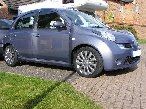

(Factory ride height)
(stock low profile tyres in this shot)

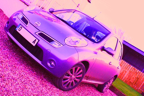

(as it is now)
I have put 195/55/16 tyres on to fill in a bit of arch and to make the ride a bit more comfortable on (pot holed) country lanes. I wouldnt say that I have noticed a great improvement in handling, it wasn't too bad to start with, but in my view it has improved the look no end.
