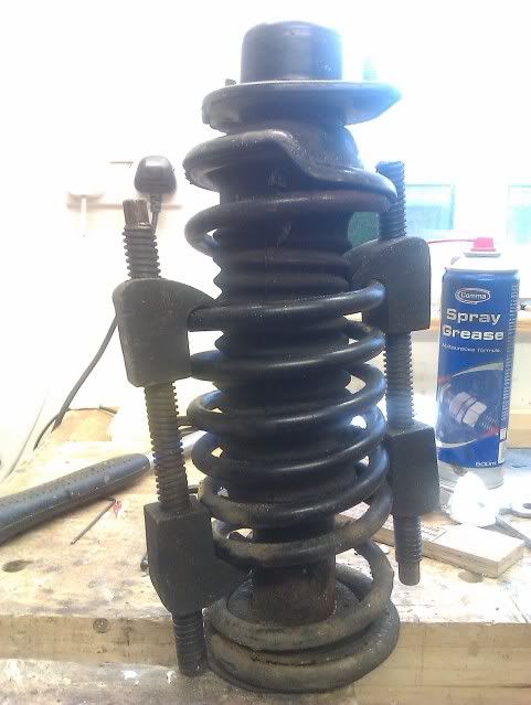

How do you get in there while it has a spring, compressors and the rubber around it? I just tried lower down, but the whole thing just spins. Also tried clamping the top mount but of course that just spins too.
i usually compress them an inch or so and lever the orange sponge bumpstop down tom, so that you can clamp the molegrips to the very top of the chrome shaft.

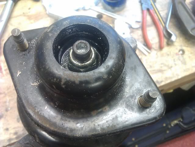

Here's the mangled top part
There doesn't seem to be anywhere on here that would hold the nut firm - or will the top mount come off the strut?
I hadn't seen your reply before Frank, but I've just tried it. Can't get any sort of grip on the chrome. Tried wrapping a cut up rubber inner tube round it as well, but it just mashed the rubber
you wont get any grip with rubber between tom, and it wont hurt if you mark the chrome under the bumpstop, just dont mark/scratch the working bit eh fwn (where the oilseal goes up and down, which is higher up when lowered)
just tuck the rubber boot into the spring and slide the bumpstop down, then clamp 1 or 2 molies on (Y)
