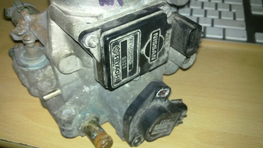

been doing a bit of tinkering with a throttle body.
i managed to grab one from a 1 liter today from scrapyard, fingers crossed there the same as the 1.3.
anyway after completely stripping it down and taking a few measurements i decided to 'chuck' the TB, no not in the bin in the lathe lol
heres a random inside pic
and this is the diameter of the chamber a puny 45mm
let the boring commence
stage 1
stage 2
did he stop there? no he didnt, after several passes
i personally dont think it can be opened up much more, things are starting to get a little 'close'
pic of the old butterfly in the new hole
the question remains should i make a new butterfly or just cope with a real high tickover??? lol
anyway then machined the throttle shaft a bit
fingers crossed it will mame some good gains???
a quick question whats the diameter of the ga16 TB???
cheers all
