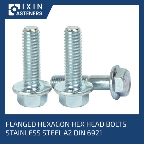

Been doing same with: M6 FLANGED HEXAGON HEAD BOLTS FLANGE HEX SCREWS A2 STAINLESS STEEL FULLY THREAD
No seperate washer needed, and flange 'plugs' moisture/corrosion on threads
Hi Mika, I used flanged bolts as well but 'mine' don't have the serrations under the head....
I added 20mm diameter stainless washers as they covered up previous damage/scratches to the plastic and stopped the new bolts scuffing the clamping surface when tightened down.... ;)
