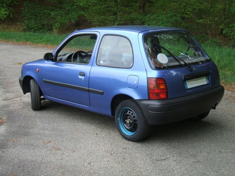

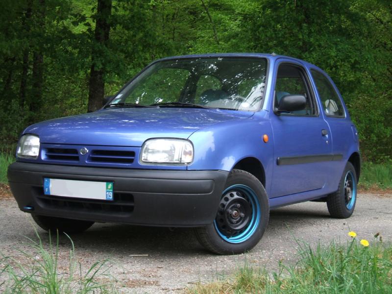

So the micra now. It's a K11 lagoon proudly powered by its CG10DE and its procession of 55hp. I bought it 2 years ago. Here is at the beginning :
But why TPPC : because Touche Pas P'tit Con ( don't touch little as***le)
I plan to do something light, fun to drive, fast in corners.

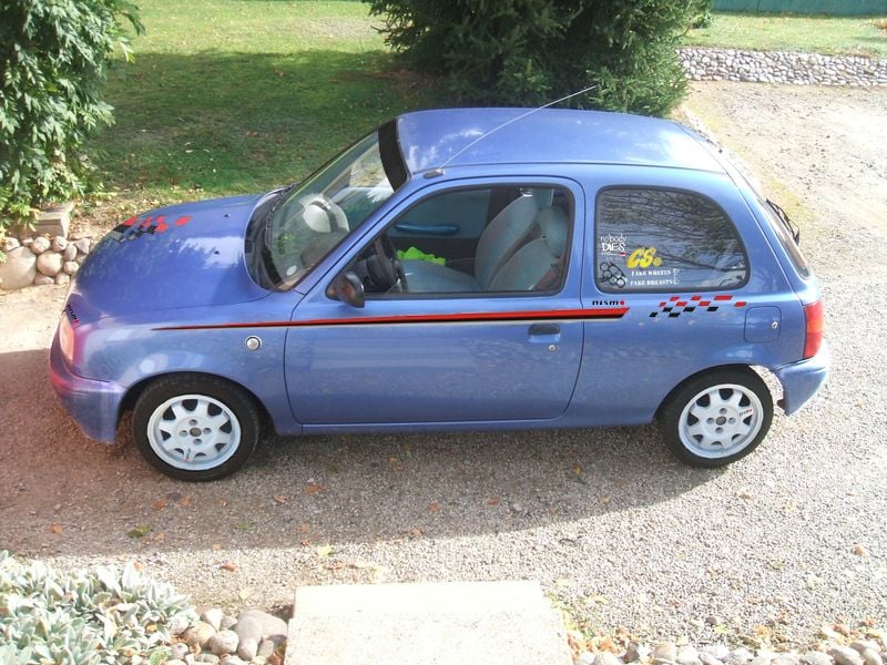

And, because I plan to do a fake Star-Cup, why I wouldn't do a Fake Nismo :
The photoshop is bad, but I like the idea.
Edit : Better like that ^^ :p thank to Wannabe, a "micra-addict" member :
