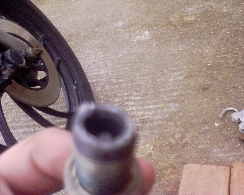

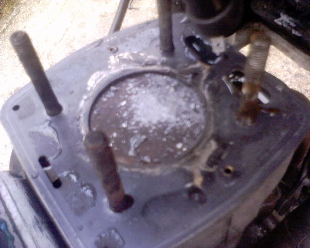

I had a bored out engine and aftermarket exhaust but the person the fitted them didn't re-jet the carb as I found out yesterday.
I was cruising along full throttle in 4th at about 9000rpm when I had a sudden loss of power, my boots were covered in oil and water. I rolled to the side of the road, checked everything out, the engine wasn't seized but there was no compression. I thought it was the headgasket but after pushing it 2.5 miles home and stripping it down I found I had melted the piston, spark plug and metal headgasket. At least it didn't seize cos that would've chucked me off and at 70mph that would not have been fun.
