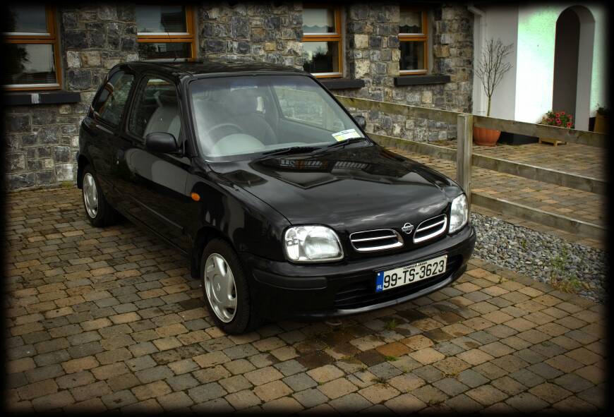

I have a '99 reg 1.0l gx 3dr which i bought just to save money as the BMW 530d i was driving was costing me a fortune to run. I gave the micra the ironic nickname "The Beast" and it kinda stuck.
Anyway i ended up loving the car which i had always hated before this and started modifying :)
Thats how she started out.

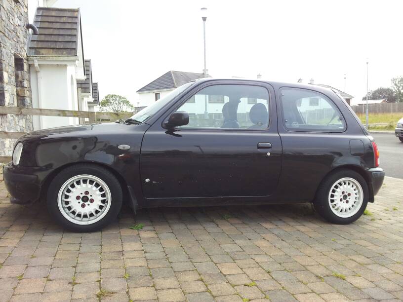

I then bought some 14"x6" et35 bmw e30 "bottlecap" wheels which had already been sandblasted got centre machined to fit the micra hubs before getting them sprayed white and fitting 185/55-14 tyres

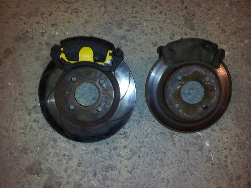

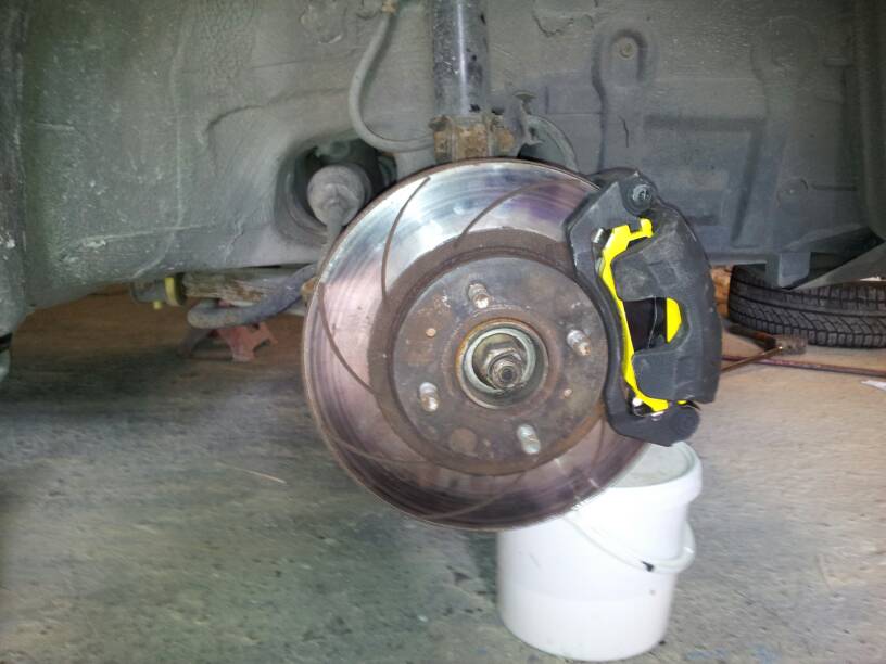

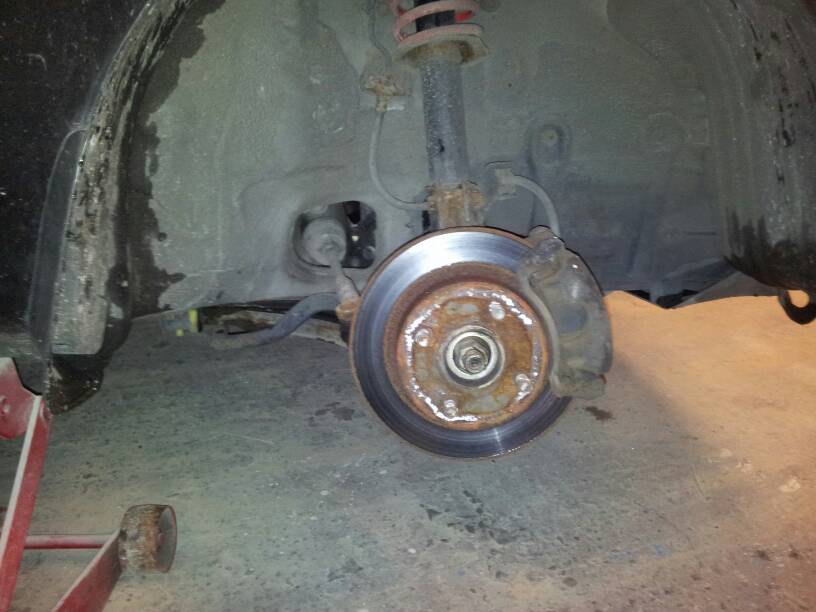

Once they were fitted i had space behind the wheels for the sunny gti-r brakes that had been sitting in the hallway for months :p
But i then decided to strip and recondition the calipers before so ordered the new seals and a set of goodridge hoses from matt.
Also ordered a set off ebc yellowstuff pads.
Before
Comparison
After

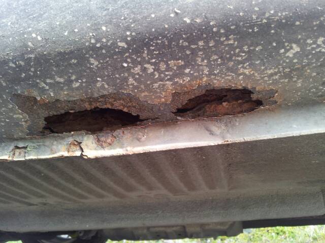

I need to get the sill replaced.

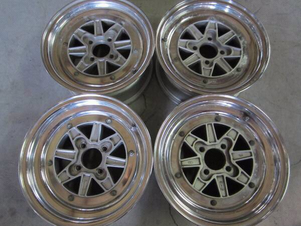

And i've ordered a new set of wheels too
Yes straight from japland staggered fitment too
14x6.5 et19 and 14x7 et12
If my measurement are right should be nice fitment
Costin me €920 delivered to my door i still need sort out sort out proper ssr nuts which will prob cost me another €100

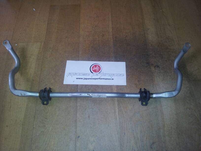

25mm Nismo front anti-roll bar

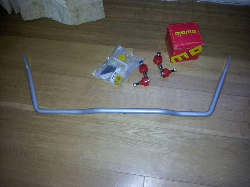

22mm Whiteline adjustable rear anti-roll bar with whitline links and steering wheel hub for the wheel i got from my brother.

How good that anti-roll bar work? Is it much more stable? Haven't seen any of those in micras at Finland. Is it on some sport models only?
i find them brilliant i have more grip than i have power to use at the moment as still haven't got hold of a 1.3 engine or internals. mine had smaller anti-roll bars as standard but i do remember reading somewhere on here that some of the lower models or older models didn't have them but i dnt know which model do or don't have them sorry. but i'm sure someone on here could tell you. :cool: Frank wud be my first try he seems to know all there is to know about k11s and a bit more too lol
