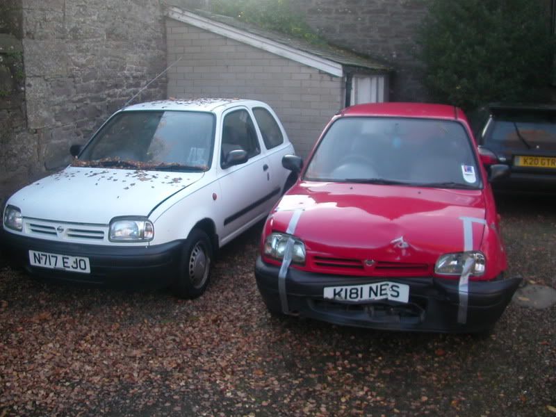

Well my sister is doing her lessons just now and i started to look for a cheap car for her.

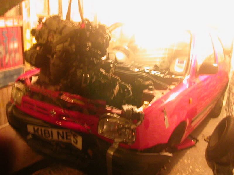

Well the security guard at work owned the white micra, which broke down outside the site a few weeks ago, its mot was just about to run out that week and he was going to scrap it anyway, i got it for £20.

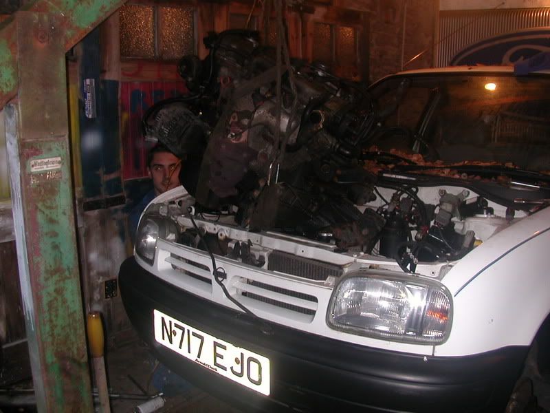

I then got the red one for its engine for £80, off this i used the engine, box, a driveshaft, a tail light, rear bumper, back seats and passenger seat.

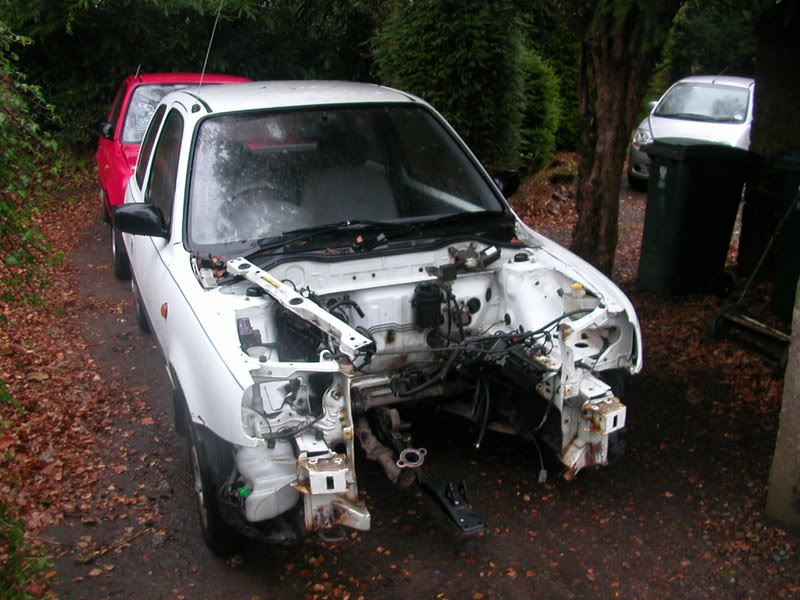

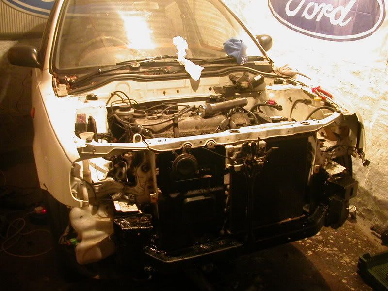

I then got a new front cross member for it £20 and got it up and running. It failed its mot on emmisions and a wheel bearing, I got the lamda from the original engine and a new wheel bearing was £20.

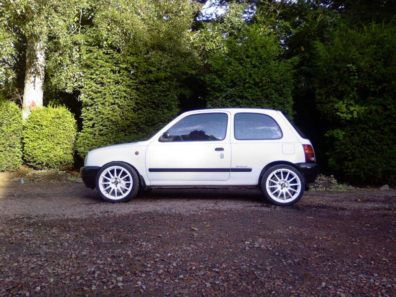

I put it in for its mot again today, which it passed, unforunatly i was charged £10 retest so the mot total was £60
So in total the car was £200 but i am getting £80 back for the red one from the scrappy so £120 For a micra with a years mot!! It could of been £100 but the wheel bearing was knackered on the red one too grr

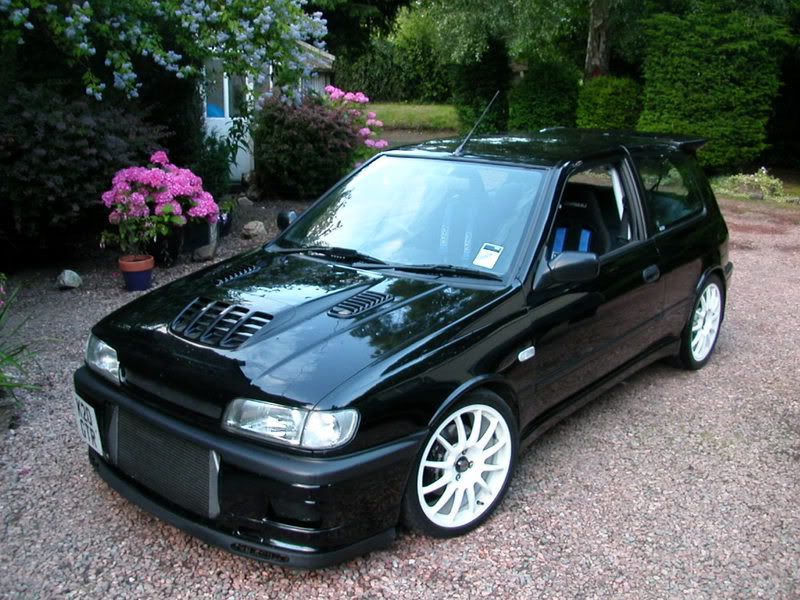

And how it would look if it wore the 17's from my pulsar :laugh: :laugh:
