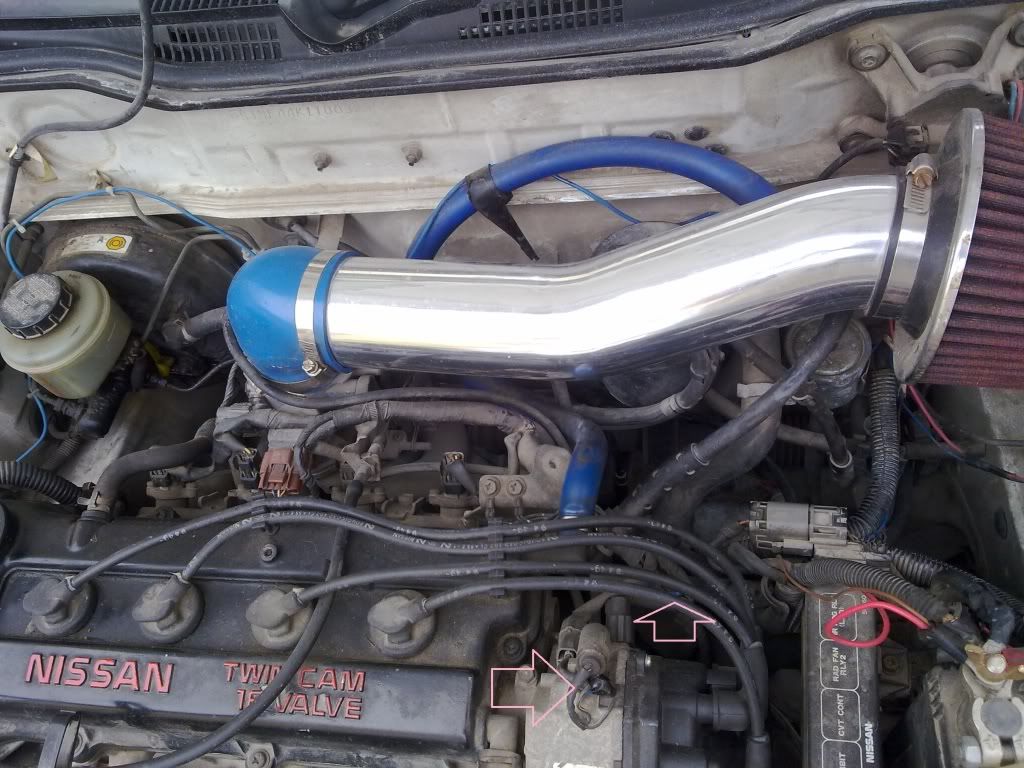

Do you think it could be so mate? interference..? it's not been touched...but naturally it's been prone to vibration lots of it... I know the pic isn't clear but you might get an idea of how the wire's running just beneath everything alone with the pipes..

didn't work for me tweaking with the wire. in fact considering this has not moved since install as it's been cable-tied up.
but still thanks for helping
