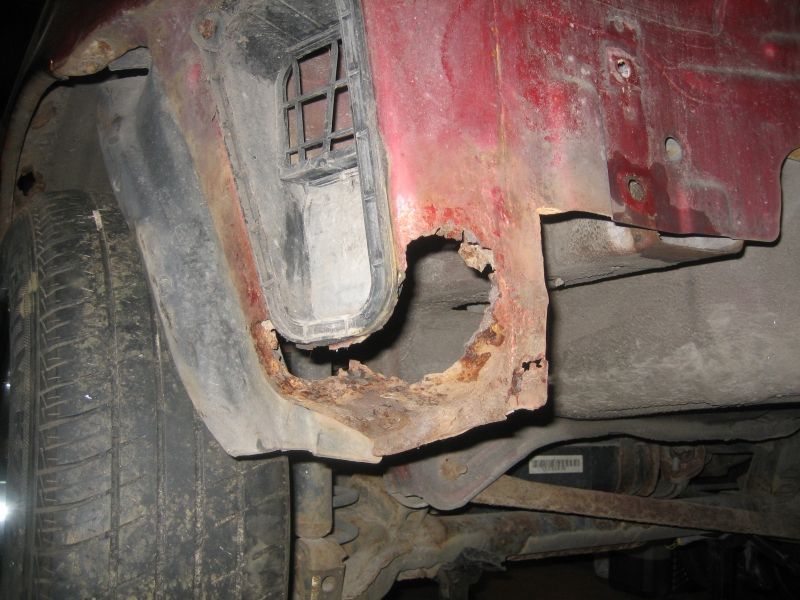

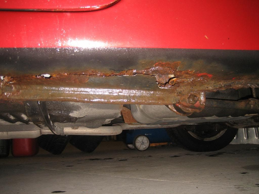

-Rust hole in front of the drivers side rear wheel

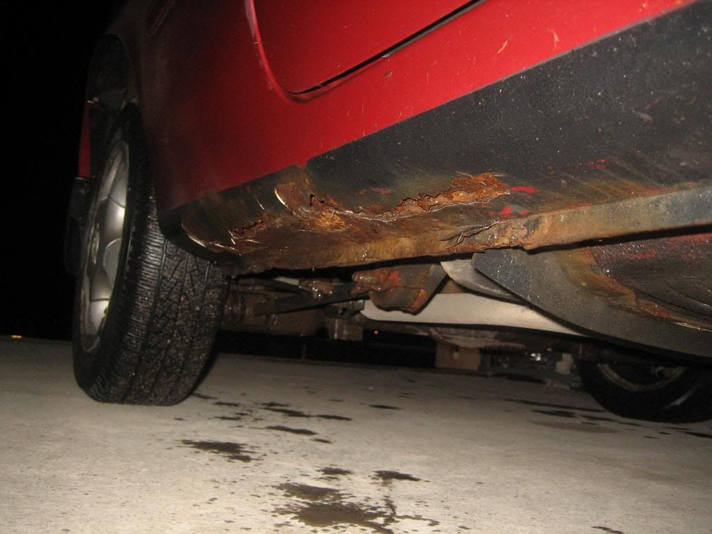

-Rust hole in drivers side sill
-Rust hole in co drivers side sill

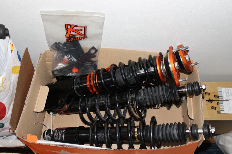

-Polo coilovers (already have these waiting in one K10)

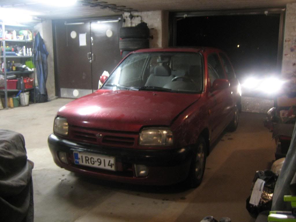

Here are some photos of it, its going to look better i promise! ;)
Luckily i had some warm garage waiting empty ,where i can do something during this winter already.

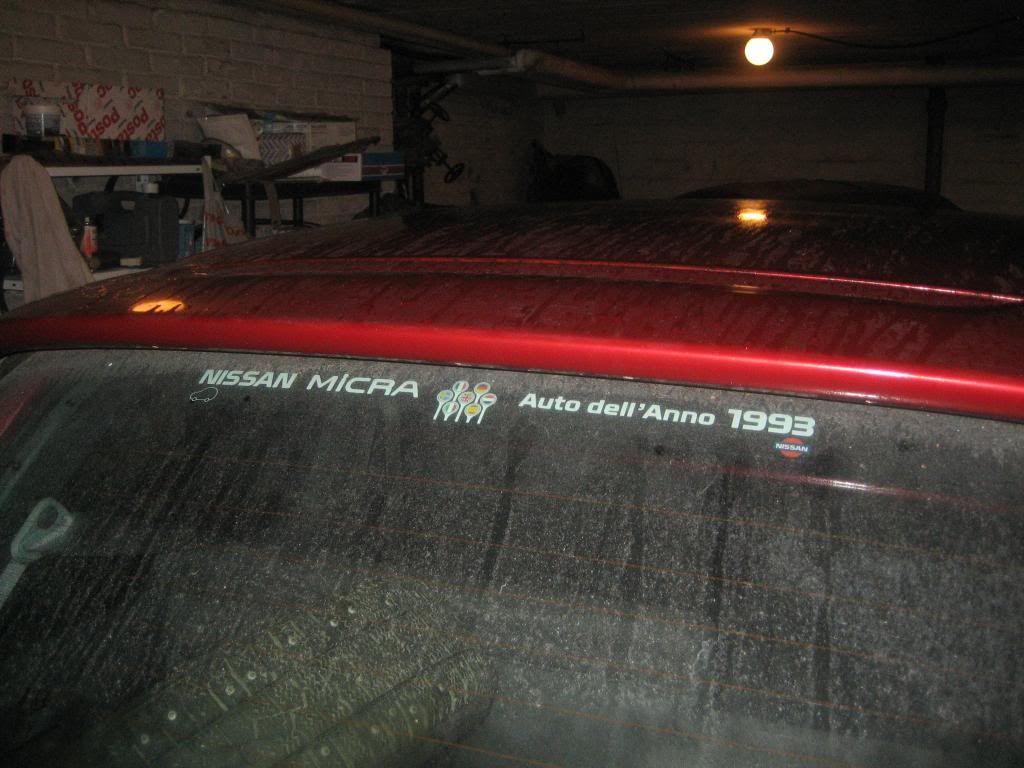

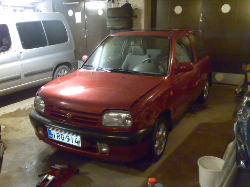

Had the time to clean up the car a bit in the weekend, took few horrible pictures with my E90 Nokia.

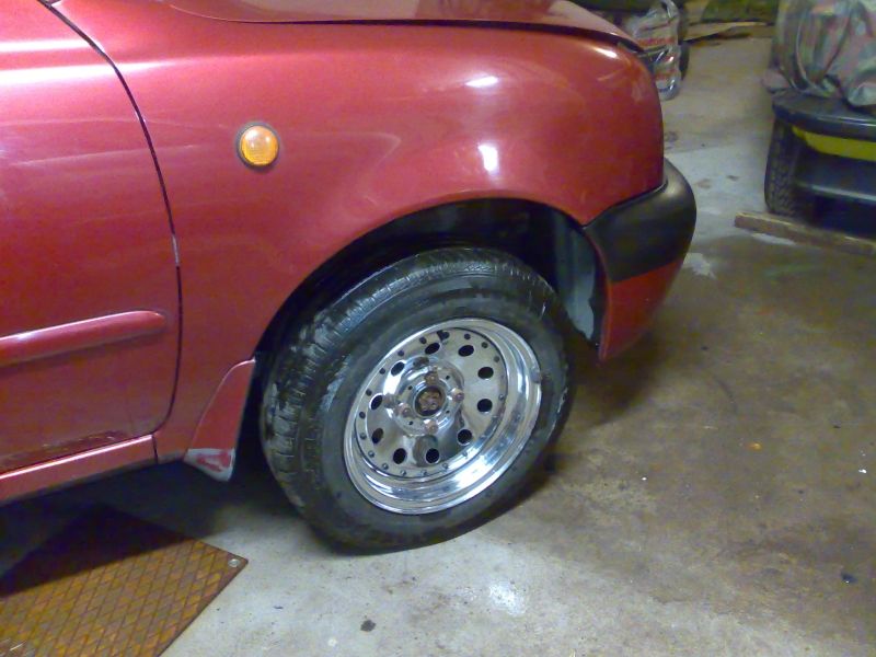

And polished+fitted the Mangels 6x13...comes right to the edge and maybe will look nice with coils ;)
I´ve been thinking of the mods list and i plan to keep it mainly in original shape inside and outside....would look awesome enough with coilovers and perfect wheels :) . Just don´t know which rims would do the trick?
13 inch maybe... JDM SSR:s etc are nice but the price is high.

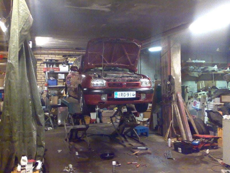

Kicked up the project yesterday, first ~3 hours spent for a good reason ;)
-Changed the trunk bonnet gas lifters
-Changed the engine oil+filter+air filter+transmission oil+plugs
-Ripped the plastic covers under the front side, more welding to do but i knew what to find in there.

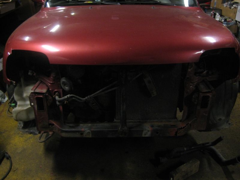

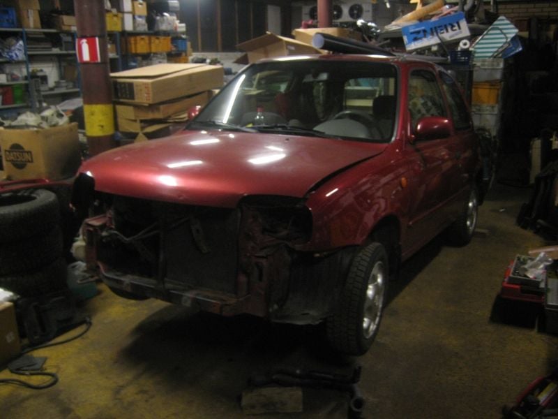

This has been progressing a bit, ripped off the front and lifted it to a proper welding position.

-K Sport coilover set

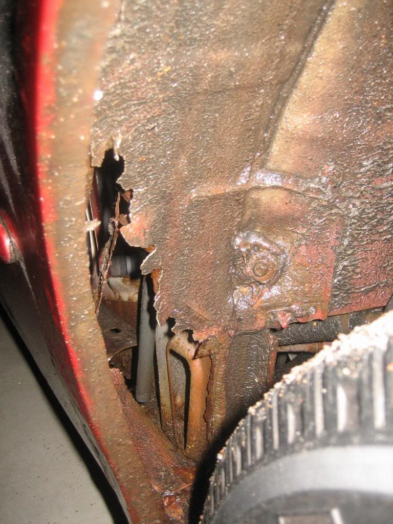

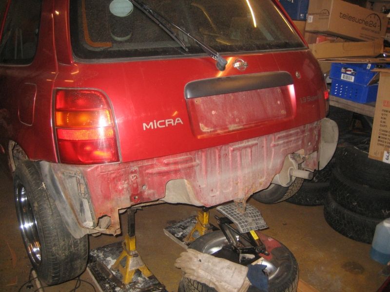

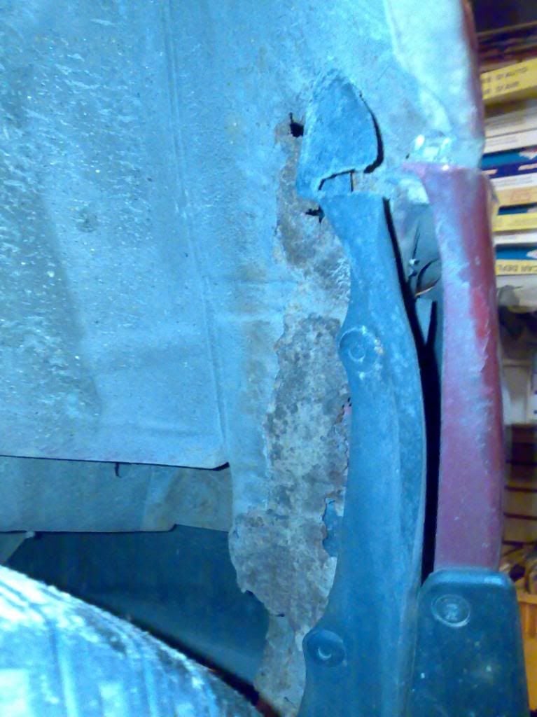

Found some more rust issues behind the drivers side rear wheel....

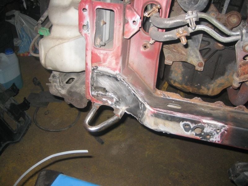

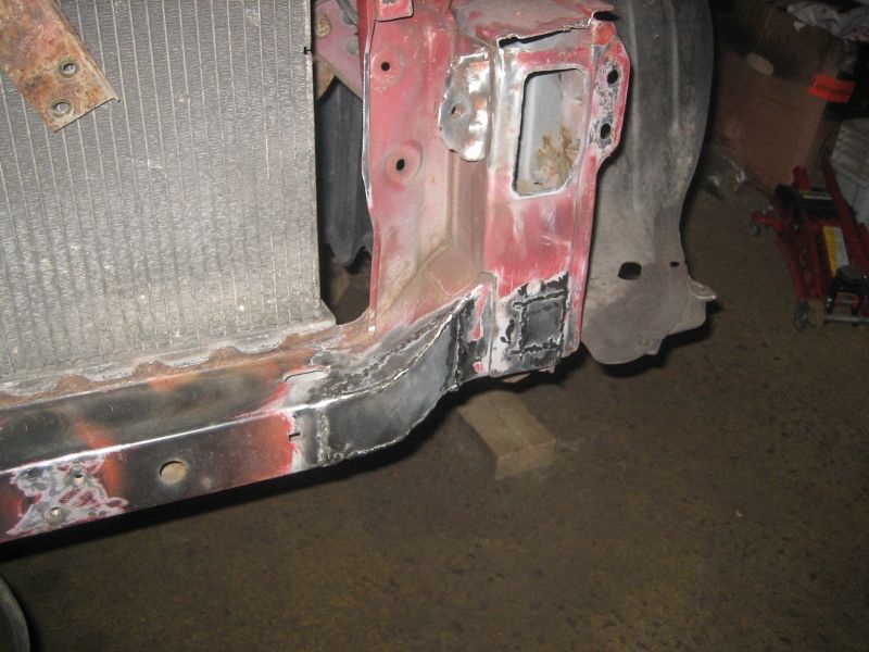

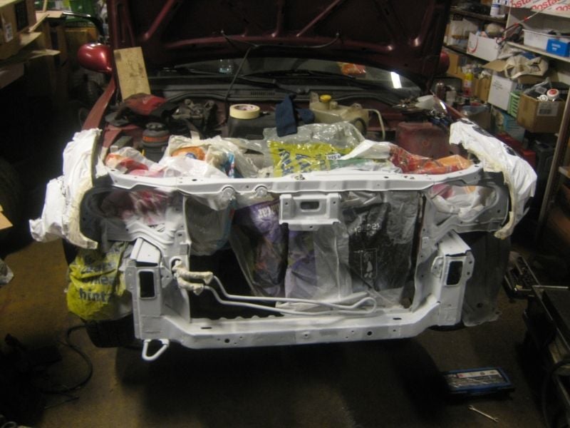

Last weekend got the front ready for good old cut&weld thingy.
Empty face she has at the moment.

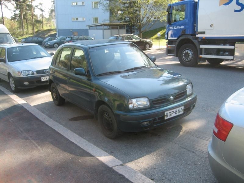

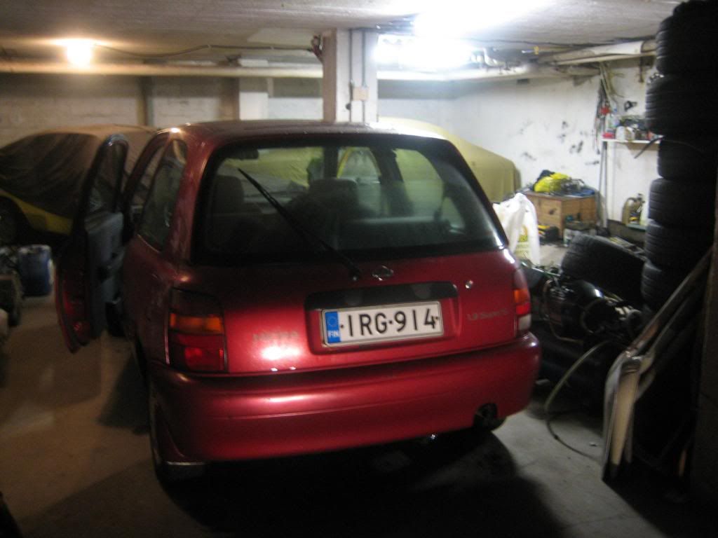

Finally some random photos of my new family transporter. Lots of repairs already done...well its not new anymore ;) . Has been eating time to do the Super S :(
Some welding result photos!!

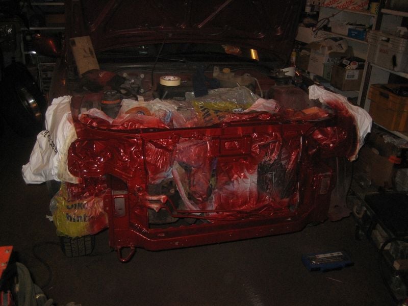

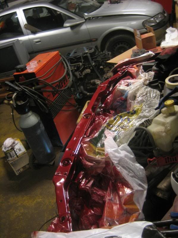

Bought the paints also today on the way home, paint code is AH3. Planning to paint the whole engine bay and the front end, original paint is faded and some corrosion here and there.

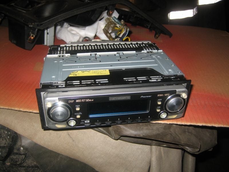

Found some decent jdm Pioneer Carozzeria DSP head unit this weekend, i think it will do the job. But getting this new head unit means also that i´ll have to upgrade the original speakers with a component set (DLS propably) and hide a amp to drive them. Starting to get out of hands once again, this project ;)

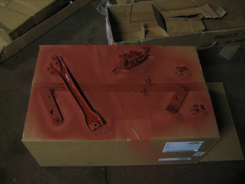

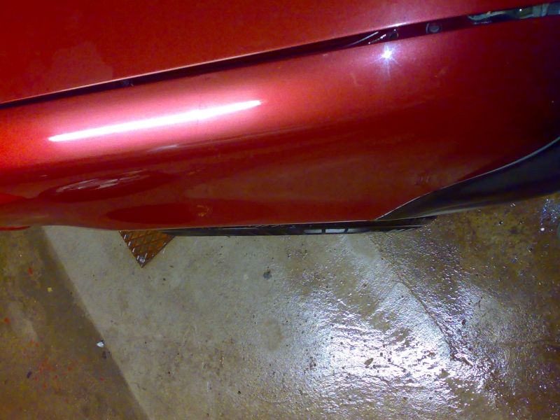

Recent jobbies...few weeks ago painted the front and base painted some smaller items too.

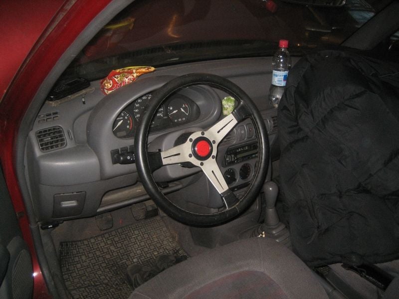

Then yesterday installed the nardi wheel just for fun, also finished the front end small bits and painted the wheel caps i finally found from Karlj :)

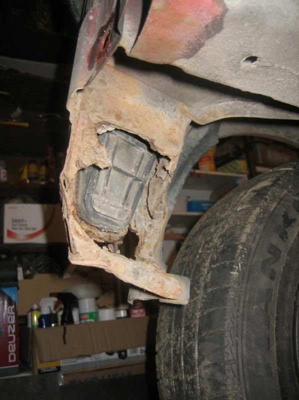

Today i planned to get started with the rear rust issues! So some cut and slice photos coming up...if all goes as planned :p

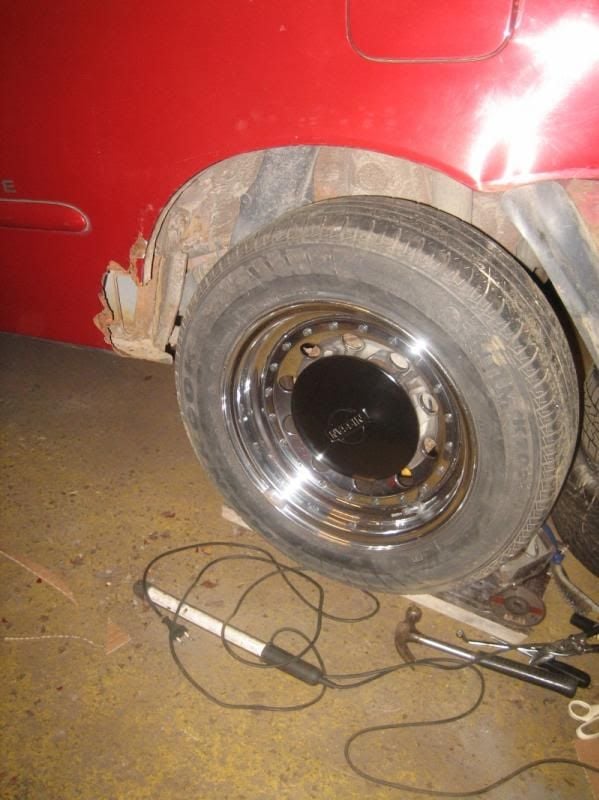

Started to do the rear, more rust found. Have to change the whole side pocket from behind the drivers side rear wheel. Now searching for a car what has some good parts for the project :p .Did go to see one yesterday but was badly rusted from the same place....so it was no point to buy it. Had 450tkm on the clock (most i´ve seen in a K11), so engine sounded bit bad too ;). Gearbox was silent, but it has been maybe changed somewhere in the way.
Some wheel fitting made again, with the original center cover. Stands a bit out from the rim, i am not sure if it looks that nice.
the wheels look like truck wheels with the caps on (almost) and i like that :)
Hmm the caps are now at this "spares" micra i got cheap....runs nice and maybe too good to be put as pieces :p .Some welding and it would get trough mot nicely.
4 doors, sooo sexy. Mystery fog lights too.
