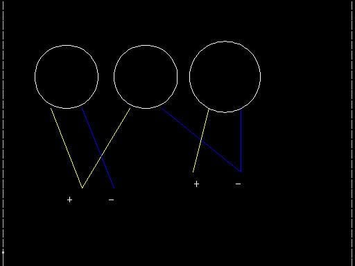

If all 3 subs are 4 ohms and my amplifier was set to bridged and speakers were wired as below what would the resistance be as far as the amplifier is concerned?
Thanks
I know about those wiring diagrams, I just can't work out this one. I guess I'll have to wire it up and see if the amp cuts out.

You are not balancing the load on the positive and negative channels, as such you will be showing 4 ohms and 2 ohms. If the protection circuit doesn't kick in and this mysteriously works then over time you will fry the amp.
As two of the subs (left and right ones) will see uneven load you will most properly burn out the coil, as one side will be receiving more power than the other side of the coil. The other sub will be fed a 2 ohm load to both sides of the coil and will most properly fry as well if it cannot take it.
Mike
id assume that both -'s are connected, so the left channel (as viewed from the pic) would see 2 ohms, and the right channel would see 4 ohms.
